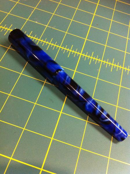

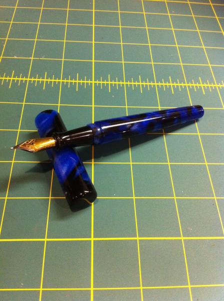

After finishing my first pen which I made from Ebonite (pictures in the advanced pen making section if you want a look) I wanted to try a different material so I used AA-05 Iridescent blue and black from Exotic blanks. It needed more care than the Ebonite but was also very nice to work with. Nib is a Jowo #6 broad with a Schmidt #5 converter. One of the things I tweaked from my first attempt was the thread sizes on the cap. I am much happier with the balance of this pen when it is posted.
Threads are as follows
Nib M7.4 x .5
Section M10 x .75
Cap M14 x .75
I also had my first attempt at a finial which I made from the same Woodcraft black acrylic I made the section. The Woodcraft acrylic gave me fits when I tried to thread it using a die but it worked well machine cutting the threads.
Since I took theses pictures I put the cap back on the mandrel and reduced the thickness by about 1/32" and I am much happier with the look. I also ordered a polished nib instead of the two tone which I think will work better.
Okay next! I think I want to try adding an accent band to the cap or maybe silver bands.

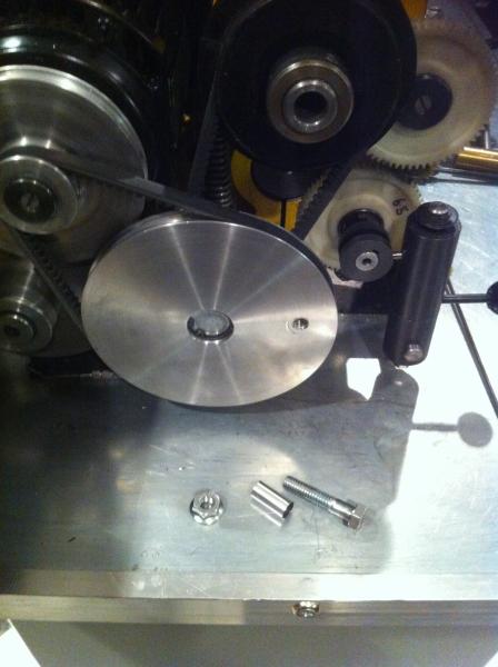

It doesn't take long really does it? Did you just turn the chuck by hand with the gearing engaged? That's what I do if it gets scary!

John, I think part of the reason I am enjoying this so much is it's in the Goldilocks zone, long enough to have me fully engaged and is just short enough to keep me there. This really is incredibly satisfying.
I started off trying to cut the threads using the power feed on the lathe but it was just too quick even at the lowest speed so I ended up drilling a hole in the large pulley and tapping it for a bolt to make it easy to turn by hand. What a difference, I feel so much more in tune with the materials now and haven't had any chipping problems. I would highly recommend anyone who is having issues persisting with learning to cut the outside threads using the lathe, after the initial learning curve it is far easier. Now a triple start thread that might be a different story!!!!
