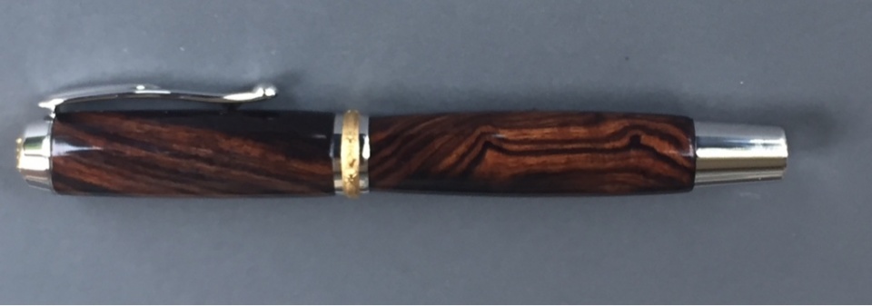

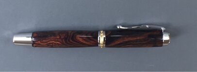

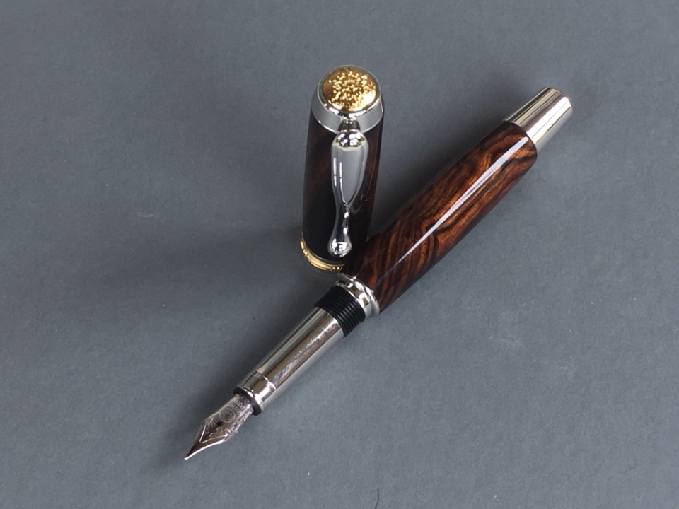

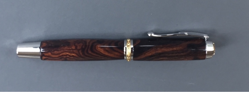

My Planned Pretty Wood Entry that was not to be.
See more from More4dan
More4dan
Mar 17, 2016
2,100
Katy, TX
I had this nicely figured Desert Ironwood I selected for the Pretty Wood contest. The body section of the pen blew apart into 3 pieces while turning. I found the pieces and glued them back together with lots of thin CA and shavings and dust in the cracks and two small missing areas. It helps that my eye sight isn't as good as it use to be, it hides the flaws a bit. Many coats of thin and medium CA, sanded and polished to the final finish. The body near the end is too large for the hardware but I didn't want to chance the blank coming apart again.
The kit is an older gen 1 Jr Statesman with 10mm and 12mm tubes, finished in Rhodium and Gold.
Danny

When I see pictures like these it only confirms that my CA finish has room for improvement. That is a beauty of a pen. Desert Ironwood is on my short list of materials to use when I finally get back up and running.
Thanks Keith. One of my favorite woods, but it sure does stink when sanding. I will use epoxy for the tube next time, the Medium CA fully covered the tube but separated from the wood when it blew apart.
Danny

That is a beautiful pen. Sorry it did not make the contest. I love a jr statesmen set. It is a classy hardware. Probably my favorite.
The others are right, that is a nice finish.
Really nice looking pen Danny. DIW is one of my favorites too.
