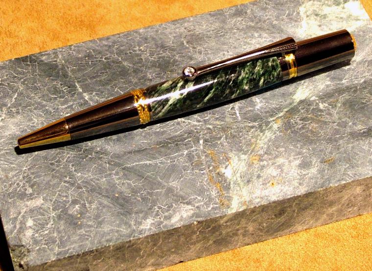

It's on the way. My camera kinda sucks.
(that's true except for the 'kinda' part.) But I got a snapshot of the pen
before I sent it off.
It is Verde Antique on a Majestic Squire. Verde is sometimes called
green marble or Connemara marble or serpentine marble. It isn't really
a marble at all, it is one of the serpentinite stones that Vermont is known
for. Doesn't look like much when you see it on the ground or in the river.
But it looks nice when you grind and polish it.

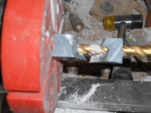

I found drilling and polishing to be an interesting experience. :rolleyes:

It looks just like the one I saw on Facebook! :tongue::smile::biggrin:
It's a beauty! Can't begin to imagine how much work it was to get that shaped to size and polished .... to say nothing about drilling a hole in it!

I enjoyed drilling the hole so much that I did it about 20 times. :biggrin:
Once I realized it wasn't going to work on the lathe, the hardest part
of grinding was the waiting. You grind until it gets too hot to hold onto,
then put it down to cool off. Every once in a while you'll hit an iron deposit
and watch it turn bright red :eek: (polishes up bright silver, though)
