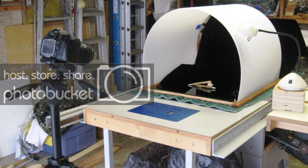

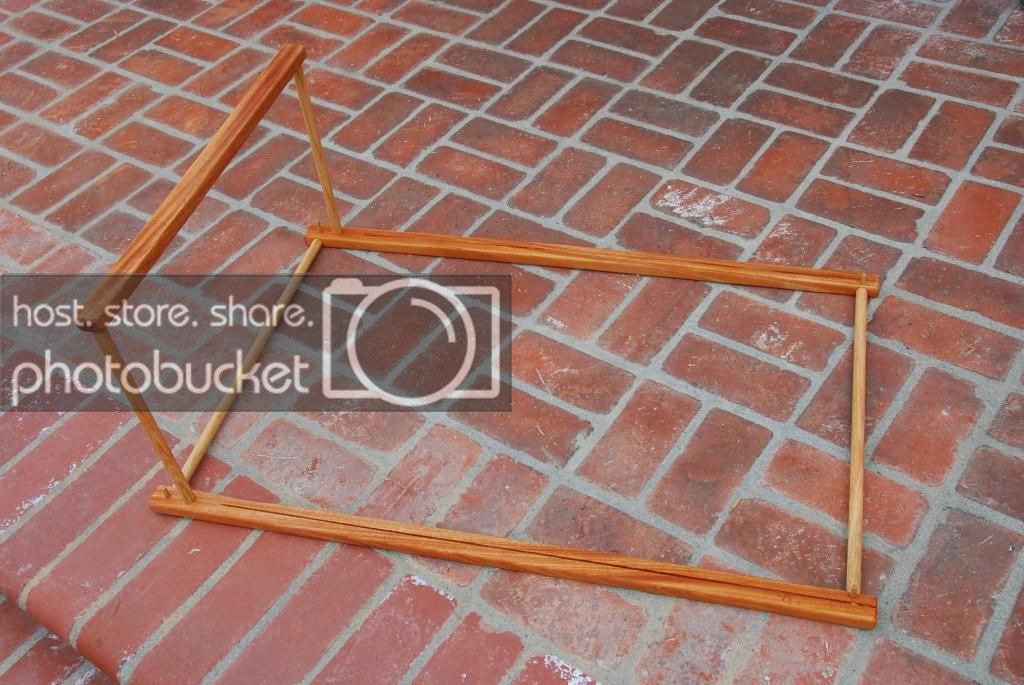

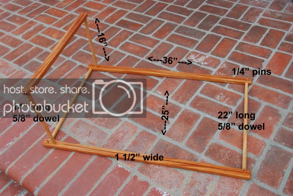

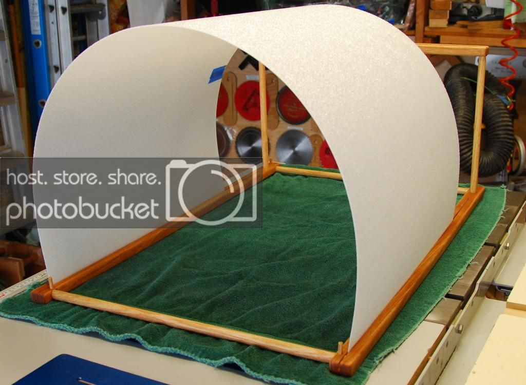

I have been using the top of my table saw until I finally made a portable frame today. Most of the materials I bought a Lowes inexpensively.
Here is the frame it is 36" x 25" and has a riser in the back to hold a black velvet cloth as a background. Other colors or white velvet would work great too.

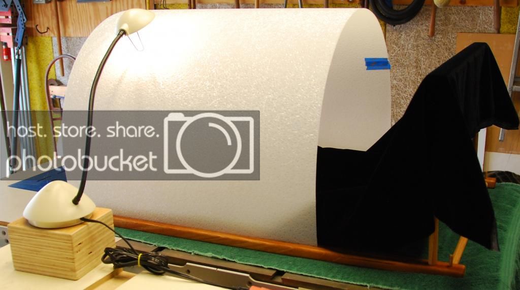

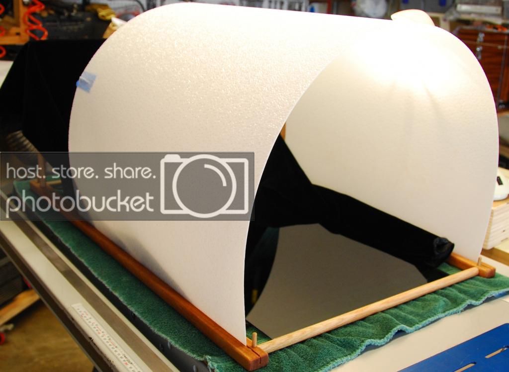

To the frame I add a piece of diffuser used in fluorescent ceiling fixtures. I think it cost around $10. It fits into kerfs cut in the side rails.
I lay a 16" x 24" piece of "black glass" inside for nice mirrored effects. The velvet is long enough to span from the front of the glass to the rider in the back.
I have a piece of velvet from JoAnn's my wife bought me with a coupon for $15. You can also see my inexpensive high intensity light I use when turning pens. This one light plus the overhead light that filters through the white diffuser from my 6 - 4' shop lights is all the light I use. If it helps I turn off the overhead lights sometimes. I do employ a white card or piece of aluminum foil when highlights are needed.
The final setup shot shows my camera and tripod. Yes, that is not cheap, but I did not buy it to photograph pens. It has a macro lens so images are usually sharp.

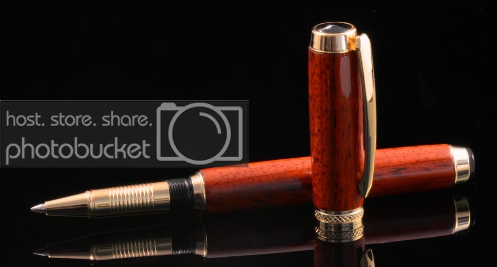

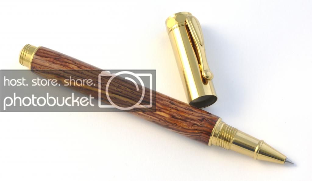

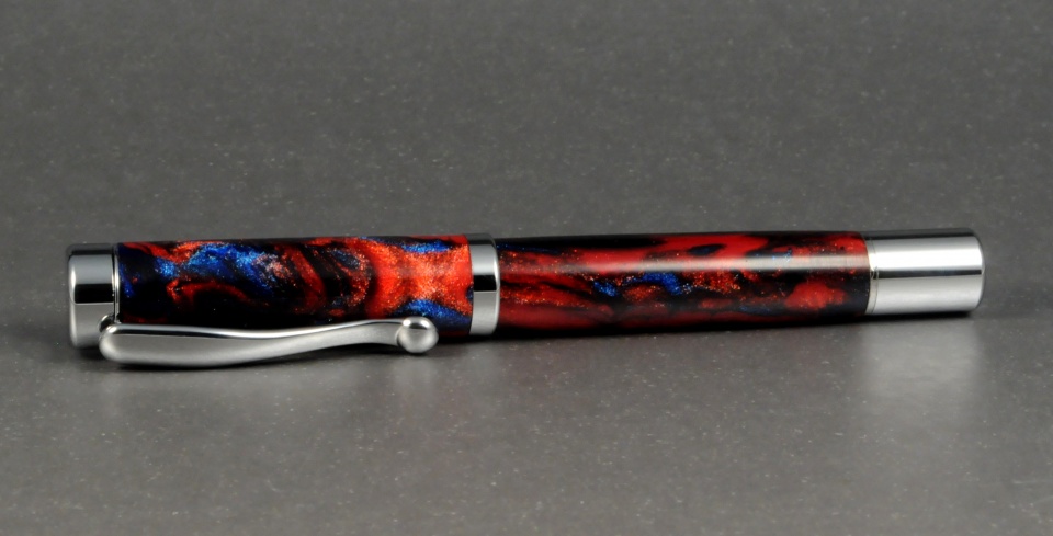

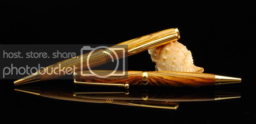

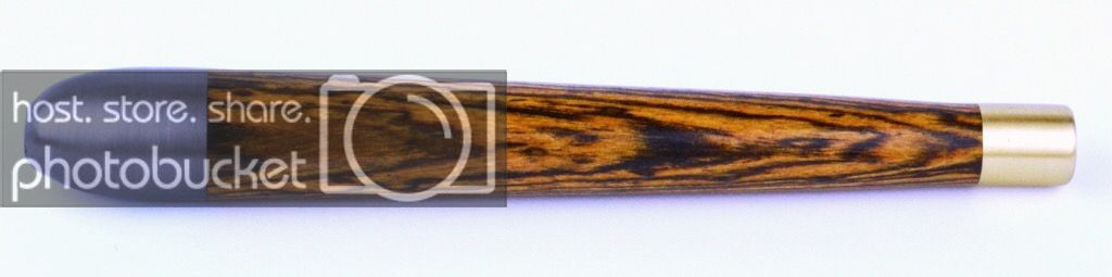

Here is a photo from my setup of two "his/hers" pens in bocote
The above image was taken with a Nikon D80 and a 105mm macro on manual exposure at f22 for 1.6 seconds.

Is the "Black Glass" that way because of the Black velvet underneath? Or did you buy some glass that is really black?
Very nice picture!!
Very nice picture!!
I was hoping to buy some obsidian-like. opaque black glass at the local glass shop and this is what they sold. It looks like a darkly tinted car window, but with dark material under it and when you shoot it at an angle is looks like what I wanted. Good news - it was not very expensive and is scratch free.

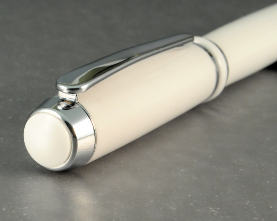

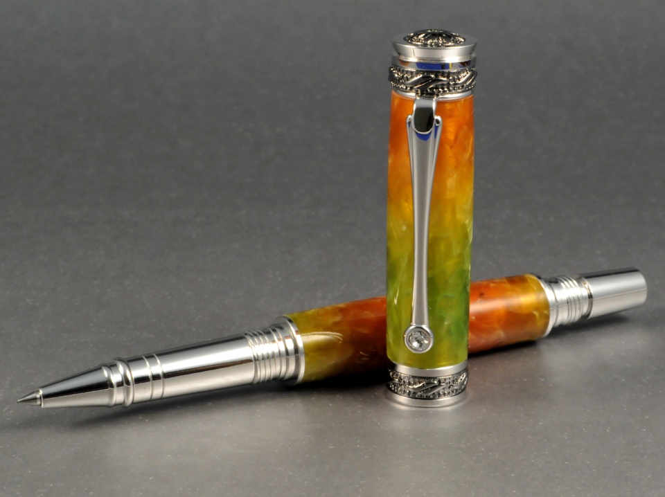

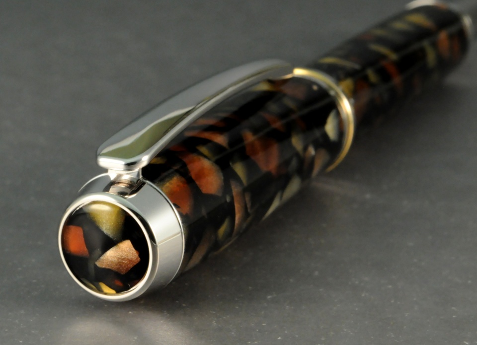

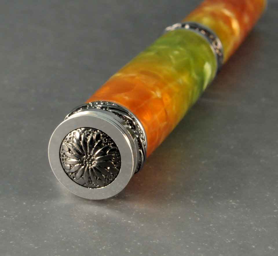

I was really intrigued by this set up....particularly after I couldn't find my store bought photo box and lights after we moved. I used left over PVC for the frame, but picked up a $10 light diffuser panel at Home Depot. At first I tried using black velvet and a piece of glass, but it just wasn't working for me. Too much dust and lent to deal with so I decided to try a piece of poster board. After some experimentation with different colors of poster board, I decided I really like the silver. It's gold on the back side if I ever decided to use that. Anyway, after trying all kinds of different ways to photograph my pens, this has been the solution that worked for me. So, THANK YOU MMAYO!!!:biggrin:
Examples below.

I like it because the stuff stores flat and the velvet gets a hangar. The entire wood setup disassembles to 3" x 36" x 3/4". Space is at a premium in my shop/two car garage filled with two cars daily.

I just cut out a frame for IAP member ladycop322 and finish goes on today. If anyone has a desire for a frame let me know. You still need the plastic sheet from Lowes and tinted glass and black velvet, but that should be easy.

Does this picture show the distance you normally take pictures? I usually get closer. But my pictures aren't as good as yours.
I also need to get some black velvet to go under my black plexiglass. I'm hoping that will let me get a true black surface. Mine is a little gray looking.

Earlier someone asked about the actual camera distance. Look at the photo of my setup taken with my iPhone and see the actual distance. I LIKE close up photography more than most so I have a 100mm macro in use for the setup. I also use a 60mm macro when needed and that would be much closer.

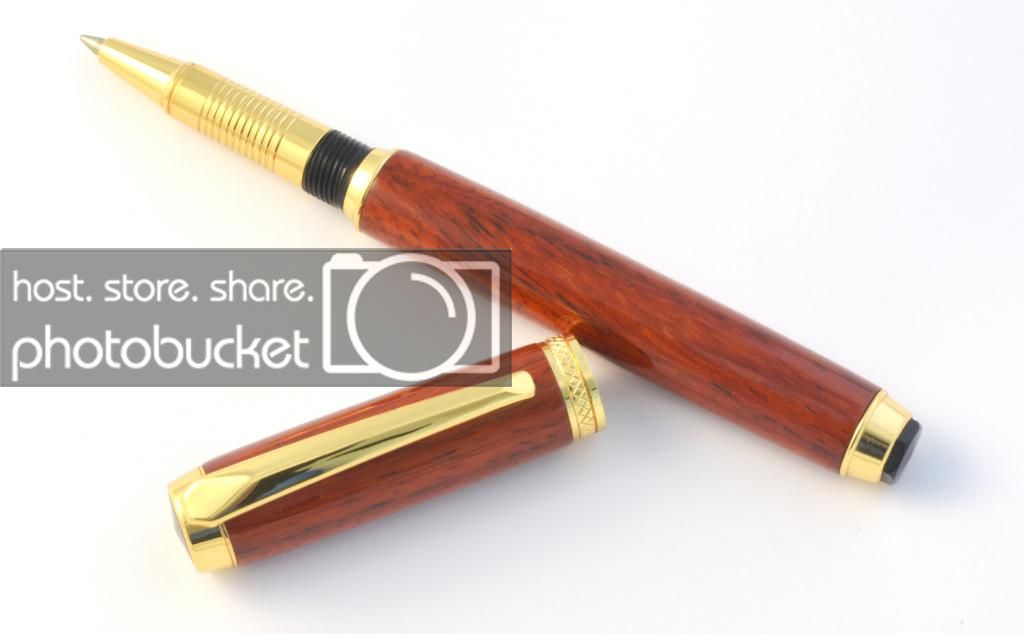

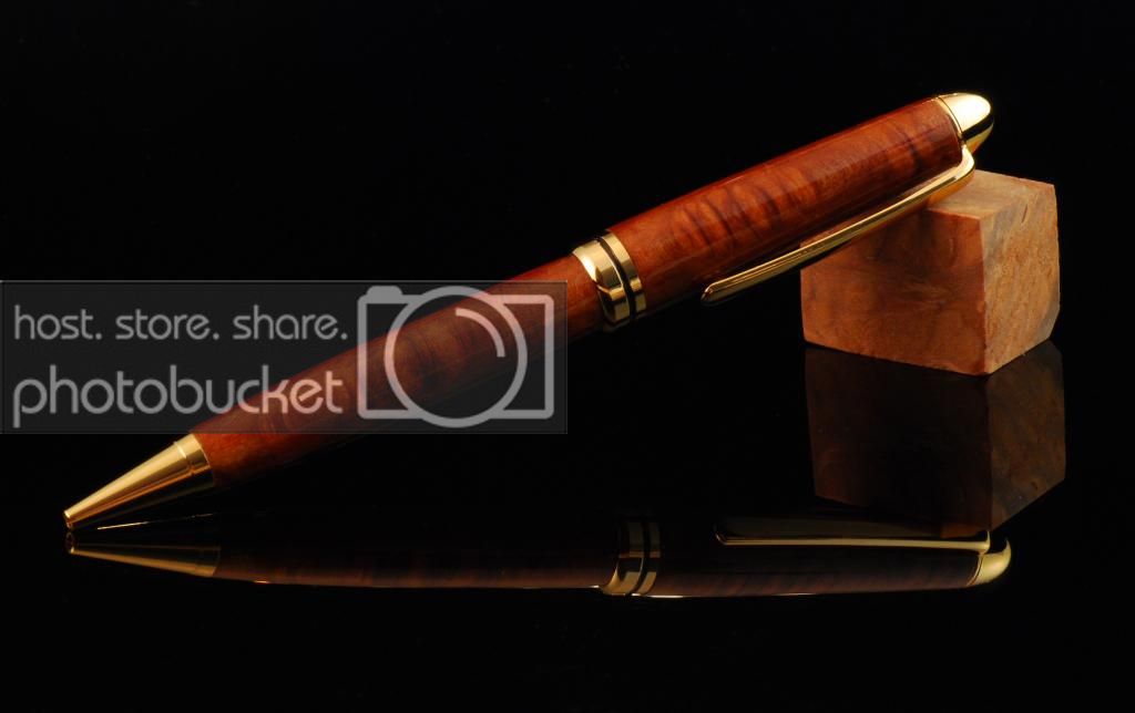

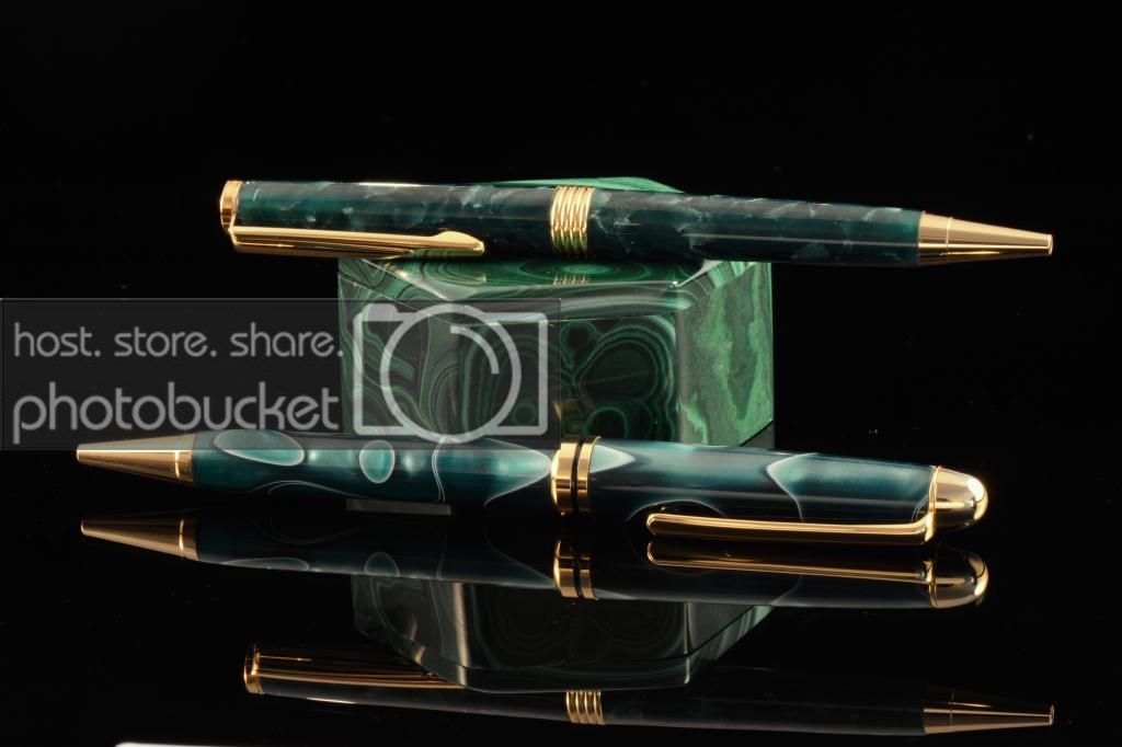

I use at least two methods for photography both employing a light tent with diffuse light. I see lots of superb photos on this site and gain inspiration each time I visit. The arched dome was might first attempt and gave this kind of image
The newer commercial light cube give this kind of result.
Each has been color corrected differently after comments on this site in Photoshop. The light cube cost me about $30, the shop made one provided more building enjoyment.
