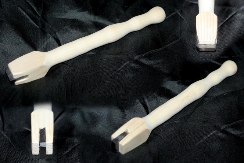

Went to a local metal tool supply outlet type store in my city yesterday and bought this carbide tip for $1.50. Came home turned a random selection of wood. Notched it on the band saw, sanded and thick ca in the cutter. Did a few test runs and worked surprising well. About 8" in length. Almost a inch across the cutter head. Has a slight angle and a small bevel on the right side. Made for some easy interesting cuts.
I know I'm going to get flack for making something like this probably. :)
Can't wait for the orders to pour in! Kidding

Looks cool. Now you just need to stain it. You will have to make sure to show it to me this weekend if I stop by. Was that a, "I am doing it because I can" type deal since you already have a nice tool? Boy, that didn't come out the way I wanted it to lol.
Being of the cautious type, and having had a catch or two, I suggest movement from the wood prototype to a stronger brass, bronze or stee arm and with the screw made to fit the insert attaching it via a tapped hole.
Inserts are pretty standardized these days with only a few sizes in the range normally used to make a wood turning type tool.
It is fun to make your own tools - from prototype to finished.
I do plan on trying to make something that looks a little more like what we see on the market now.
This was for lack of better words me messing around with what I found from this store I went to. It actually works but yes being wood I can see the potential for it cracking. Right now it is holding up. :)
Having made one myself from steel and screwed in cutter, I would worry about chatter with out it fastened securely in a solid base.
