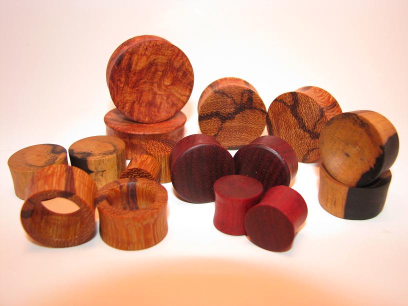

I also make plugs. Be kind as I am newer (1year) to turning. I don't blame you if you don't know what these are.... but they sell at tattoo shops all over. They go in your ears and yes, I own my own my own set :eek:

Neat idea. I'm also wondering about the finish. If you don't mind me asking, what do you get for them? I might have to give then a try. I have several shops in my area. Might see if I could trade for some ink....

We had a friend of a member of our turners club give a quick demo on making something similar to those. His was actually a small snap box, sized as gauges that fit in his ear. And while that isn't really something _I_ would turn, he getting a very nice price for a pair of them.

Thanks guys. 1st off when making plugs, you must do some serious research so as not to put bad wood types in potential clients ears. Nothing from the rosewood family ever comes out of my shop. I use Bloodwood, marblewood, ebony, gaboon ebony, amboyna burl to name a few. The list is too large. Also for a finish, You CAN NOT use anything that could go rancid, or cause chemical leaching into the body. use only Jojoba oil. Its Vegan and friendly for the body. The pic is of plugs from 7/16" up to 1 1/4" but I make them as small as 0g. Thanks for the kind remarks...always nice to get compliments from peers even if it's not your cup of tea ;)

Interesting... I've seen those in shops and said to myself "I bet I could make those...", same thing I say about anything wooden that I see. How exactly do you make them though? Mostly how do you mount something like that on the lathe?
