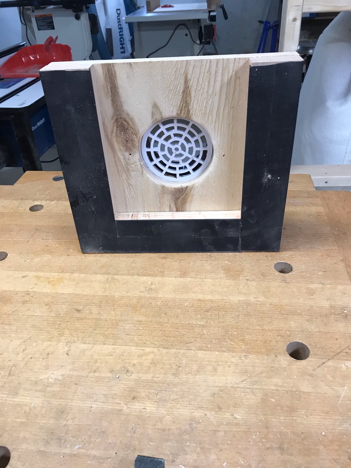

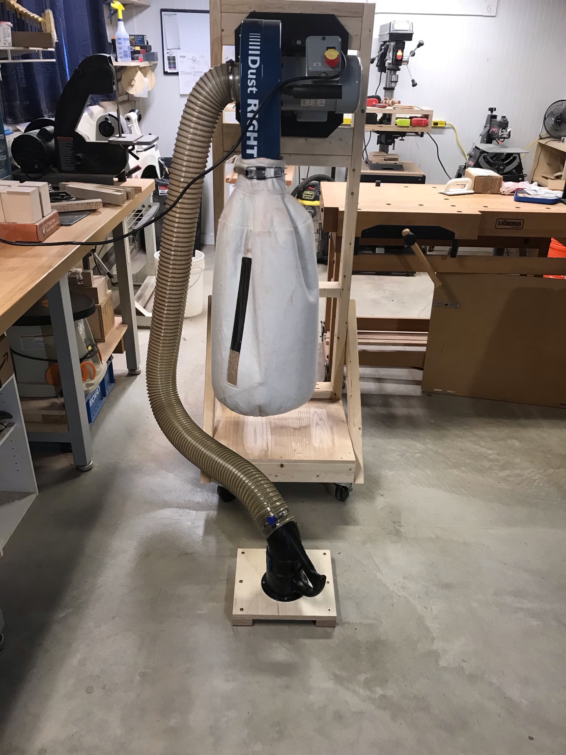

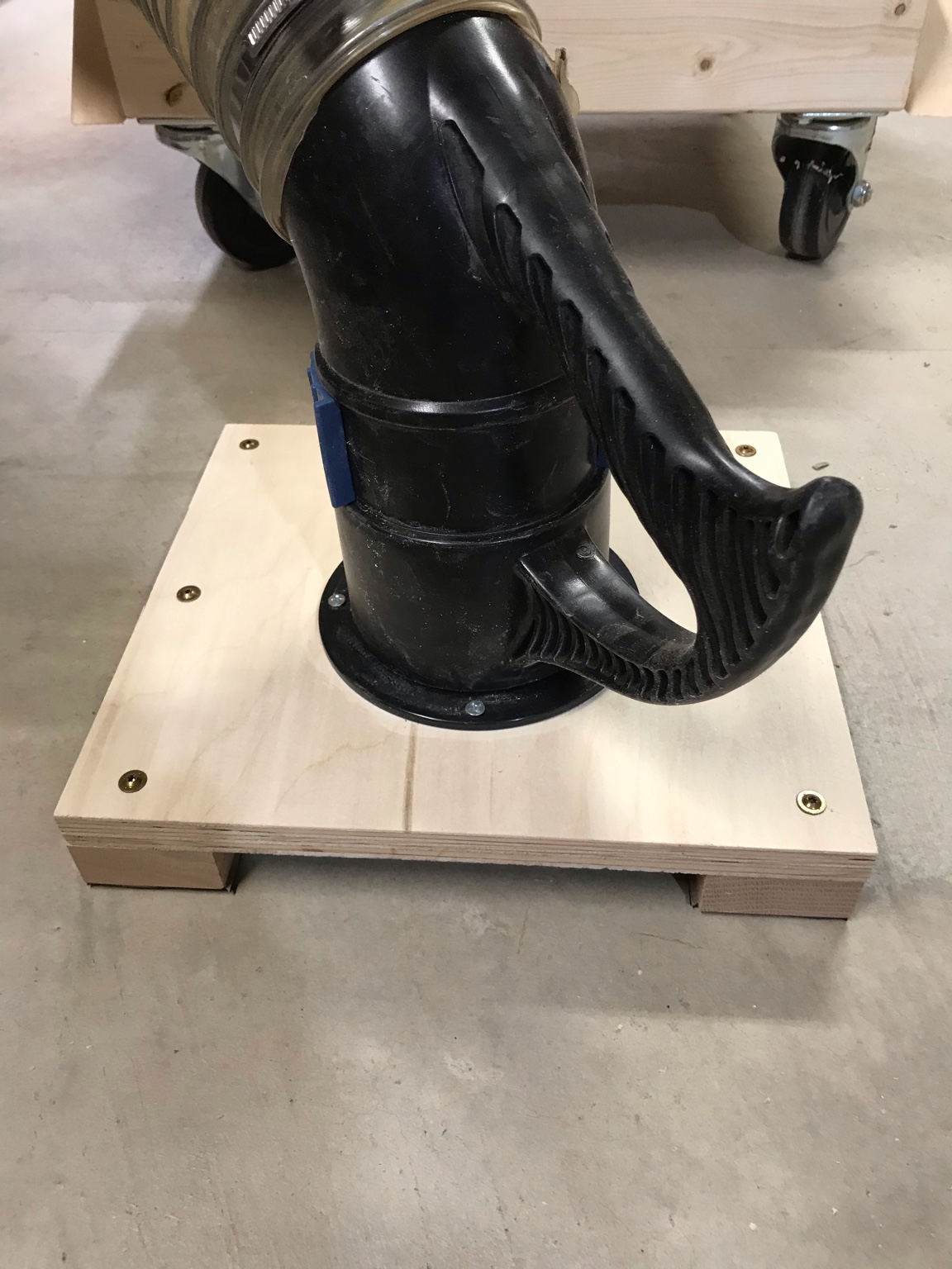

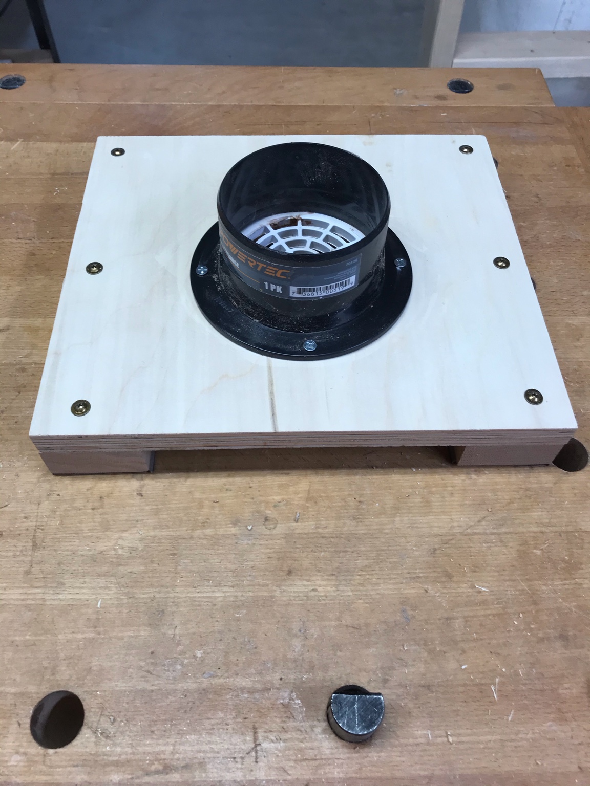

Not pretty, but oh my gosh does this work great. Just sweep the sawdust towards it and swoosh it's gone. I made it for the one dust collector I made portable.

Good idea the handle grip Ken, not seen one like that over here

What is the distance between the shop floor and the floor of the sweeper unit? Thanks for sharing.

LOL yup, see that scroll saw in the background? That's her saw [emoji16]. The gap is 1 inch. I initially thought using some 2 x 4 that I have laying around, but then thought as close as I can get it to the floor , and still be usable, the better.
