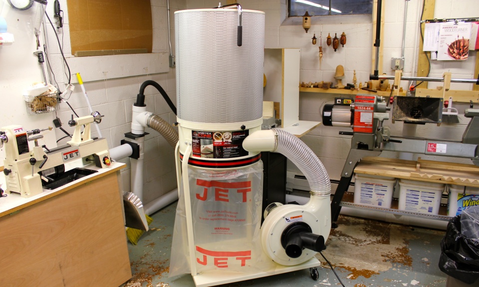

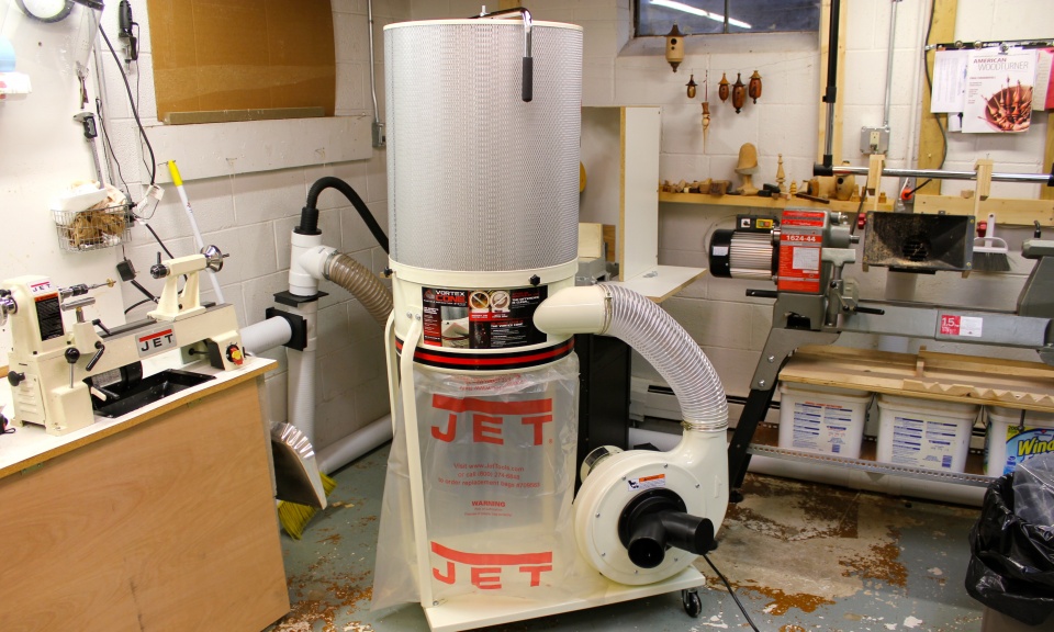

My new table saw got replaced by this monster! Safety and health over a nice "I want it..."
No complaints from me!
Dedicated ducts are are ready to be glued, blast gates are almost done...
Ordered the electrician to put in a new dedicated circuit, plus some extra tasks...
Went from 30 microns to 1-2 microns... (I'm good with that!).
Did a quick test with a self-made plug... It REALLY SUCKS!!! :smile::smile:
Sorry, Here is the Monster!!!

Hi Joe. It will go in an adjoining room! I coupled all machines and one extra port for a sweeper hose all with 4" plumbing pipe and blast gates. I tried turned it on just to test the furthest opening and it is a big improvement over my previous 30 micron unit. After it is out of the workshop, I actually have a lot of space: 14' x 19'. I will glue all the piping now and wait for the electrician to put in some dedicated lines/fuses. I can do simple electricial work, but this I want done correctly.
Chris: Yes it is loud, and the motor takes 1-2 seconds to come up to speed. Being in the next room it will be great though.

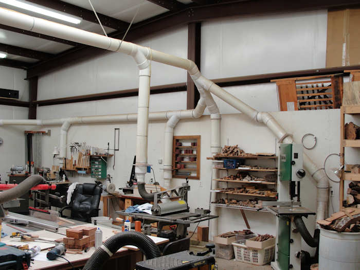

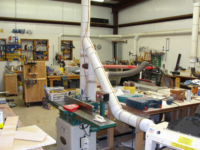

As one who has done a lot with dust collection, I recommend you DO NOT glue any of the joints. Just tapping them in tightly with a mallet is usually plenty to keep them from coming apart. This way you can easily make changes in the future without having to replace everything. If you are worried about leaks at the joints, you can always caulk outside with a cheap latex caulk. I did that on my original setup but when I redid all of my ducting a few years ago, I did not mess with it and none of my joints leak.

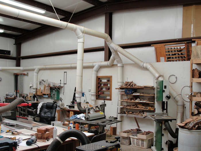

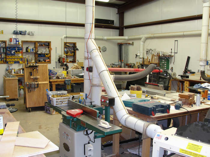

I agree with JT on the 90 degree bends. Try to avoid them at all costs. Here is a general pic of my shop with piping. Just showing to to give you some ideas. My ducting is primarily 6" with 4" drops at the machines but the ideas are all the same. Reading the link JT provided is the best suggestion.
attachment.php
attachment.php

I can only wish I had a shop that size:rolleyes: Like i said grounding is debatable at best. I realize size and volume play important rolls but my motto is always err on the side of caution and would never tell anyone to not do it. Your shop is so small it would take no effort at all to do some sort of grounding. I do not know where your located and what your humidity levels are but those are factors also. Dry air to begin with is an ingredient along with the dry materials you are drawing through there.
I was also going to suggest not gluing the joints because with PVC it is pretty tight joints to begin with and yes some caulk or duct tape will seal if need be.
One other thing to make note of because I think you mentioned it was you are putting the dust collector in another room. That is a nice feature but beware of where you put it and things to consider. ease of cleaning, noise, dust escaping from it and believe me that does happen, and also air flow. These are things you should find somewhere in that article.
Good luck and you are doing a good thing to help yourself enjoy the hobby even more so.
