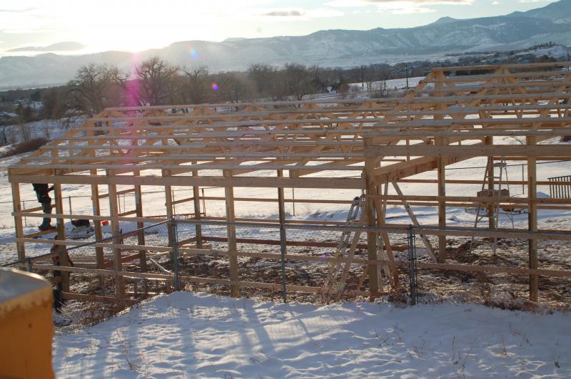

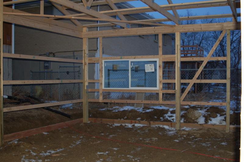

Okay, its been a while since the weather has been cold but I finally got some concrete in the ground so construction could commence. The frame is up in this picture from 12/26/09. The second picture is 2 days later and we are waiting for the inspector to stop by.

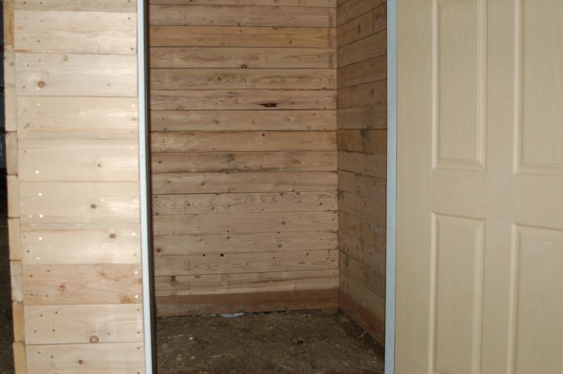

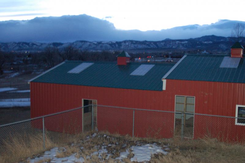

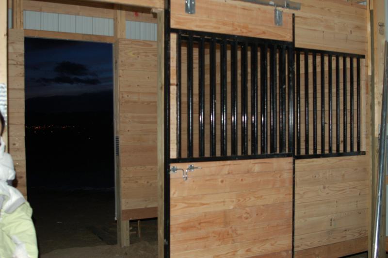

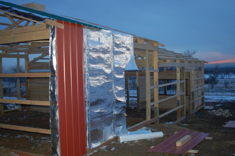

SO the inspector came and liked what he saw. Then the guys got at it and in a couple of days I had this. These are two pics of the outside of the barn, one of the horse stalls and the tack room.

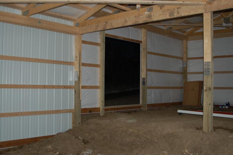

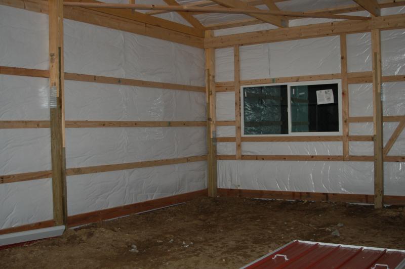

Here is the shop area, 24x20 (After and Before picture)
The last picture is where the wall between the shop and the barn will go. There is a two foot step between the two levels and no direct access.

Looks like it will be awesome!! I must say though i am jealous of your view of the mountains from your back yard!
Part of the reason we bought the place is that it sits on a hill located north-west of downtown. There is open space behind us that will never be built on. (That was part of the conditions the lady owned made when she donated it to the city of Arvada.) We can see all of Denver from the mountains in the picture all the way around to DIA. On a clear day we can even see Pikes Peak. July 4th is knda fun 'cause we cann we all the fireworks displays at once!

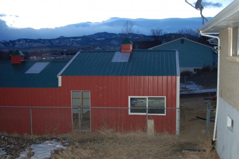

Well, its been a while but progress has been made! Here are a couple of pictures of the outside and the area that will become the shop. I have to build a wall where the hay is and then start wiring everything up. More pics as things progress. (These things always take longer when you have to do most of the work yourself. But I LOVE the bragging rights!)

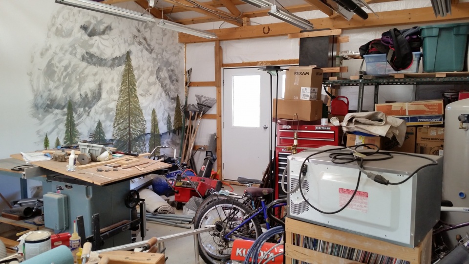

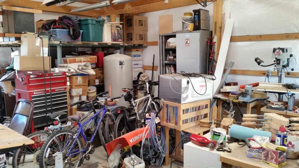

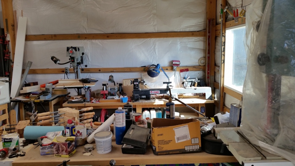

Long over due update. I actually made a lot of progress with the shop before fate intervened and forced my hand. Instead of posting pictures of a nice spacious shop, I am posting these. There is just enough room in front of the lathe to turn some pens.
What, you may reasonably ask, could result in such an over stuffed shop. Stay tuned.
I'll upload pictures later.
Here are the pictures of the state of my shop.

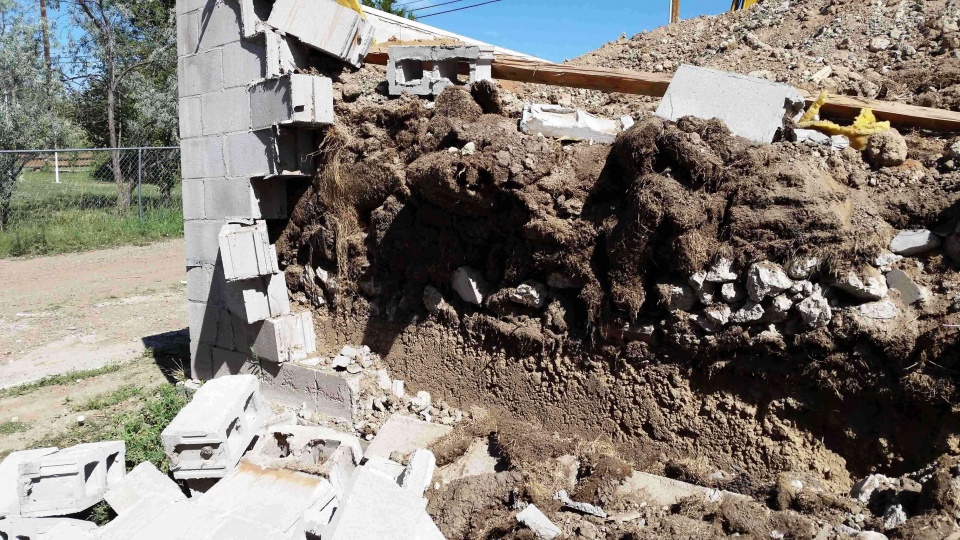

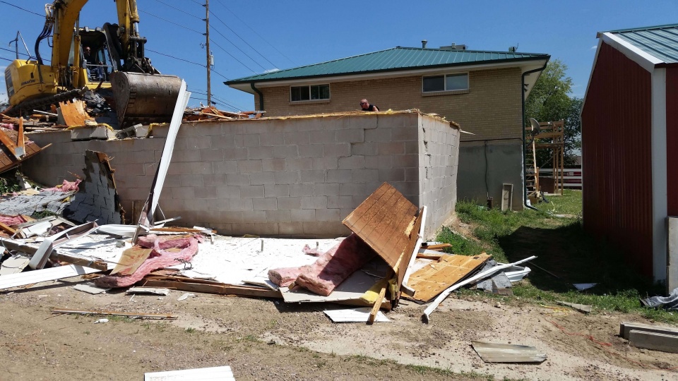

So, what turned my shop into storage? A failed garage foundation. The first picture shows the foundation walls and the major cracking in them. The wall facing the camera and the back wall were both pushed out at the top. The top of the wall facing the camera was 8" out over the toe of the wall. The top of the back wall was about 10" out. Those are cinder blocks so if count the rows and do the math, the walls were only 80" tall. 10" in 80"! Kinda scary. So it had to come down.
The second picture shows you how to guarantee the structural failure of a foundation wall. First, build it out of cinder block. Second, grout only the corners but leave the rest of the spaces open. Third, back fill with any garbage "dirt" you can find. It is my understanding that the foundation failed while it was being back-filled. They just kept filling and presto, unusable garage. We knew this when we bought the house. What we didn't know was how much it would cost to replace it.

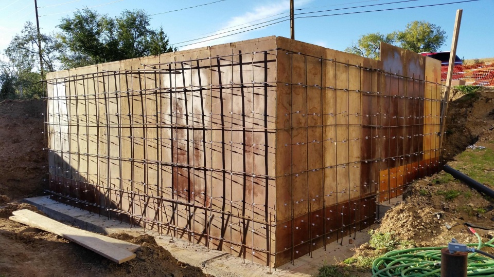

Basically, my 24x24 garage will cost about 2.5 times what my 24x50 barn/shop building cost. Okay, that is a little misleading as there are some significant differences between the two structures. The barn/shop is a basic pole barn construction with a concrete floor in the shop.
The garage will feature a walk-out basement. The slop of our property requires that a full foundation be put it in. Given what it costs to move dirt these days, the cost of a structural floor is only marginally more expensive that hauling in the required back fill to fill in the foundation. Plus, I don't have to build the foundation to retain the fill. And, as you can tell from the last set of pictures, I need the storage space. (A wife and two daughters can really generate a need for storage!)

hey.. that almost looks like it might end of structurally sound. :) Hope you get it poured before the weather turns bad
Scheduled for this Wednesday. If the weather people are correct, I should be good. Providing the weather holds, I should have a new garage by early November which is well before the weather gets really bad. I hope.
