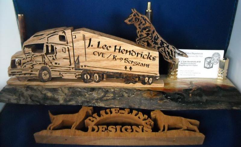

My New Scrolled Deskplate
See more from KiltedGunn
KiltedGunn
Local Chapter Leader
Jan 8, 2009
295
Baytown, TX

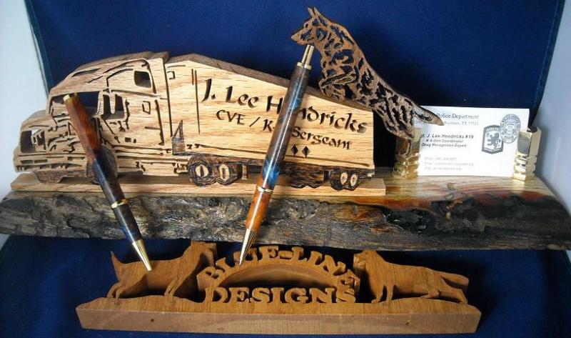

and, oh yeah, some pens to go on it! :biggrin:
I've been working on this for quite some time...its the first thing I've really done for Me since I started woodworking years ago, so of course it was on the backburner most of the time! :rolleyes:
The pen/pencil set are PSIs Longwood kit, which I like but I highly suggest reading the directions on, because they're wierd! Curtis' worthless wood blanks, matching but reversed, with 6 coats BLO/CA and wet MM'd to 12000.
The truck is red oak and the base is live-edged spalted hackberry, both MM'd to 12000 and finished with tru-oil. The dog jumping over the back of the truck is black walnut, also finished in tru-oil and MM'd to 3200 (it started breakin on me so I stopped! :eek:).
It oughta start a conversation or three when folks go thru my office! :cool:
Comments welcome, thanks for lookin and for letting me share! Lee

Nice scrollwork
Nice work with the scrollsaw and the pens look great.
I also like the longwood pen both with and w/o the finger grip.
I make one slight modification to the blank, I make is about 1/16" longer than the directions. Made a few and had an assembly problem where the top would not go all the way to the center ring, added lenght solved the problem.
I also know what you mean about a project for "you" getting on the back burner.
Keep up the good work.
bitshird
Aug 27, 2007
10,236
Adamsville, TN, USA.
Nice Scroll work, good looking desk plate, the pens are also quite nice, I know how to put blades in my scrollsaw, and I even know how to turn it on, but that's as far as it goes! Great work Lee.
Rollerbob
Apr 26, 2009
1,601
Athens, Texas
I thought you used your scrollsaw to vibrate out the bubbles in PR.:biggrin: You mean the thing has a blade on it?:confused::redface: Nice scroll work, Lee!!:wink:
