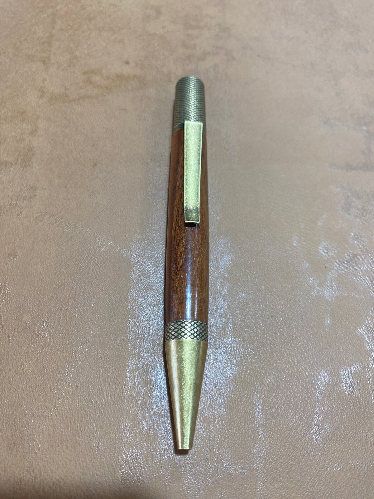

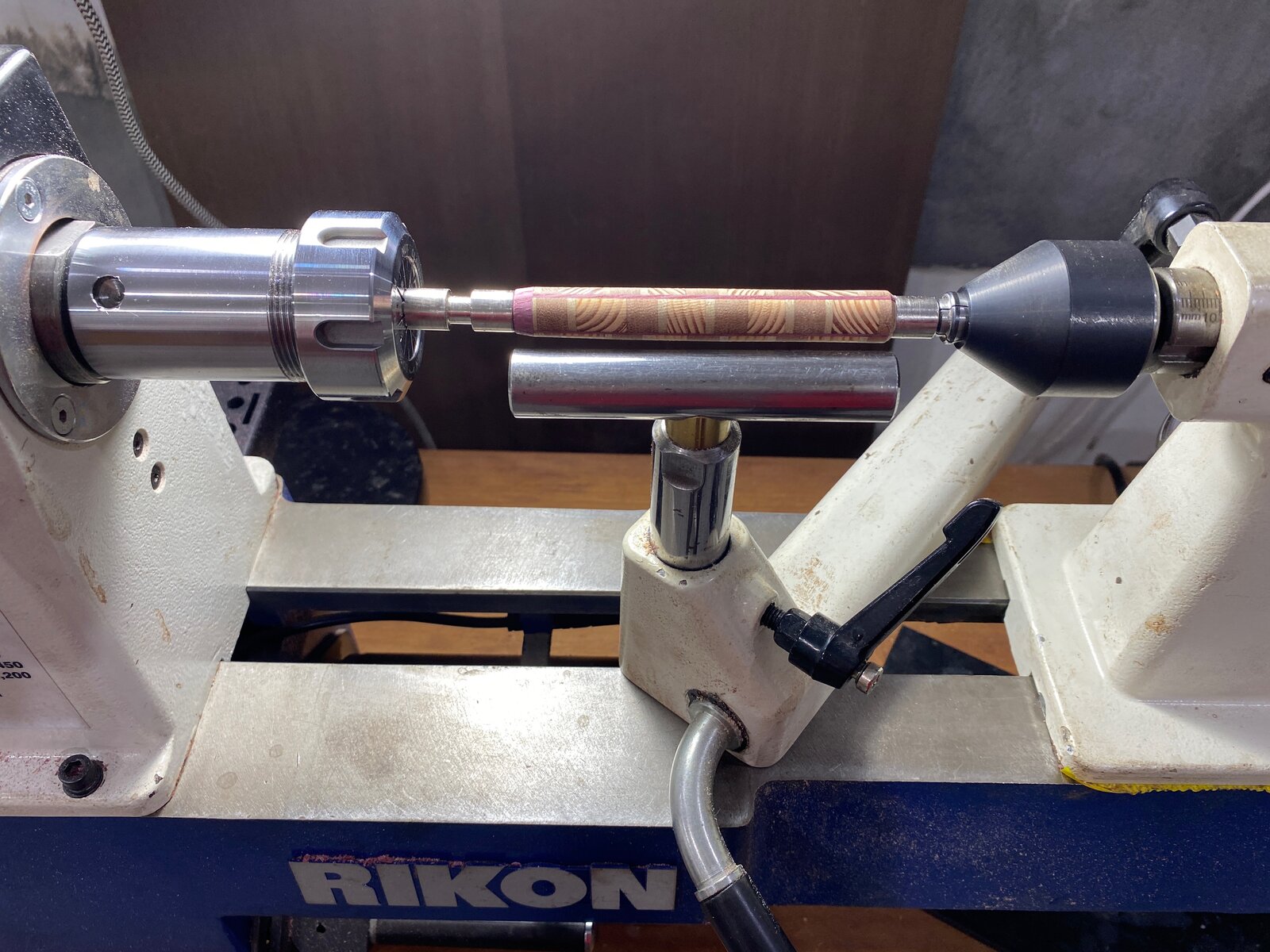

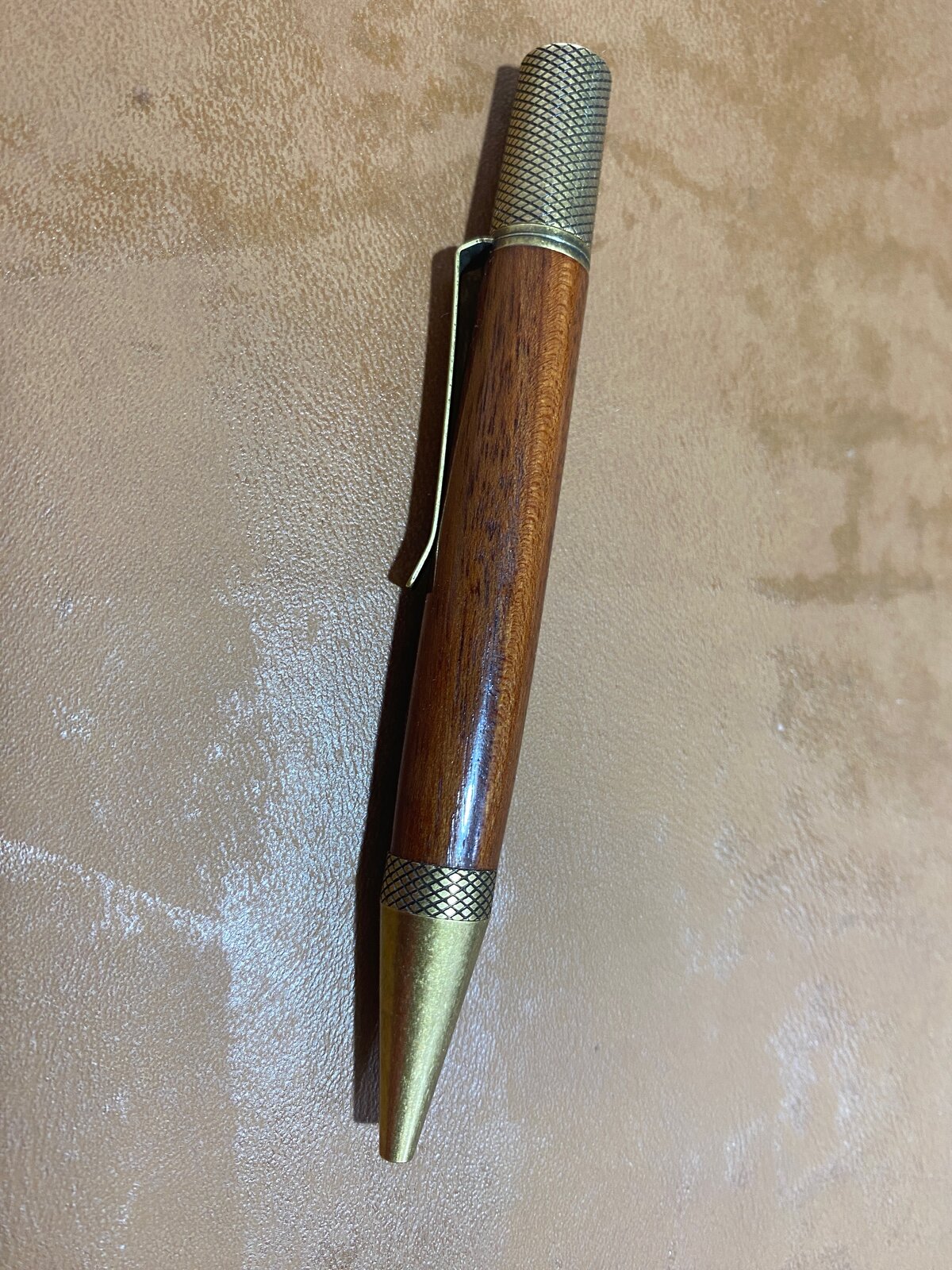

Hello, I'm relatively new to pen making and recently started working with the Axminster compressor pen mandrel. I find it to be a good value, but it only works with the0.242" shaft. Most of the time, it provides very acceptable concentricity.
After purchasing the Beall Collet chuck, I wondered how it would work in conjunction with a pen saver. After some research, I liked the Hold Fast pen saver that works with a collet and comes with the 2 shafts diameter (0.242" and I.246")so I decided to buy it and give it a try. I was very nervous until I tried my first pen, and I couldn't be happier with the results. The concentricity is perfect, and the setup feels more stable, leading to a better overall experience—though maybe that's just me justifying the investment!
Now, I try not to sand and instead finish with my skew, especially when working with segmented wood, to avoid mixing the wood colors. I currently use a Crown 3/4" HSS skew, and now I'm thinking about investing in the Carter & Son skew. I've read amazing things about it, and I wonder if it could further improve the turning experience.

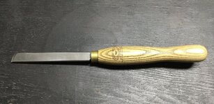

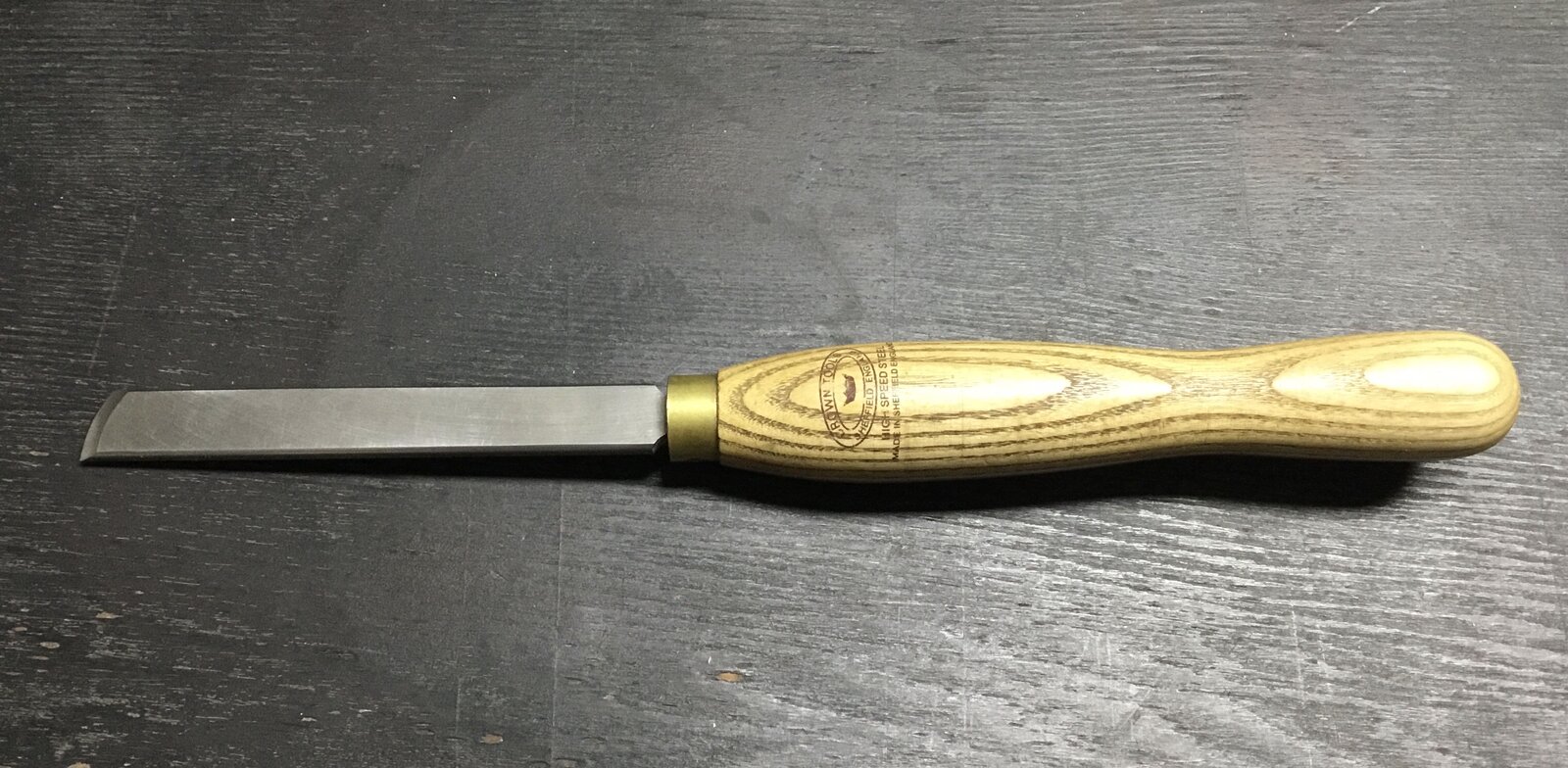

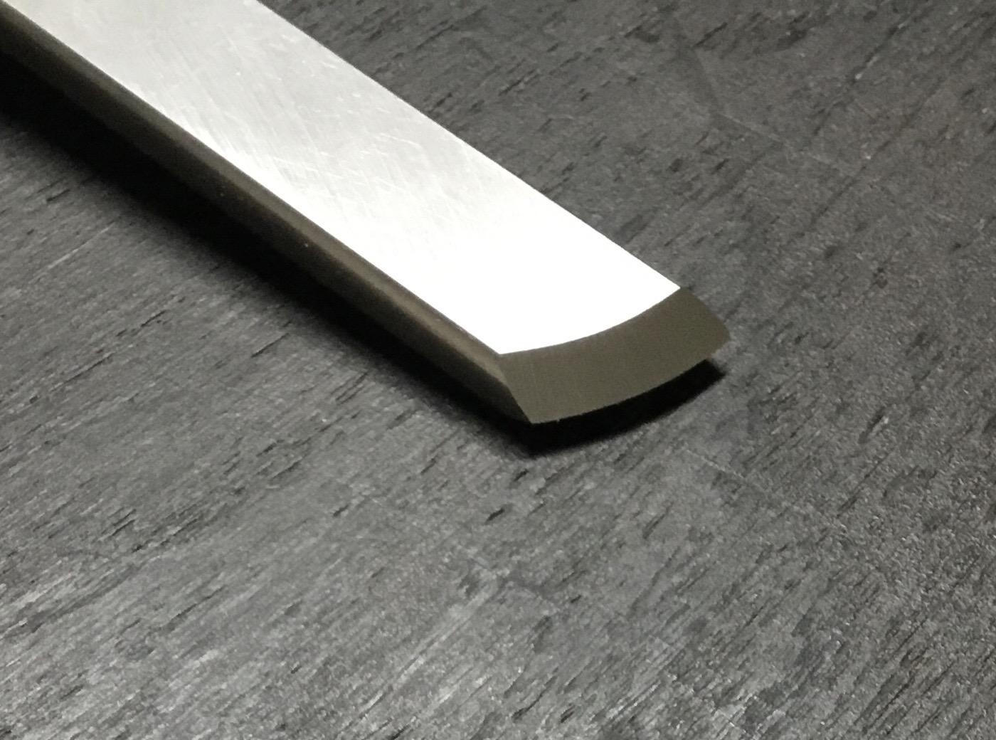

Here is picture of my skew chisel
