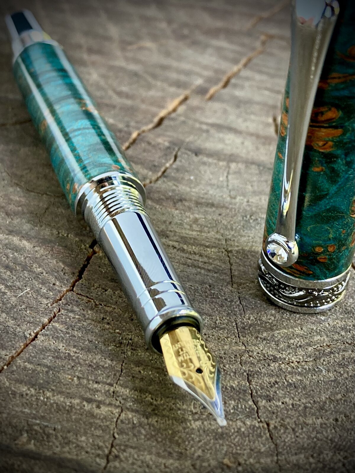

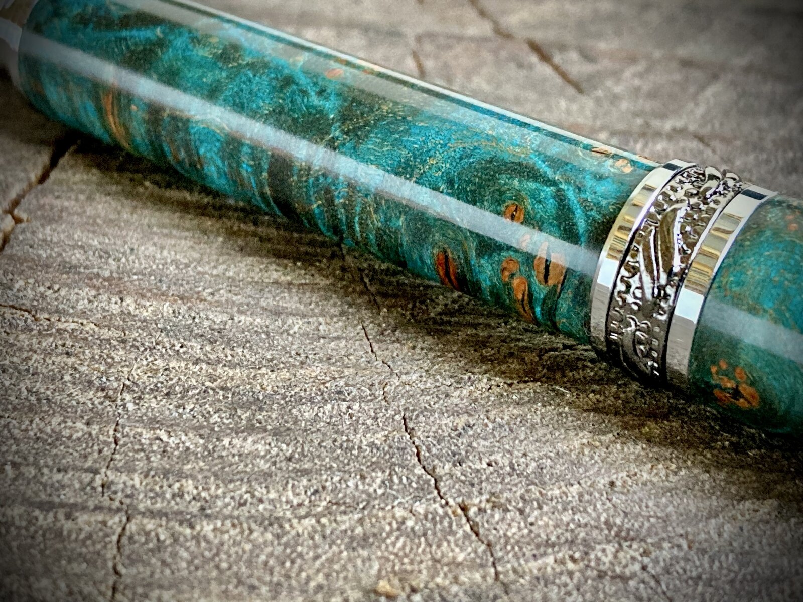

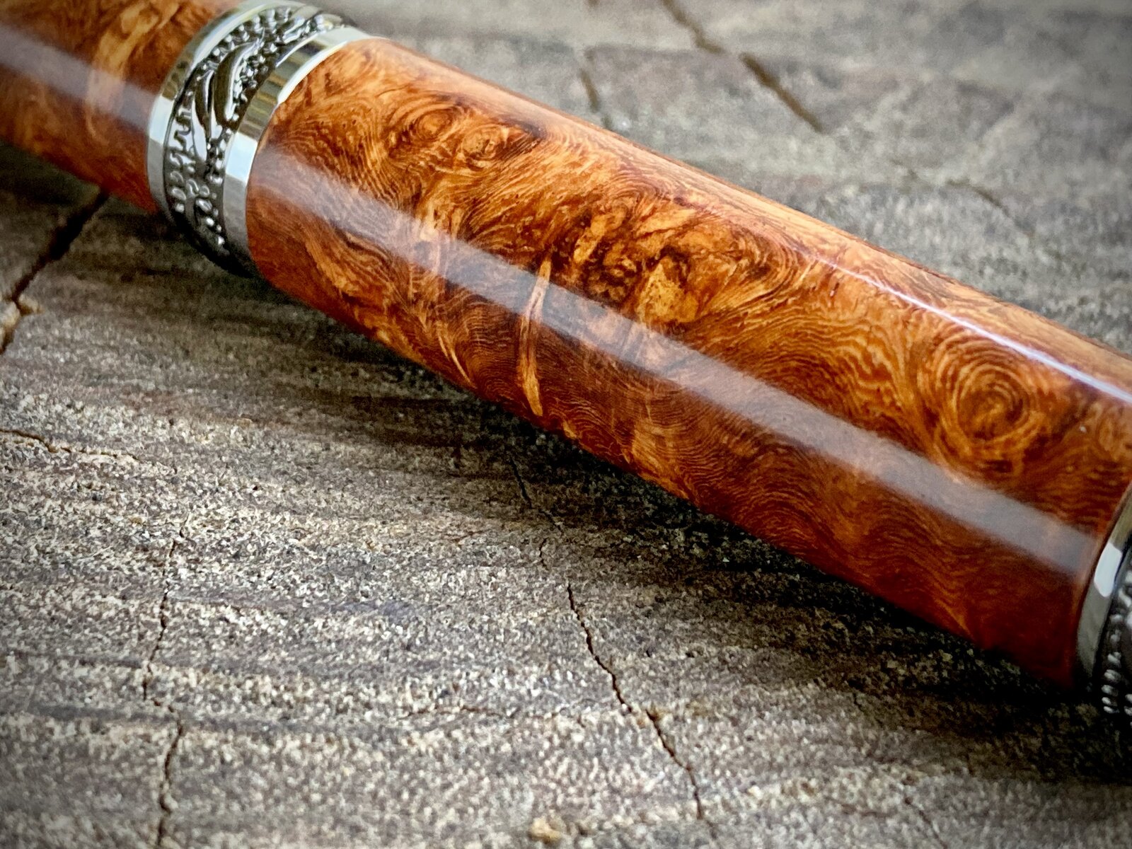

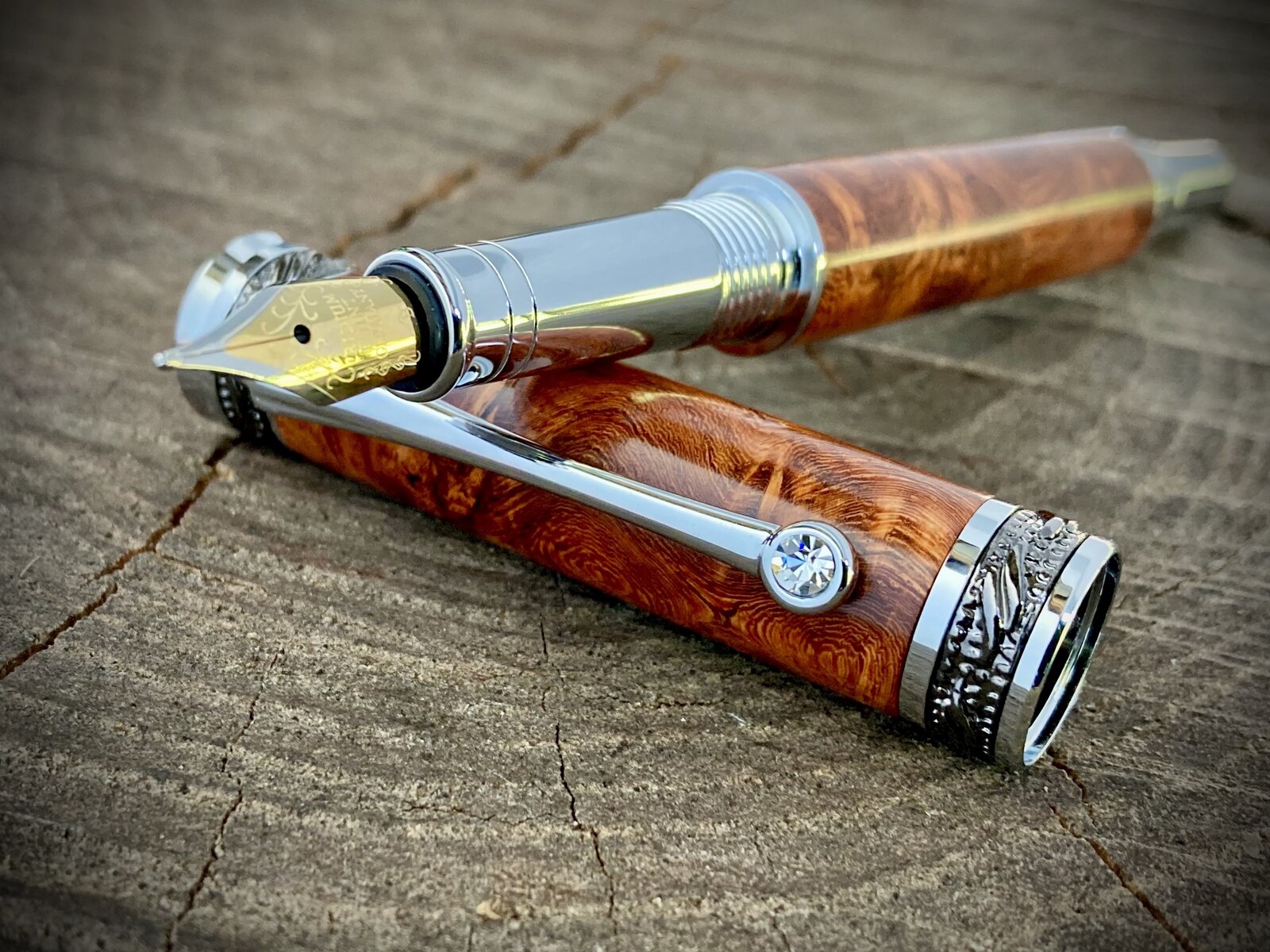

I turned this pair of fountain pens from Amboyna Burl, and Teal Dyed Maple Burl. The teal was stabilized wood, and the Amboyna was not.

I did one thing differently, which I have been doing on all my wooden pens. After turning to the finished diameter, I add 2 coats of green ultra-thin Gluboost (CA). Then I remove all the visible cyanoacrylate very gently using a square carbide as a scraper. The shiny top coating is removed, but the ultrathin remains impregnated in the surface of the wood. Then I proceed with my PensPlus finish regimen: Wet sand using walnut oil and micromesh, then apply PensPlus, and friction polish, two coats.
It certainly raises questions I can't answer.
Wouldn't the CA prevent the walnut oil from penetrating? Probably.
Would an already stabilized wood need the additional treatment of CA? Probably not.
Would the UltraThin step benefit an already lustrous wood like Rosewood or Amboyna? I think so.
But I can't argue with the results. The wood has a smoother feel and harder surface for finishing. These pens have a shine and touch that is half way between a CA high-gloss and a warm friction finish. It's a tiny amount of product, and minimal amount of time to add this step. I feel it's worth it.
What are your thoughts?
