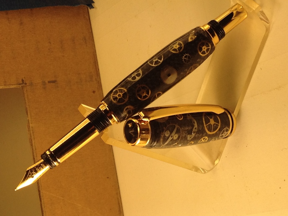

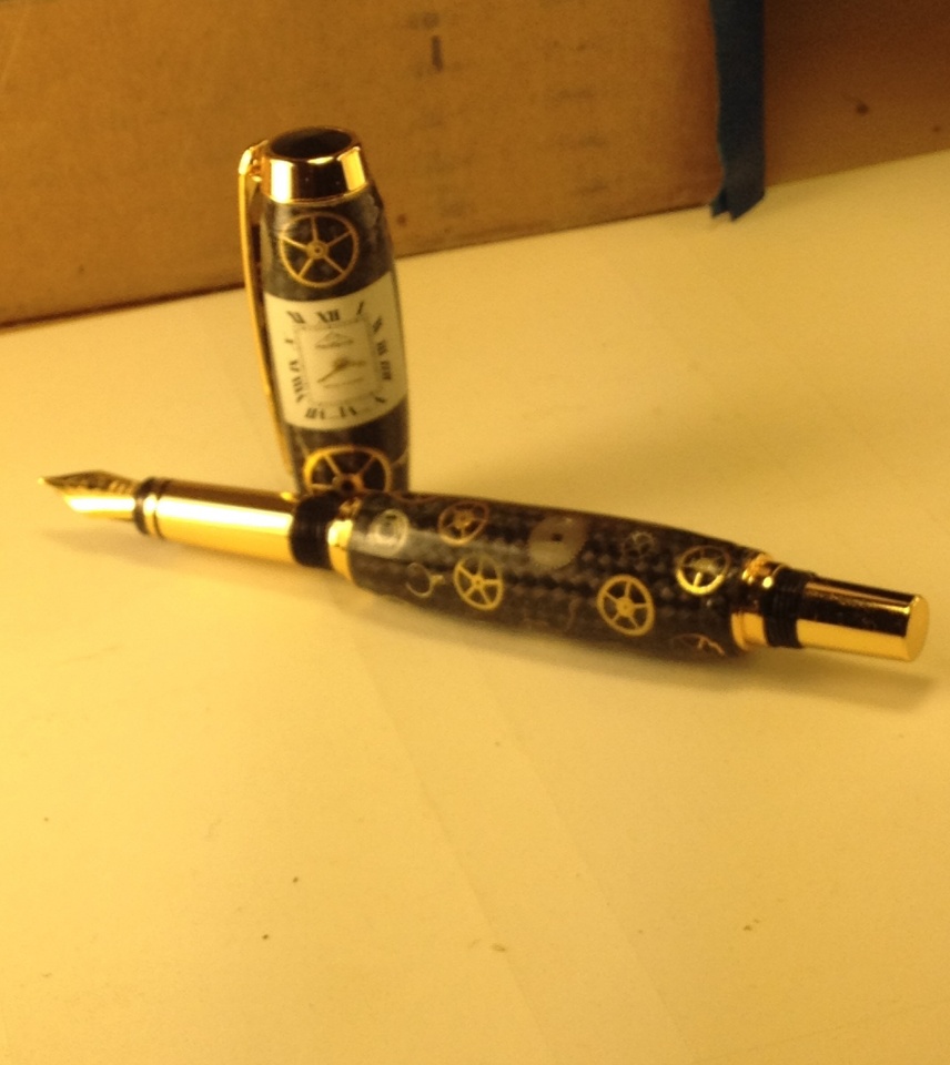

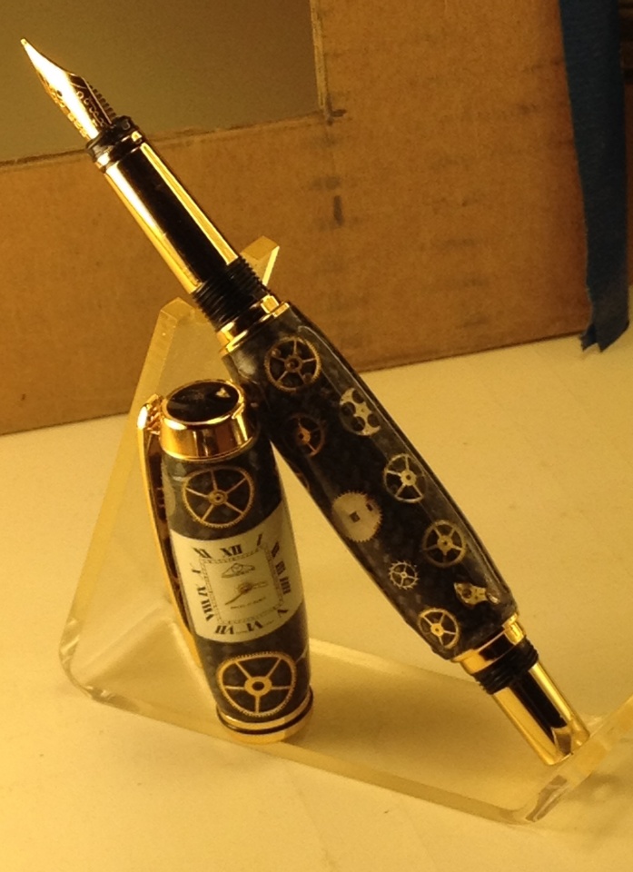

This is a Jr Gent 1 in gold. Covered tubes in carbon fiber and cast in Alumilite clear. Sanded to 24mm and two coats thin ca and than 9 coats med ca and resanded. Polished with Dr Kirk's polish ( all three).As always all comments are welcome and thank you for looking.

...all was fine until I looked at the third picture. Is it my screen or eyes or is there a problem at the low end of the 3rd picture as I see some non concentric areas? Also, why would one have to add CA to a cast and turned blank, I ask only to learn. Thanks and be well......Jan
Hi Jan,
The third picture is a light problem. I don't have the right light set up yet. I like to use the ca to protect the finish on all my pens
