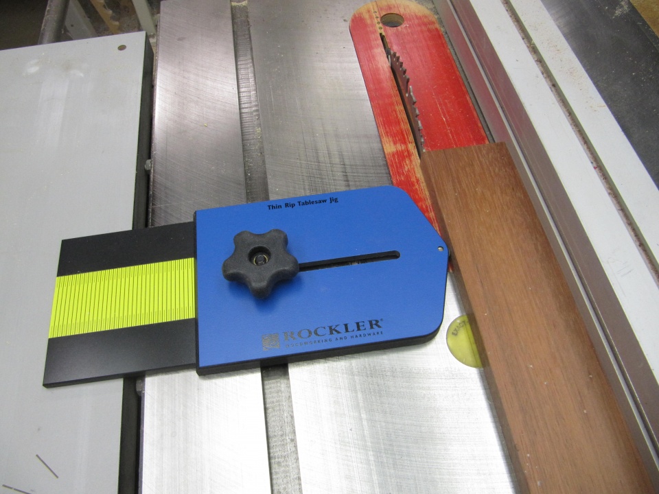

Try this!

It looks like we do the cuts just the opposite. I cut the slots on the bandsaw and tried to make the strips on the table saw. I got really close but not perfect like the white card. I think that yesterday I just wanted to start and complete a project rather than doing trial & error setup cutting strips.
[/quote]
Try this![/QUOTE]
Thank you for the suggestion. I'm thinking part of the problem is the fence on my 30 year old Craftsman 10" 113 saw. I've never seen anyone happy with it. I may give it another shot today. Thanks
