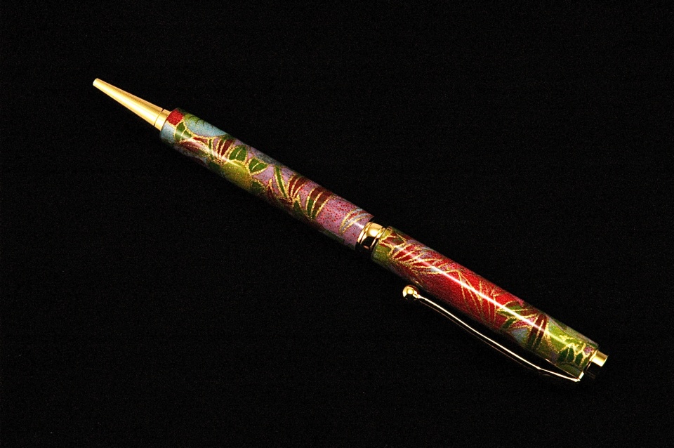

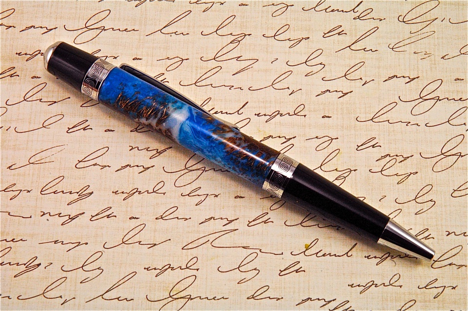

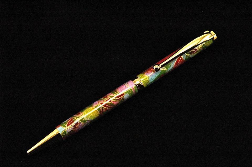

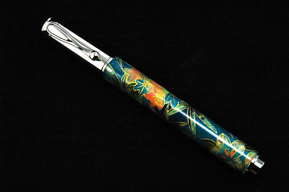

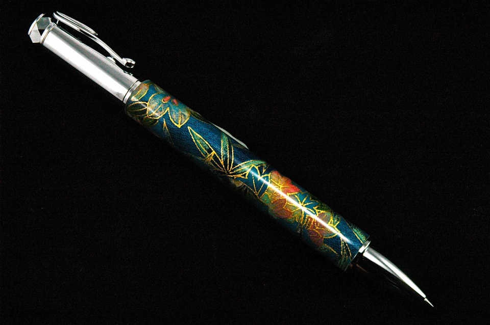

This is what my latest shop time produced.
The first is a Zen kit, with Japanese Chiyogami-Yuzen paper cast in Alumilite Clear.
The second pen is a Sienna, cast with chestnut husks (courtesy of Jim Smith) in blue and white Alumilite with blue powder flakes.
The last is a plain old Slimline turned into a fancy, beautiful pen, using Chiyogami-Yuzen paper. IMHO!:wink:
C&C are welcomed!

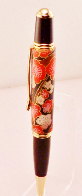

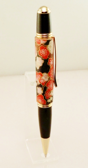

Being that I am 'not in the know', is it necessary to use Alumilite to cast this paper? Or could one 'get by' by using PR?
Love them all!!!
Scott (more, we need more!!!!) B
Love them all!!!
PR works just fine, as does CA if you don't want to cast. If I use a CA finish, I will turn a scrap barrel just undersize first and glue the paper to that. This will let you use more of the print. Jim S

You can certainly do it the CA way but you do end up with a slightly "fat" blank that doesn't line up with the bushings, but if that's the look you're going for, great! PR and Alumilite will give you a more robust blank in the end.
