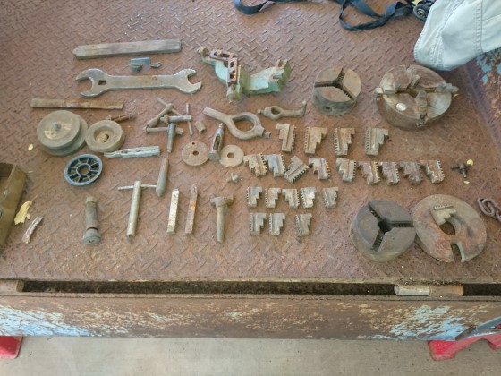

So I thought I would start cleaning up my Hercus 9 and try and keep the missus happy.

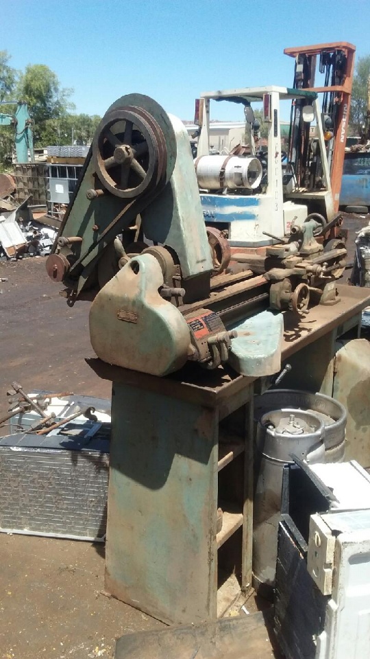

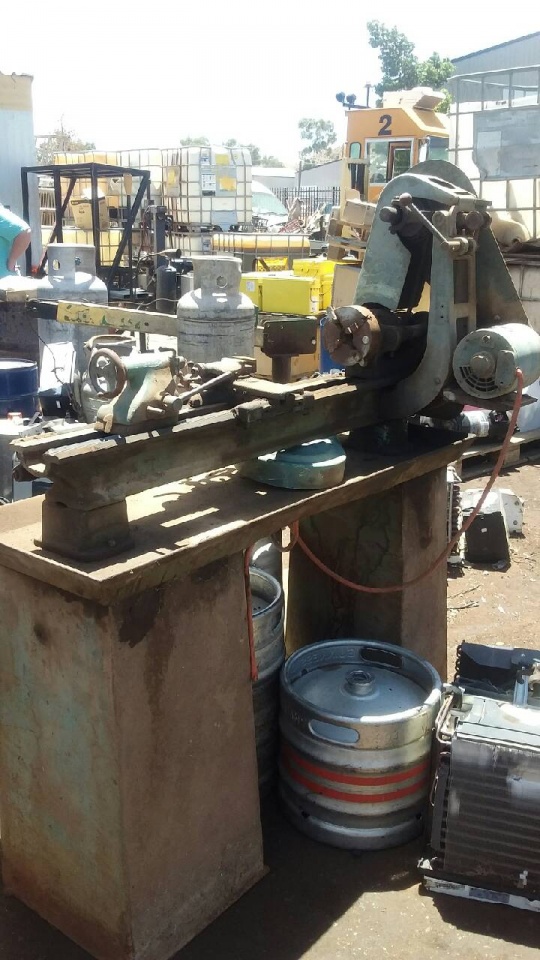

I saw this lathe advertise in Alice Springs in a recycling yard ( Alice is the closest town 500 Km away) in March last year, I only wanted the stand for my Hercus 260, but when I picked it up I found out it was an Hercus ARL.

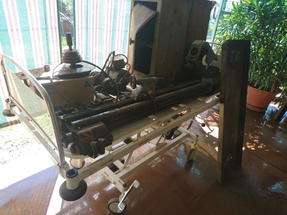

When I bought her home, I had to dismantle her to get her off the trailer and stacked the parts on an obsolete hospital bed, 6 month later I transferred to a different department at work so bought home my bench that I originally took there because it was too big for my shed.
For some reason the missus is keeps whinging about 2 lathes, a hospital bed and a bench on the back veranda, strange woman.

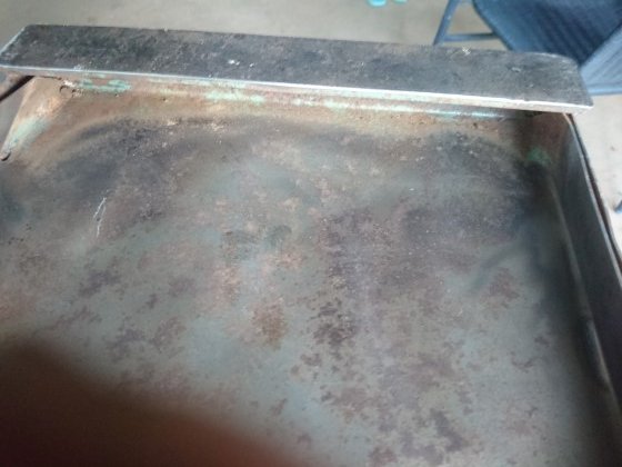

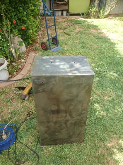

After I strip it back to bare metal, primed it with a kill rust primer, what further steps do I take before painting?

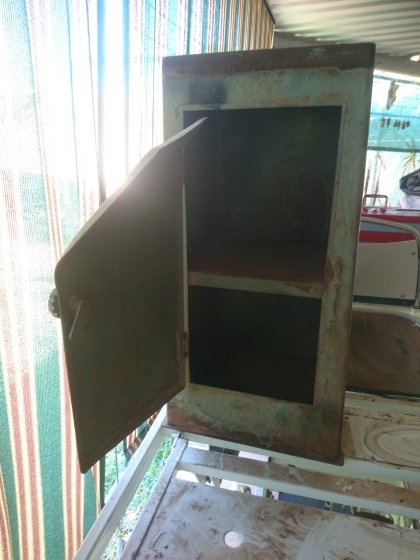

What is the best way to straighten this door?
Approx 3mm thick.

I was wondering how to cleaned up the corners etc, and the inside, I have been using an angle grinder with wirebrush.
My angle grinder are too big to fit inside the cabinet.
I dont have access to sand blasting equipment.

"I was wondering how to cleaned up the corners etc, and the inside,"
Uh the same way we all would do it before power tools. Grease your elbows and hand sand. :wink: Anything that isn't coming off easily can stay and get painted over.
