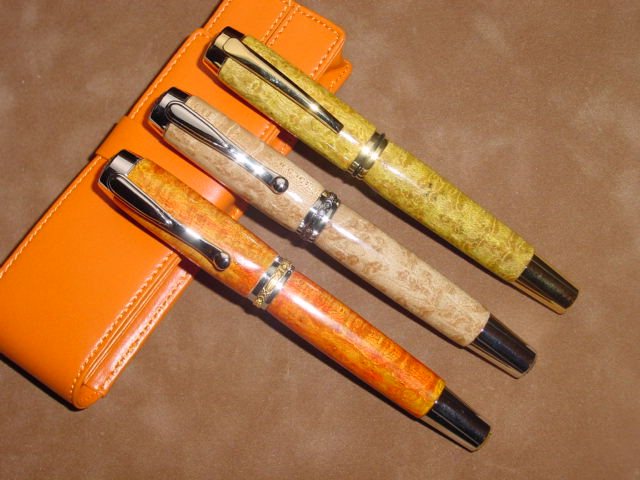

I made these to put in the guitar shop next door, as they match some of the guitar finishes at my brothers guitar shop.
Sunburst.......Natuaral.......Tobacco...All on Birdseye Maple
This is the birdseye, Chris at IAP had for sale. :)
The colors were created using the Chesnut spirit stains from CS

Chuck, there won't be no tutorial. the instructions that come with it are pretty good. The stuff dries almost instantly. The key to using it, is applying the stain, then sanding back and reapply. The tobacco was stained completely black, then sanded off to leave some dark spots and the yellow was applied over it. The Sunburst, was six applications of yellow & red, yellow just putting it on and sanding it off.

Want to try something really neat... put some chestnut spirit stain in with Minwax wood hardener when you vacuum stabilize some soft burls or spalts.. but only do it to blanks that you have drilled... you get some really neat color changes... I did it on some real dry soft curly redwood, used yellow dye and got a real nice effect... I will have to get the pen back and photo it... I gave it to my wife's friend... it is an interesting experiment..
