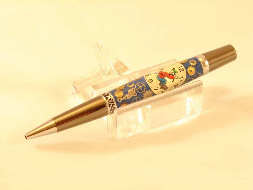

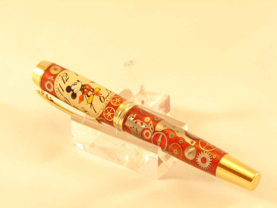

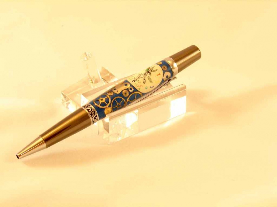

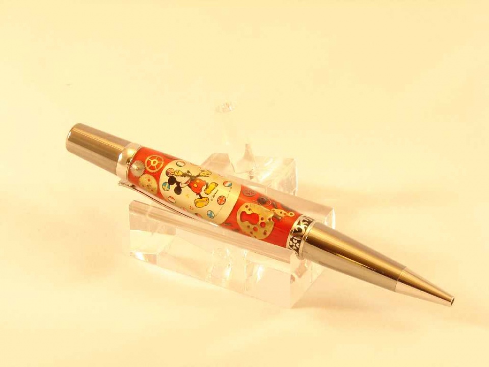

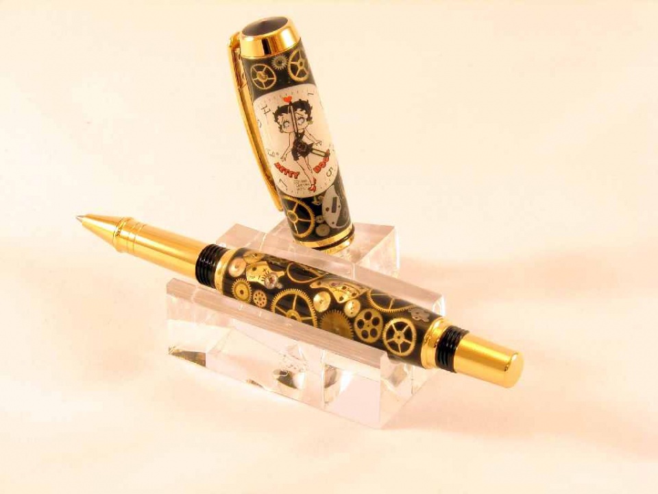

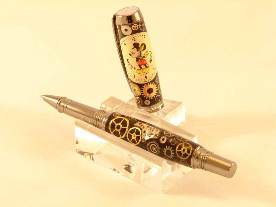

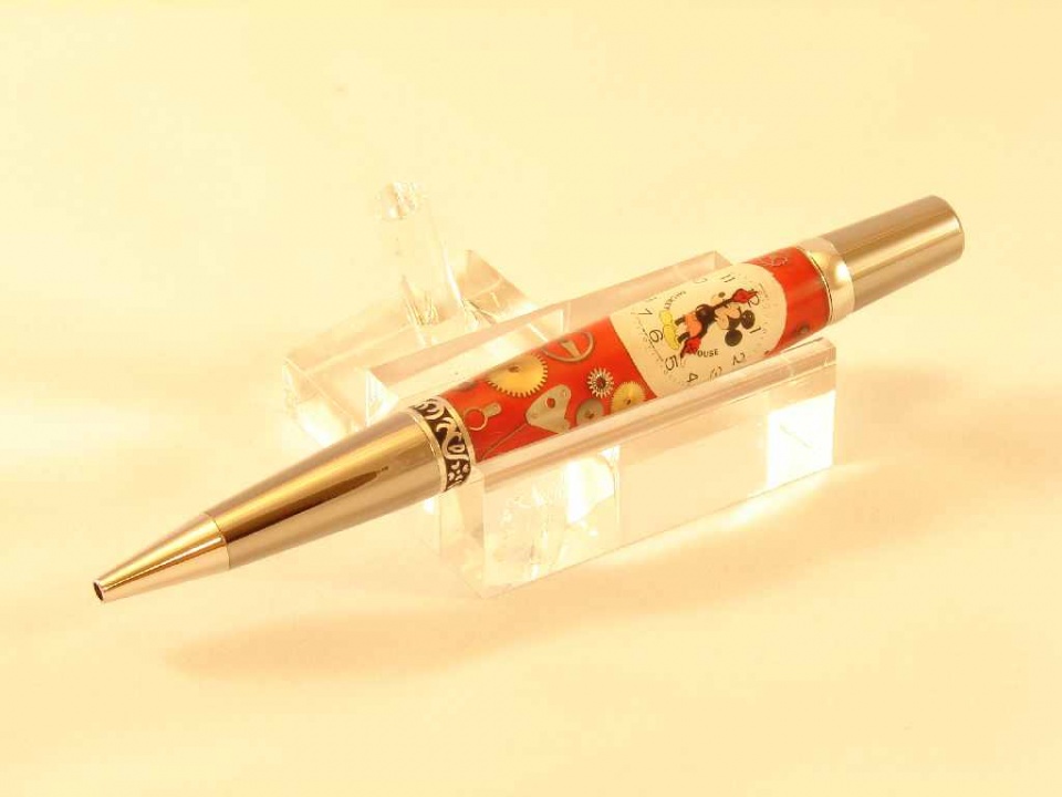

Here is my first attempt at making and casting watch parts pen blanks, at least the first that I am willing to show. The casting material is Epoxy and at the time I had no pressure pot.
I have a pressure pot that I just finished, it has held a little under 50psi now for about 2 days without losing any pressure, it is now ready to go.
I did make a "regular" watch parts blank but I wanted to do something a little different. I used cartoon characters, mostly Disney and Warner Bros. I have several more in the works with some other characters but I will wait until I get hem done, don't want to ruin the suprise.
Suprizingly I had only one or two bubbles that I had to fill, I hope that gets better with a pressure pot.
Here is what I have:
Betty Boop done in Jr Gent, Gold
Bugs Bunny done in a Elegant Sierra, Gun Metal and Chrome
Goofy done in a Elegant Sierra, Gun Metal and Chrome
Mickey Mouse done in a SN Gent (Timberbits) Gold
Mickey Mouse done in Jr Gent, Chrome
Mickey Mouse done in a Elegant Sierra, Gun Metal and Chrome

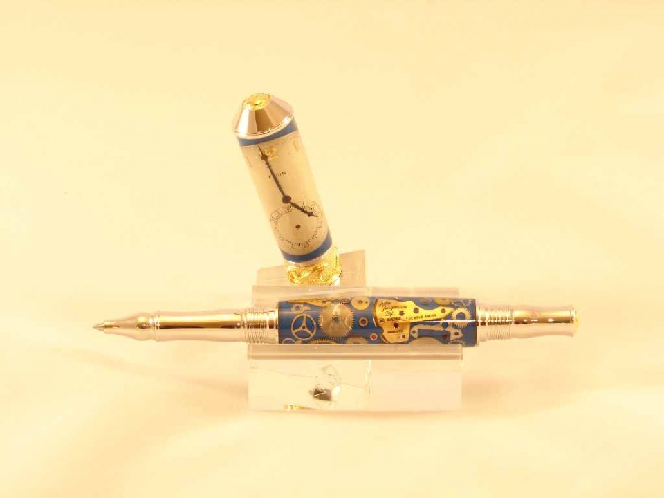

And finally a standard watch parts pen with an Elgin pocket watch dial done in a Nouveau Sceptre, Rhodium and 22kt Gold
Let me know what you think, if you see something that I can improve on let me know I am always ready to learn and get better.
Thanks, Mike

The tubes are painted
Yes, my tubes are painted. I used enamel spray paint. Depending on the paint I used one sometimes two coats. I let them dry a day or two before I started gluing the parts on. And them waited AT LEAST two days before I cast. On my first batch I re-glued on some parts or added parts and didn't wait to cast.
I had heated the epoxy to get it thin and it caused it to setup REALLY fast. The CA glue was still out-gassing and it caused lots of bubbles. Those are the ones that I refered to that I said "at least the ones that I would show" they were trash.
Mike

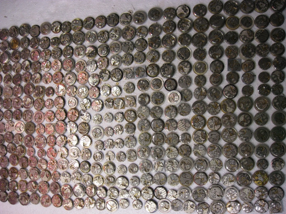

Great looking pens. As for watch parts, I bought watch movements in bulk from Bulgaria off Ebay. My wife thought I was nutz doing it. Do you know what 1500 watches look like and how long it takes to take them apart to get at all the good parts? Got a task till the next millenium...
Mike B
Mike B
Lol. Wow. I only bought 50oz but this is crazy... Haha. Good luck, send some this way if you get tired of taking them apart ;)

Mike love the work just my 2 cents but why have one of the hands in front of the face? To me that seems to distract from the purpose.
I think I can answer that one. Most of us that create watch blanks set the time to 5:00. Why, because as the great Jimmy Buffet says "it's 5 o'clock somewhere"...
Fins up...
Mike got it right, it's 5 o'clock somewhere... But it does hide the face, so on the Mickey and others with faces I have had to quit doing that.
Once I explain that to folks, I've never had an issue. Once and awhile someone might ask for a specific time which means something special though...

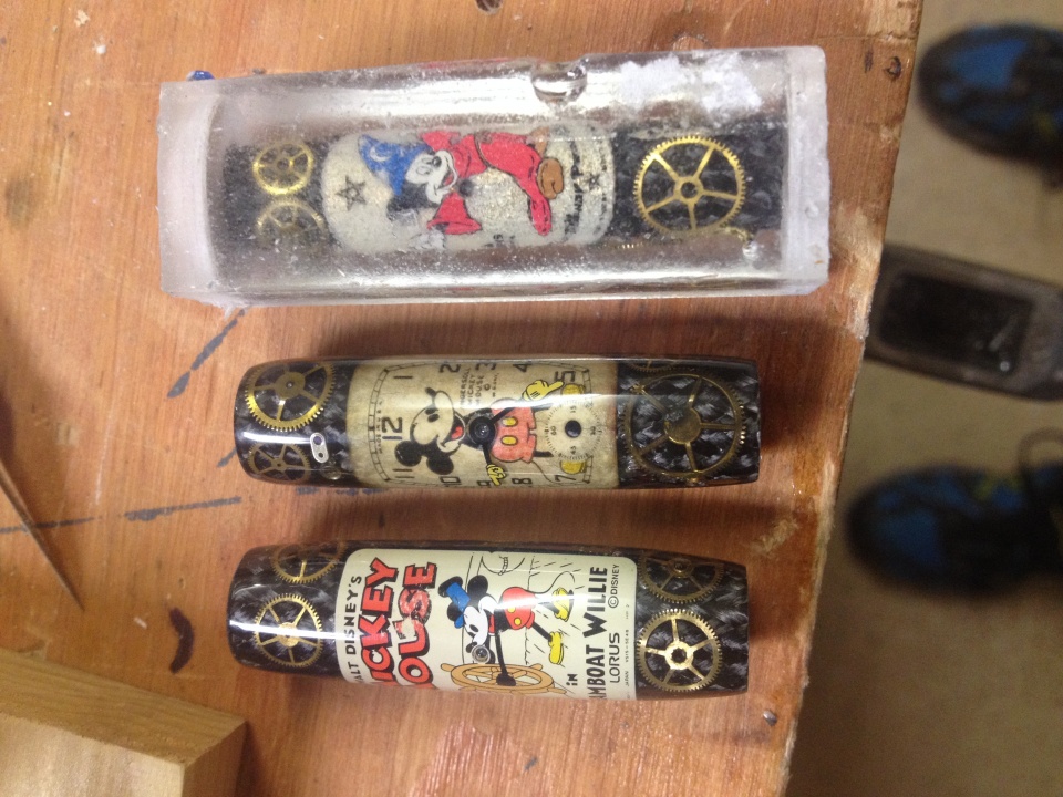

I haven't turned it yet but Is the one on the far right the Sorcerer?

That is the one
That is the Sorcerer, there are lots of them but hard to come by at a cheap price. The one on the far left is very hard to get also, a vintage Steamboat Willie. I have a 90's version that I am going to do, but the one you have is a late 60's I think. The cheapest I have seen those for is about $50.
Those are going to make some great pens.
Mike
