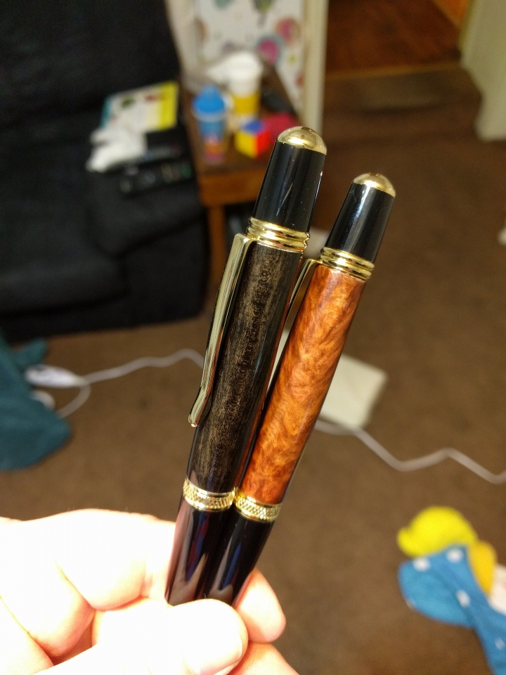

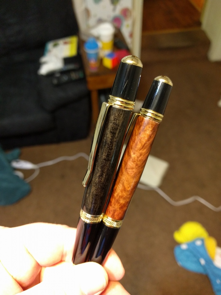

S sammyz Member Joined Jan 29, 2018 Messages 3 Location St. Louis Feb 12, 2018 #1 Not my first turned projects, but my first pens. Pretty pleased. Ebony for one and mallee burl for the other, Wall street II kits. Attachments first pens.jpg 171.1 KB · Views: 286

E elliepro Member Joined Feb 9, 2018 Messages 7 Location Oregon Feb 12, 2018 #2 very nice. Welcome to the addiction.
C cseymour Member Joined Feb 11, 2012 Messages 295 Location Newburgh NY Feb 12, 2018 #3 Nice job. That burl is stunning. What finish did you use? Sent from my iPhone using Penturners.org mobile app

Jim15 Member Joined Dec 20, 2005 Messages 21,688 Location Hamilton, Ohio, USA. Feb 12, 2018 #6 They look great.
S sammyz Member Joined Jan 29, 2018 Messages 3 Location St. Louis Feb 19, 2018 #7 cseymour said: Nice job. That burl is stunning. What finish did you use? Sent from my iPhone using Penturners.org mobile app Click to expand... Thanks! CA finish, 6 coats of thin, 3 of medium. I hit it with 600 abranet, then EEE ultrashine before I went through my micromesh. Came out pretty good for a first try I think.

Gregory Hardy Passed Away Oct 26, 2024 In Memoriam Joined Jul 13, 2017 Messages 276 Location Scio, New York State, USA Feb 19, 2018 #8 There's a good reason you are pleased - you should be! Very nicely done.

T Talltim Member Joined Mar 12, 2017 Messages 650 Location Tennessee Feb 19, 2018 #10 Nice pens. I love a nice brown or red mallee burl. I like ebony as well but my luck with it cracking has about crossed it off my list.
