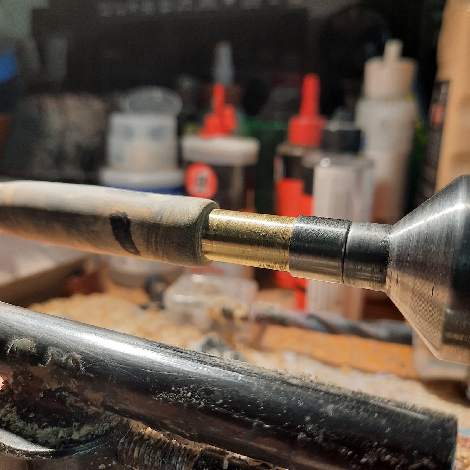

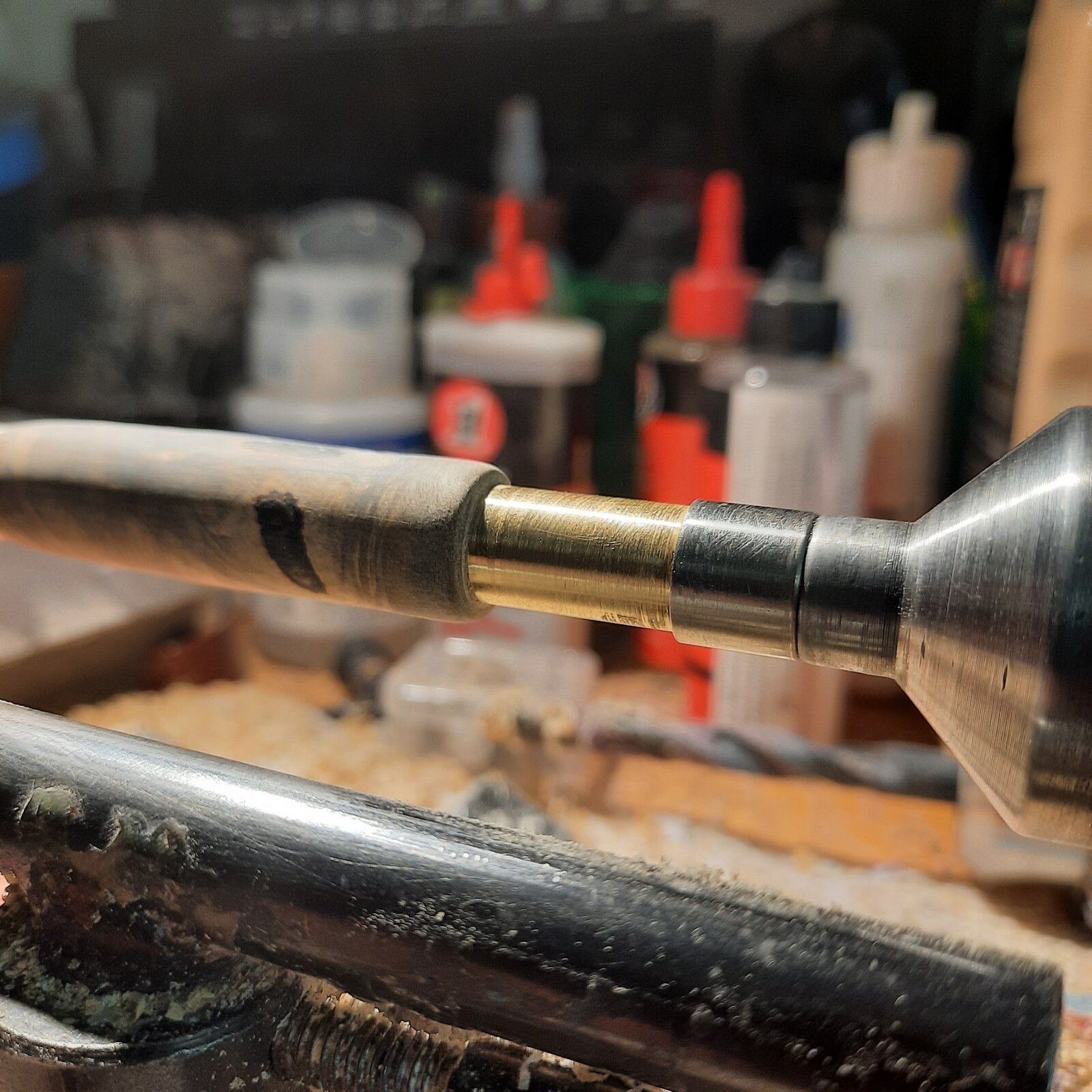

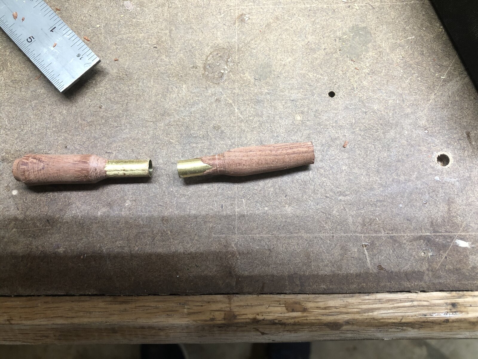

My first mishap mistake whatever you want to call it ... this is only my 3rd pen that I am embarking upon and I turned the blank too narrow and the blank broke and now the brass inserts are visable .... I'm not looking for a solution to this ... I just can't believe how quick I went from having a thick barrel to none at all... what sucks is that I don't have any more blanks ready for turning and need to wait until tomorrow night..... that's what I am beyond mad at.
oh well ..in Wood working I hate to say it but I learn more from my mistakes than my triumphs .. but it still is disappointing

Everyone makes mistakes in the beginning. Its part of the learning process. Remount them and turn the wood off and save the tubes. That way its not a total loss. You will do better next time.

What Tool are you using to turn? The rough turnings make it appear as though the tool was not as sharp as it could/should be, and as a result it is possible that too much pressure was applied. Dull tools require more pressure.
I am using a carbide tool that has a square carbide tip ... you might be right I might need to turn the tip and get a fresh edge.
You might want to change out the square carbide with one that has a radius to it. I believe mine has a 2 inch radius. They are less prone to a catch as the pure square ones are.

FWIW, I have a "square" carbide cutter with the 2" radius and mostly use it to scrape CA finish even before sanding. If I make something with a stone inlay, I use it there, too. Otherwise, I prefer a standard HSS skew. That's just what works best for me.
Re looking at your picture, I can't for the life of me figure out why you were so close to the tube in relation to the rest of the blank.

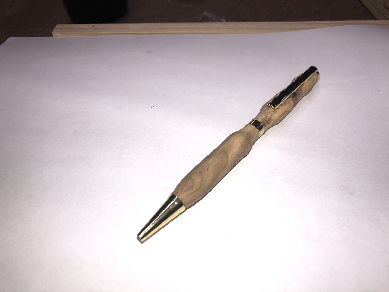

I was just turning the middle of the barrel thinner so as to create a flaired cap and nib kind of like the picture below
To achieve that in the photo just above, be sneaky, - sneak up on it, size wise. :)
You have one advantage going for you - most people are a little timid and leave blanks a little "proud" - meaning oversized because they are afraid they might turn it down too much (and I did that early on). And another thing you did - you posted it here. There are a bunch of us too embarrassed to publish our mistakes and it takes us a lot longer to learn too! 😳
You will get up to speed in no time. Keep at it! 👍
Greetings from Nebraska. For what it's worth, another thing that might help is to make sure that the blank is securely glued to the tube, especially on the ends. I've had even minor catches tear a blank off when it wasn't securely glued - so I over-apply the glue to my tubes - I use glue like someone else is paying for it - more epoxy (or CA) goes in the trash than anything, but a good secure bond between the blank and the tube I think is very important. (This is something that I learned from Zac Higgins on one of the NV Woodwerks, Pen Turning 101 YouTube videos.

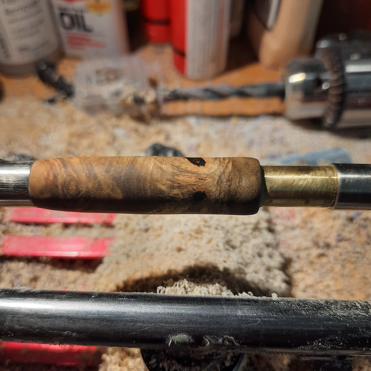

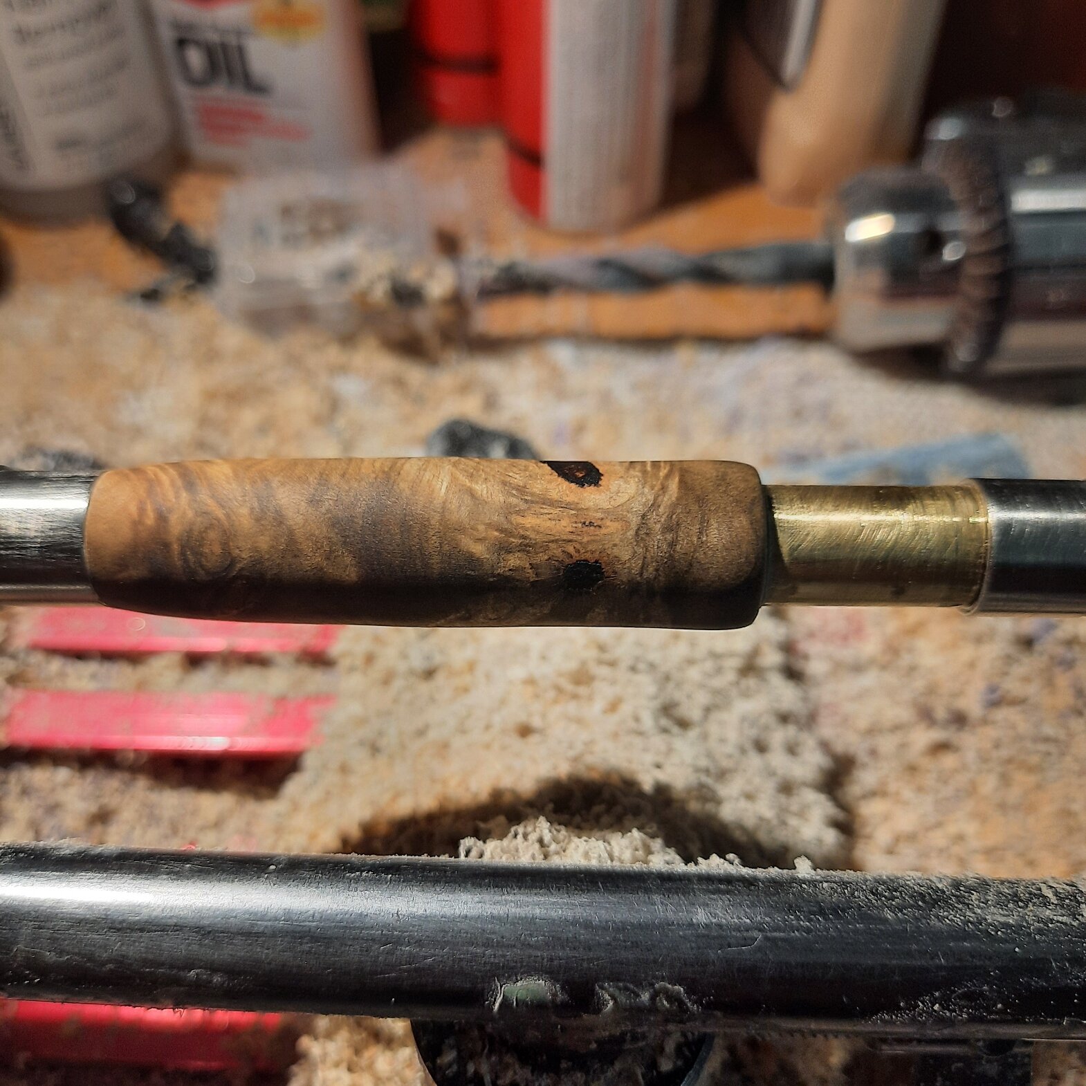

This happened last week. A beautiful piece of Buckeye Burl. I will cast the leftover in some epoxy.
