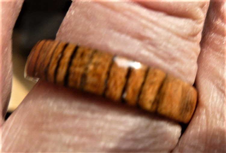

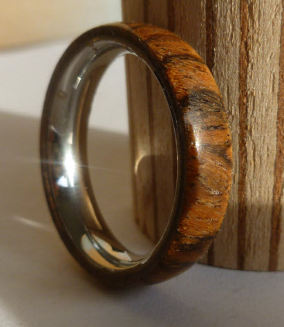

I tried my hand at ring making (no pun intended). It certainly requires a delicate touch - see attached. My first attempts weren't wholly successful. I got started because I wanted to make one for my wife as a surprise but I got the size wrong by measuring a ring she has but I now realize she does not use :(. Plus, believe it not, my wife now wears my gold wedding ring. It just goes to show how we change over time. So, I decided to make a "wedding" ring for myself since my wife has urged me to have something. I could have purchased one but this is more personal. I think the wood is bocote and it has a CA finish for durability.

You did a nice job! And I love the story - My wife and I have non-traditional rings also, so I appreciate your story, very nice.

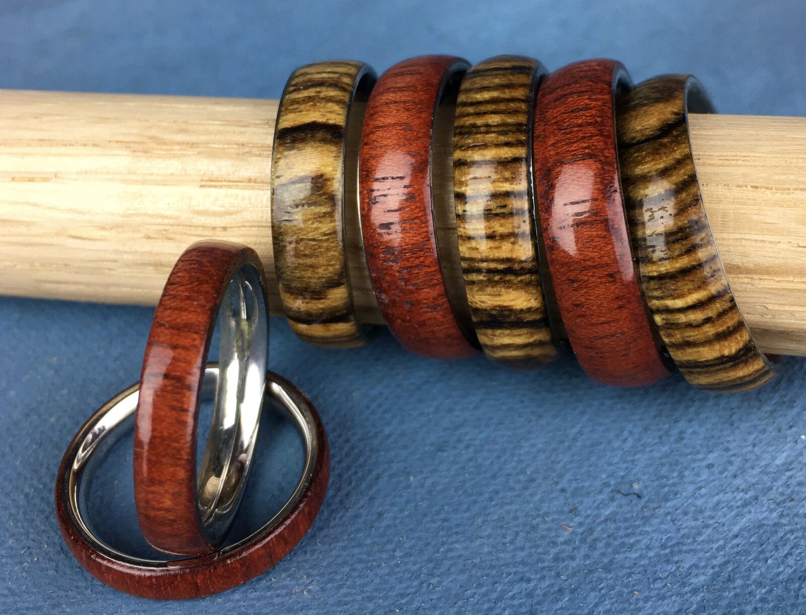

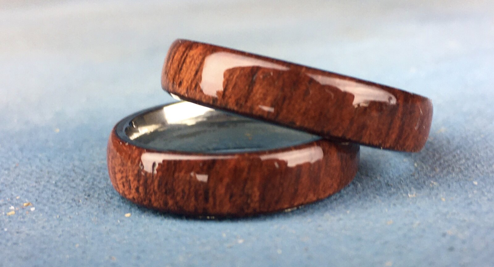

Beware
I've made about 30 of these with bocote, blood wood and BOW. I can guarantee that I was precise in using a boring tool to get the hole very tight. Not too tight that no glue would be left, but tight. I sanded the outside of the core, used epoxy glue, waited overnight and turned the rings. All were finished in CA and buffed to a great shine. They seemed perfect and were popular.
Bad news - four have failed! It seems that the stainless steel and wood either expand differently or moisture caused the wood to separate from the metal. Since I sold these I ended up remaking them at first until it happened a second time. I've refunded the purchase price, apologized and tossed all my rings made this way. Two were used in a ceremony so they were very unhappy.
My other rings that have titanium inlay opalescent crystals have not failed nor have the ceramic core rings. One saved a guy's fingers when they might have been crushed at work without serious damage to the ring.
As always your results can be better
