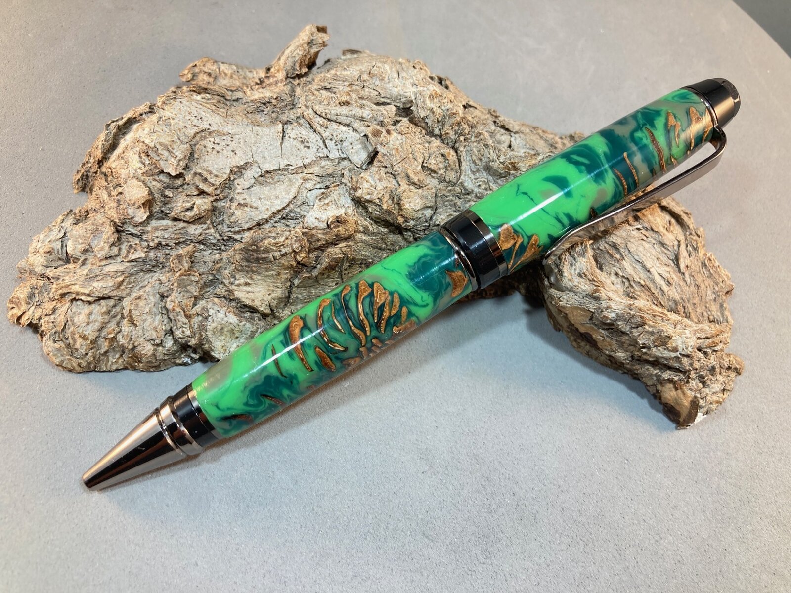

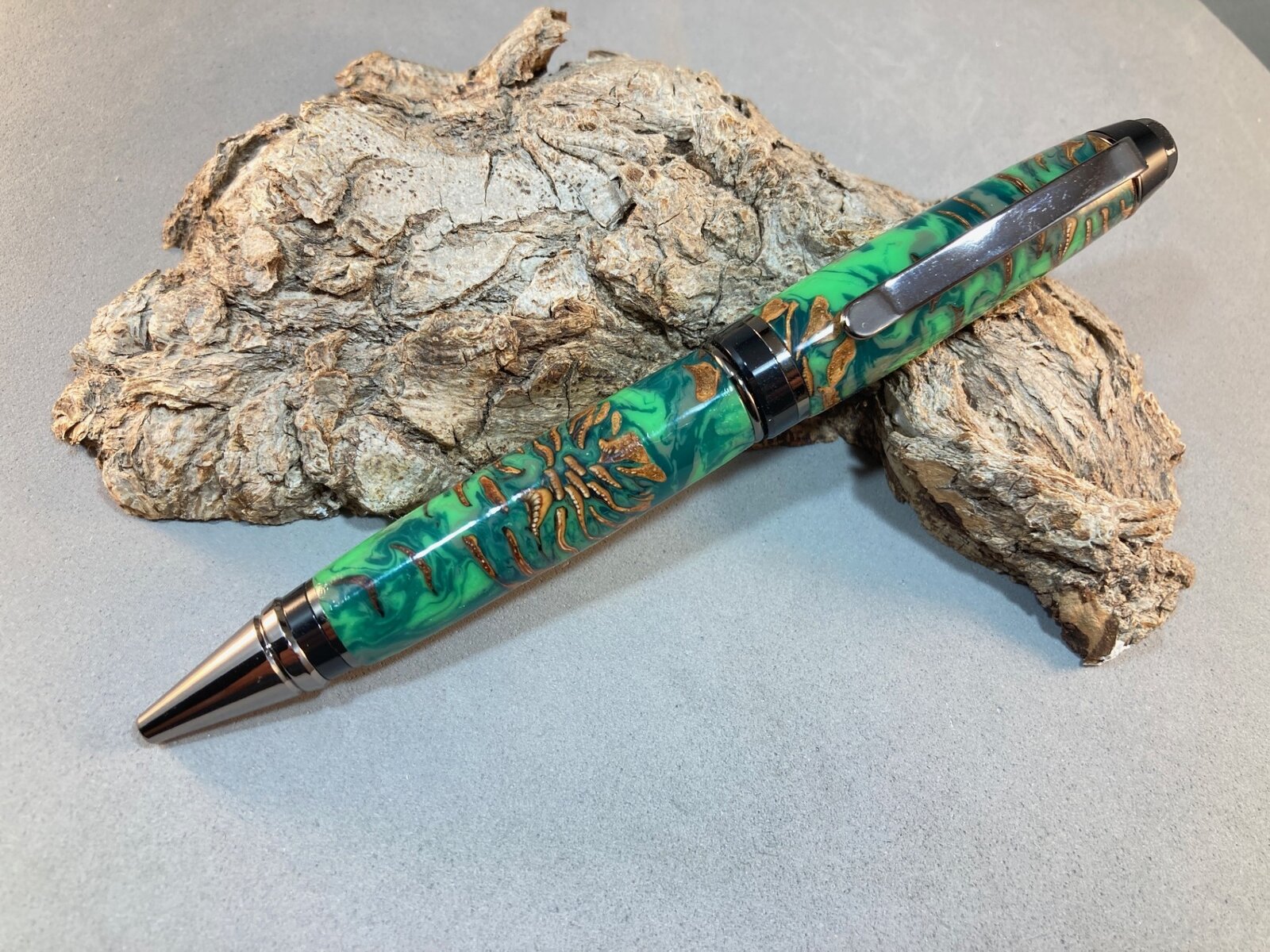

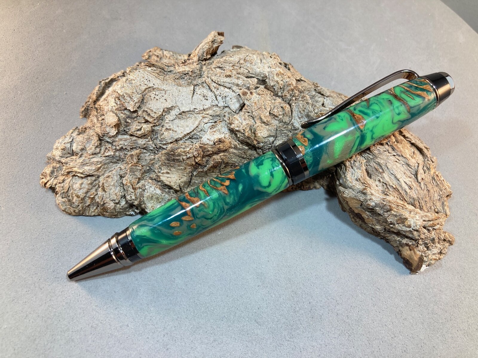

I picked up some pine cones under some trees in the neighborhood, dried them in my oven, then cast them in Alumilite clear slow.
I used 3 different shades of green (Key-Lime, Harmony, and Department of Defense). I was quite happy with how they turned out. I have a blank prepped for turning, which I hope to do tonight.

Thanks Dave - I did not stabilize these pine cones. I did dry them in a toaster oven for about 5 hours at 250F. I chose not to stabilize them because they were pretty woody/firm, as-is. These pine cones came from a long needle pine,
I also have some pine cones from a Blue Spruce that have much thinner "blades" - they are much less rigid, so I did stabilize them to see if they got a little stiffer with the cactus juice. I have not cast them yet.
