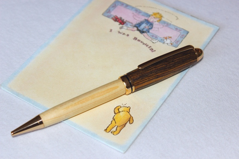

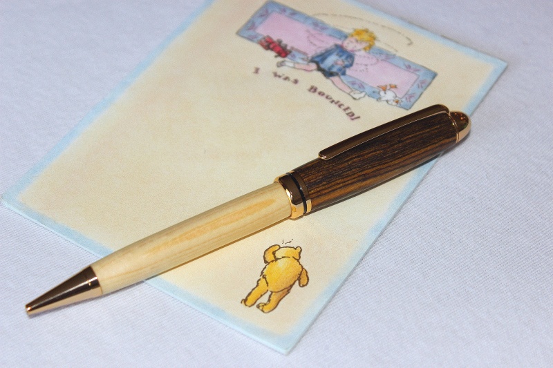

It's a simple Designer Twist with Bocote and white pine. Figured I'd start with the less pricey stuff to get a feel for it and tweak all my gear. Very fun pen to make and my daughter will love it.

Very nice looking pen! Certainly much better than my first...

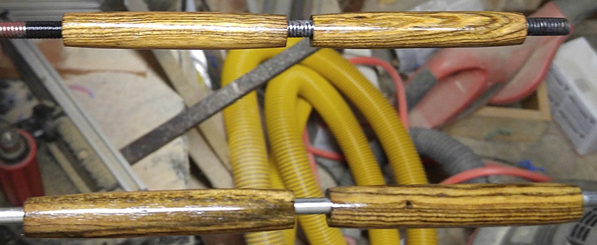

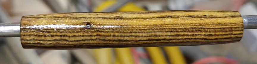

Thank you. I had a week between setting up my little shop area in the garage and receiving my first order of pen making supplies. During that time I took some 2x4 scraps I had been saving and cut them down to size and practiced. Not totally satisfied with friction polish. Over the next few days I'll do some experimenting with CA and polyurethane. I've done quite a bit of reading on finishes and am wondering why nobody uses spray on poly. Seems like it would be fairly simple to tape off the bushings and lay a drop cloth over the lathe and hand turn the spindle while spraying. Put on a few quick coats with drying in between and then sand. I'm not the smartest on this stuff but I do love it.

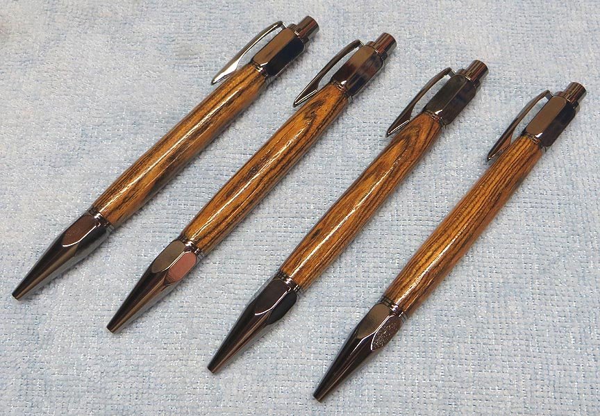

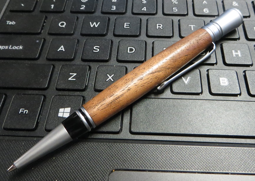

qquake
Feb 8, 2004
5,023
Northern California

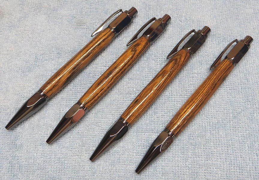

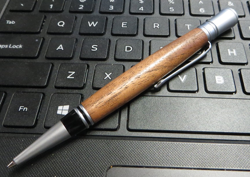

I've used spray lacquer on a lot of wood pens. I spray the bodies before I assemble the pens. It looks good, but I don't know how well it holds up. I don't sell my pens, and I don't use them a lot. I still haven't mastered the CA finish. Lately I've been using Watco Danish oil, and I like the hand rubbed look. The Executive pen below has a Danish oil finish. The Vertex click pens have spray lacquer.

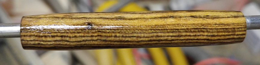

sturner
Jan 28, 2016
12
Alabama
Nice work, both are beautiful. The oil looks more natural but the lacquer looks more brilliant and durable, IMO. I hate to give a pen as a gift and six months later see the person and learn that the finish wore off quickly and the pen is now dull. I just finished turning two experimental pieces of waste blank. CA'd one of them and spray clear enameled the other, both off the lathe. Was going to use poly but my can is so old it wouldn't spray, smh. I'll do three coats of each and then wet sand to 2000. If they turn out any good i'll post a pic. Your pens are beautiful.
