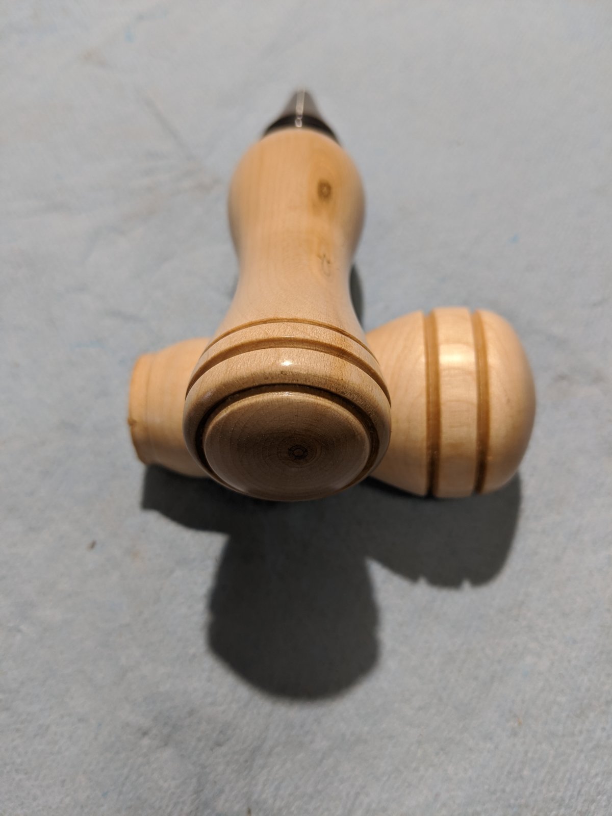

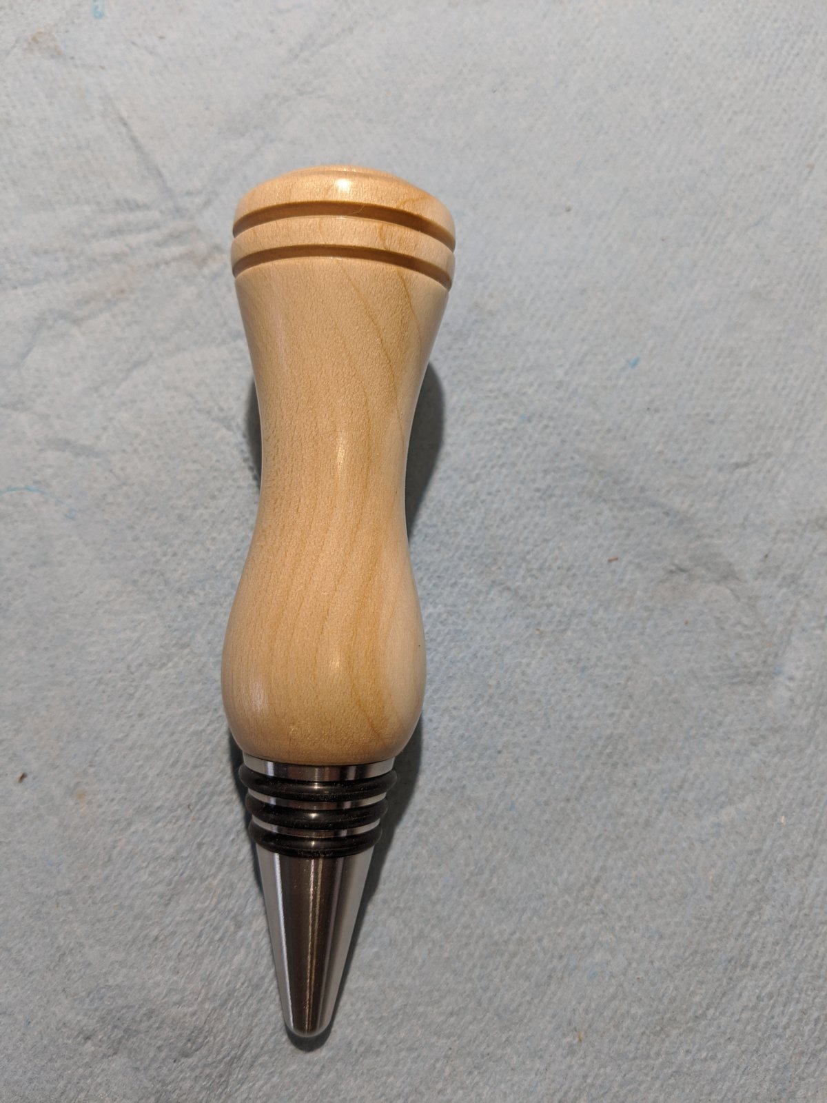

I've turned a few bottle stoppers that I've gotten from PSI but was really never happy with the Chrome finish especially after seeing where the Chrome gets pretty nasty looking. So a while back Ruth had some stoppers on sale I thought I'd give them try. I'm happy to report that they are VERY nice to work with and should last a life time. This stopper is on it's way to a Scottish friend of mine who has her own pub, not in Scotland but in Oregon. I think she will like it and it fits perfectly in a Scotch Whisky bottle...I tried it myself. The wood is Rocky Mountain Maple off my property. The second picture has my first attempt at turning the handle for the stopper but holding up the good stopper. I had some issues that were resolved once I figured out what I was doing.

.... and that's a lovely stopper you are sending to your friend .... very well done !!!

A little on the tall side for putting back in the cupboard but the detailing is clean and crisp.

A step drill for sheet metal makes a hole that is just right for holding a stopper upright if you need to make a stand.

I like your stopper, nice clean lines and pretty wood.
I've never used Ruth's stoppers, though have heard many good things about them. Agree about the PSI chrome finished stoppers... the chrome will chip and corrode.... I buy my stoppers from a company in Seattle caled EZ-POTS.... same stainless steel as Ruth uses, but half the price..... nothing against Ruth, but looking at cost and profits.

Tom, the stopper looks great. How did you finish it? Navy stories sound similar to mine. :cool:
Hey Chuck. The finish on this stopper is 3-4 coats of WOP that I put on as a friction finish. Let it sit overnight, hit it next day with some 00 steel wool then some min wax floor wax then to the buffing wheel. I give instructions to every customer letting them know that to bring back the shine just put some furniture wax on it, but not stuff like pledge. Never have had a complaint.
