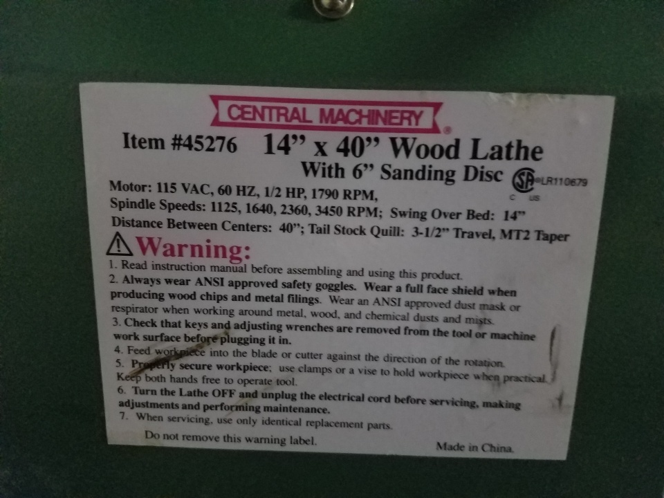

I have taken the first step and purchased my first lathe
I would appreciate any suggestions on what to get next

Please tell us more about the lathe.

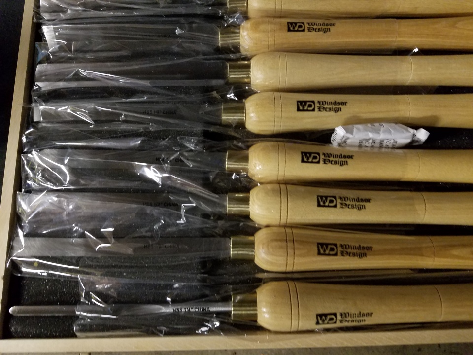

I did get some tools with lathe.

You need a way to sharpen your tools. I have the slow speed grinder from Woodcraft and the Wolverine setup and a couple diamond hones. many people have this setup but there are others. Some use a belt sander for sharpening.
I have the same tools as you do from HF. Bought them 8 years ago and still use them for pens and other small spindle work. FYI, do not use them for bowls. They are for spindle work only.

Also, those tools will need sharpened soon after use. I have a set of them and they are definitely not hss. But I do use mine all the time for pens. A grinder is a great investment and you can get an el cheapo. I use a home made sharpening jig as opposed to the wolverine. (Only because I couldn't afford one at first, but now because it works flawlessly).

The tools are HSS. Why don't you think they are? What do you think they are?

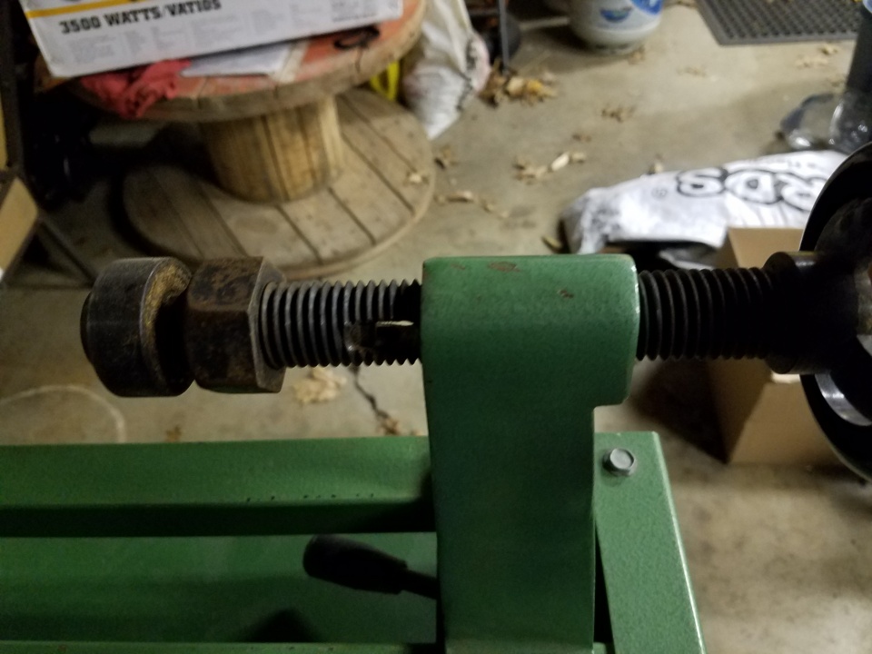

It might be tough to drill blanks on that lathe. I do not think the tailstock has a removable center, at least the one i had that was like that did not. Most now have a Morse Taper 2 on both the headstock and tailstock, which makes it easier to find accessories. I don't that that lathe has MT2 on either end. But not to say you cannot have a lot of fun with it. Enjoy
I have a bench grinder, lathe came with sanding disc on end and 8 piece chisel set that has never been used.

I know the lathe has #2MT though I have no clue what that means but from what I have read I can tell it is important.

I suggest you grab a round or square piece of wood (about 2" is plenty), put it in between centres and test those tools you have there. Some come quite sharp from factory but some other not so much so, you will need a good white diamond coated disc/wheel for a bench grinder, sharpening your tools will be something you will need do all the time so, if you don't have one, try to get one and a good wheel, you then can think about chucks and other accessories that you may need depending on what you want to turn.

Your picture seems to show the tailstock only, and it does not look like it will take a live center (which is on your list of needs).
You will also need your tailstock to accept a Jacobs chuck (preferrably with MT2 arbor) if you are going to drill on your lathe.

Your tail stock does take a Morse Taper of some kind. Likely a #2, one of the sizes in the series. What the tail stock doesn't have is a self ejecting feature that most lathes come with to push out the Morse Taper attachments. The way you remove them on your lathe is to tap in a wedge specially made to fit the slot in the threads. If your extras that came with the lathe didn't include the wedge it can be bought from any supplier selling metal machining tools like Grizzly. They are cheap. The tools mentioned by others (centers and drill chucks) have the Morse Taper attached to hold them in the tail stock

The good news the lathe has a lot of capacity. The bad news is the vendor has a reputation for some wide variations in precision and consistency. If you got it new, you can return it if flawed, if purchased used, you may need to learn some "work arounds".

I want to thank Curly for the tail stock wedge lead I ordered mine today.
