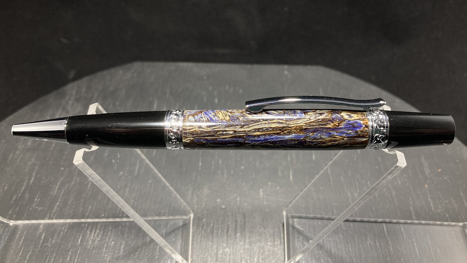

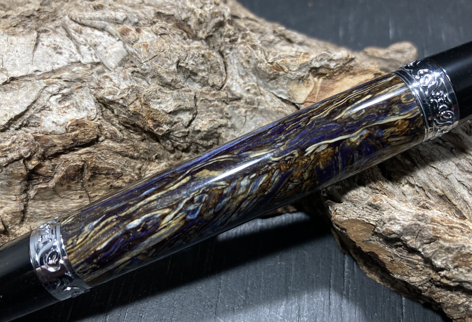

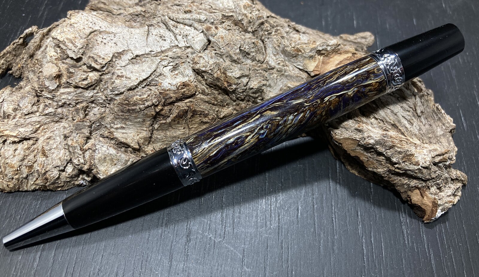

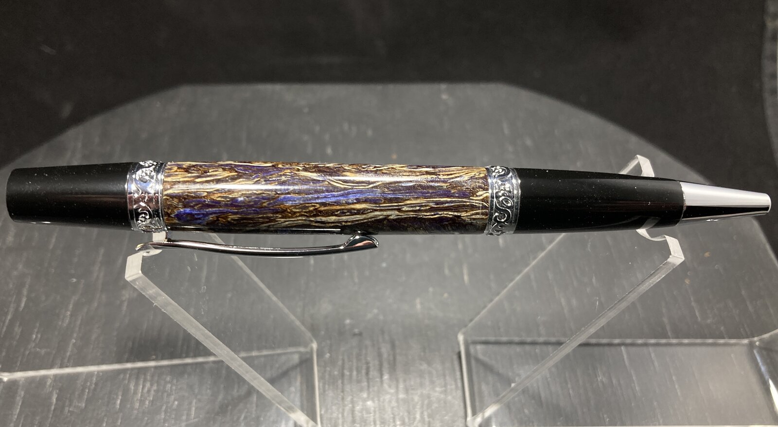

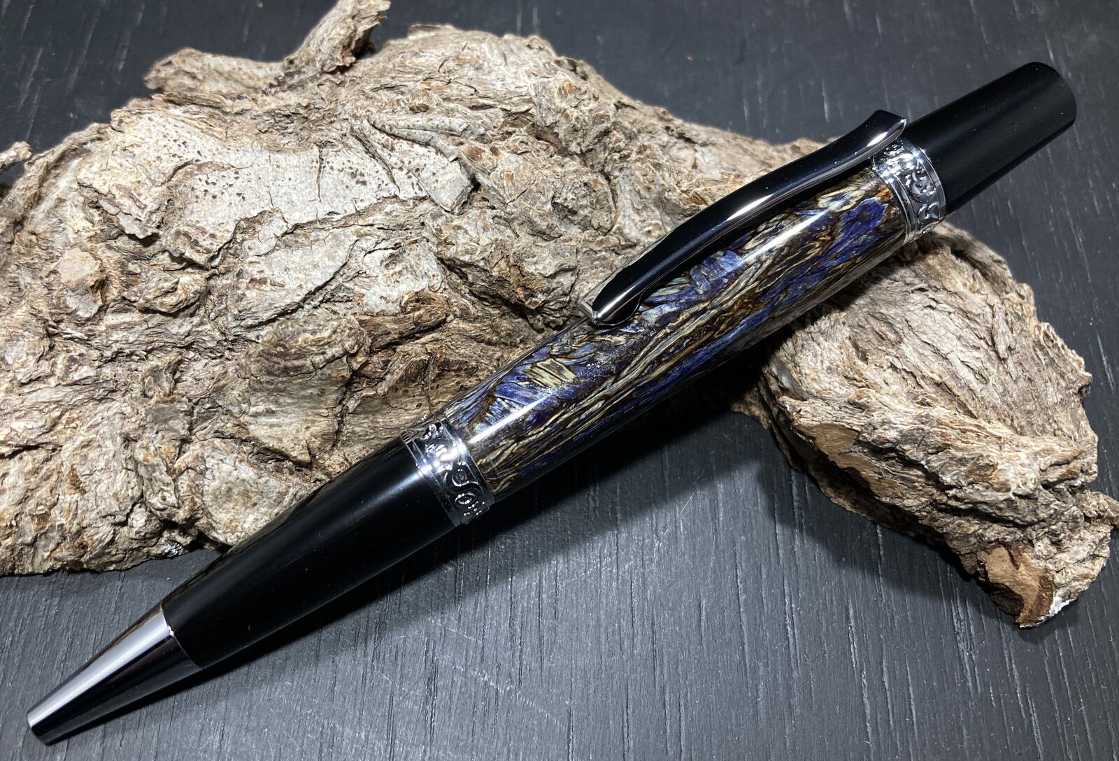

Sort of like turning OSB. I was not sure if I needed to stabilize it, since it is already pressed together with a binder, but I threw it into some blue-dyed Cactus juice for a couple hours under vacuum. Turned out interesting enough. Not sure if I will make more though...

Very nice! I'm seeing a lot of these hempwood pens lately... It is one of the few types of blanks I don't have in my inventory, and I think I'll have to add some soon here. How well does it turn? Is the finish on this due to stabilization resin, or did you add another finish?

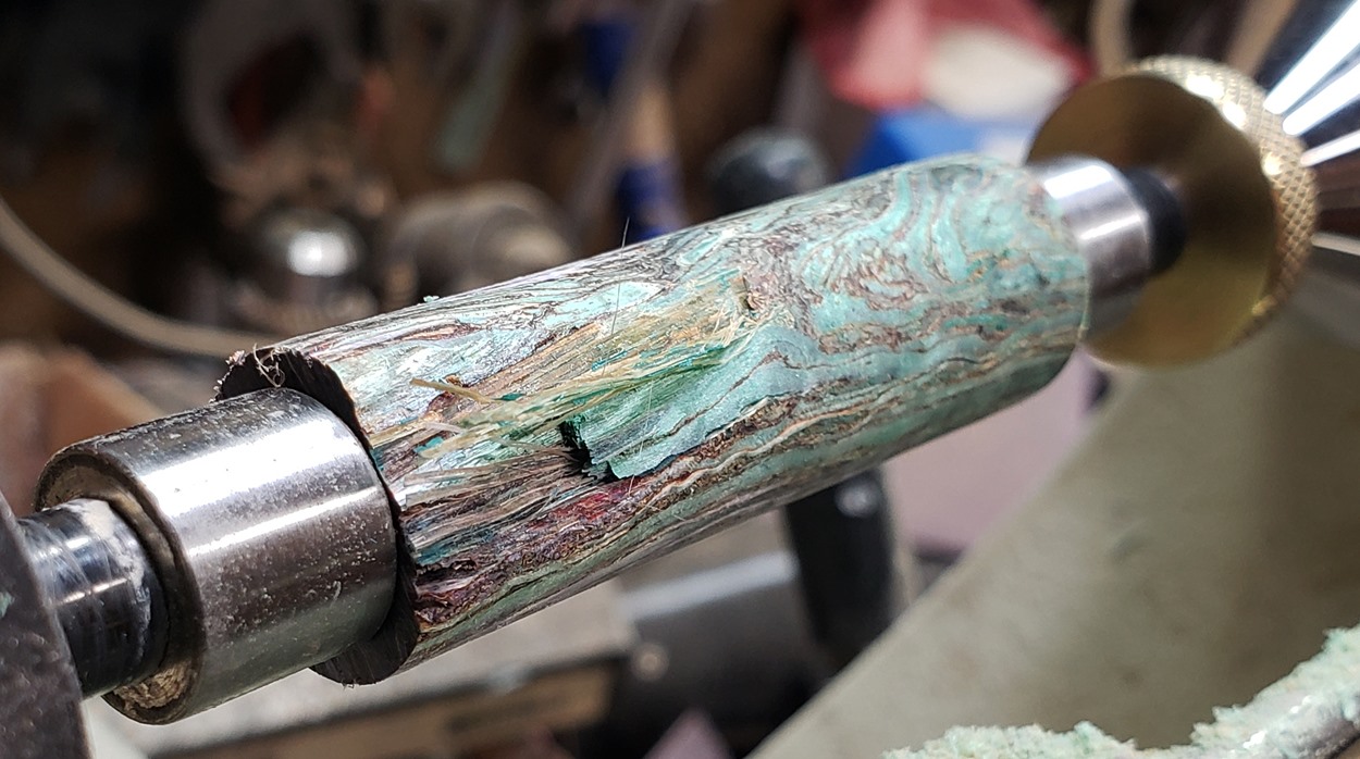

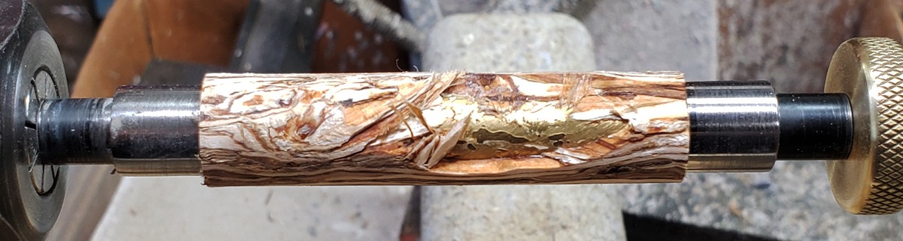

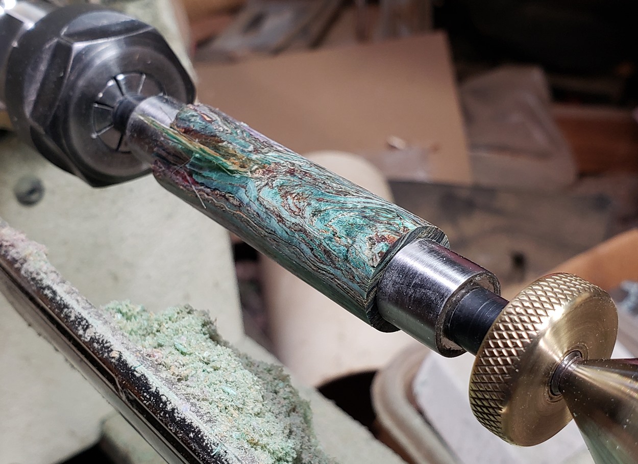

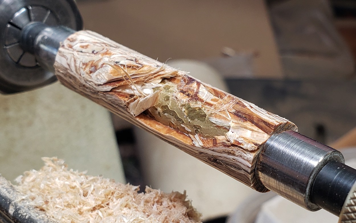

I haven't had good luck turning either unstabilized or stabilized hempwood. I refuse to turn it anymore. I use a carbide chisel with a shearing cut.

What is the amazing finish on it? The pen looks great and the finish just looks so deep!
Thanks! The finish is just CA. I use a thin coat to seal the surface, then medium CA to fill in the voids, then a couple more coats of thin to polish. The HempWood had more voids/gaps than regular wood. I use micromesh with water.

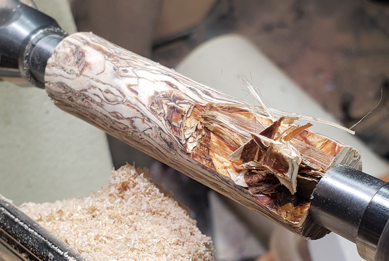

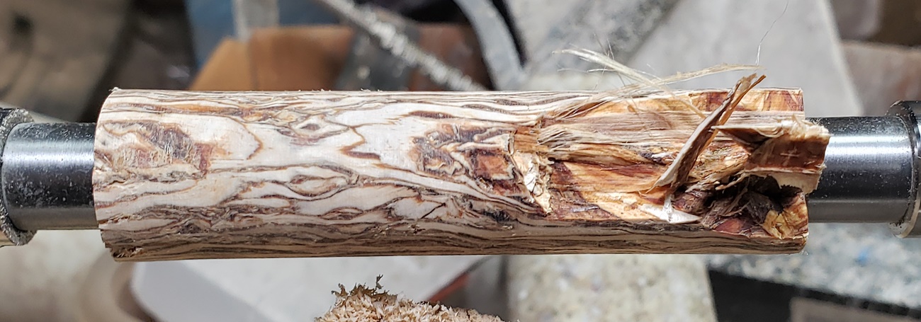

Thanks. I had heard how finnicky HempWood was to turn, so I went very slowly. I ran the lathe at 3500rpm and took very shallow cuts with my carbide tool. I ended up with a pile of powder instead of sawdust or chips. I stopped several times to rotate the cutter to a fresh edge. It took me about a half hour to turn, There was one point early on that a big chunk blew out, but I had enough meat left on the blank, so I kept turning and it ended up ok,

I like the look too. But at least one supplier offers stabilized hempwood. The green blank in my photos was supposed to be stabilized, but it blew out too. I hold my chisel at about 30 degrees, which has worked for me on everything else, even inlace acrylester.
