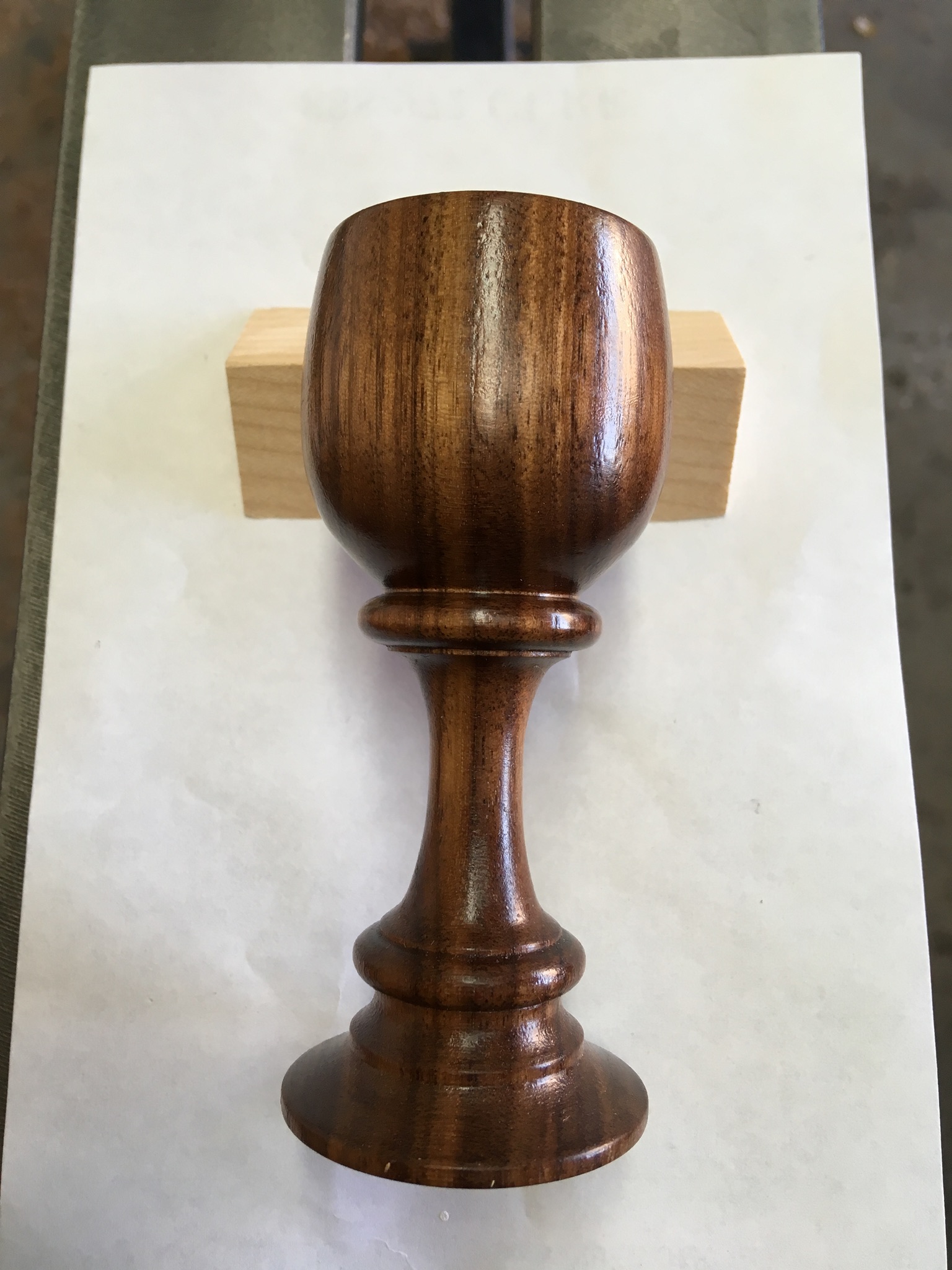

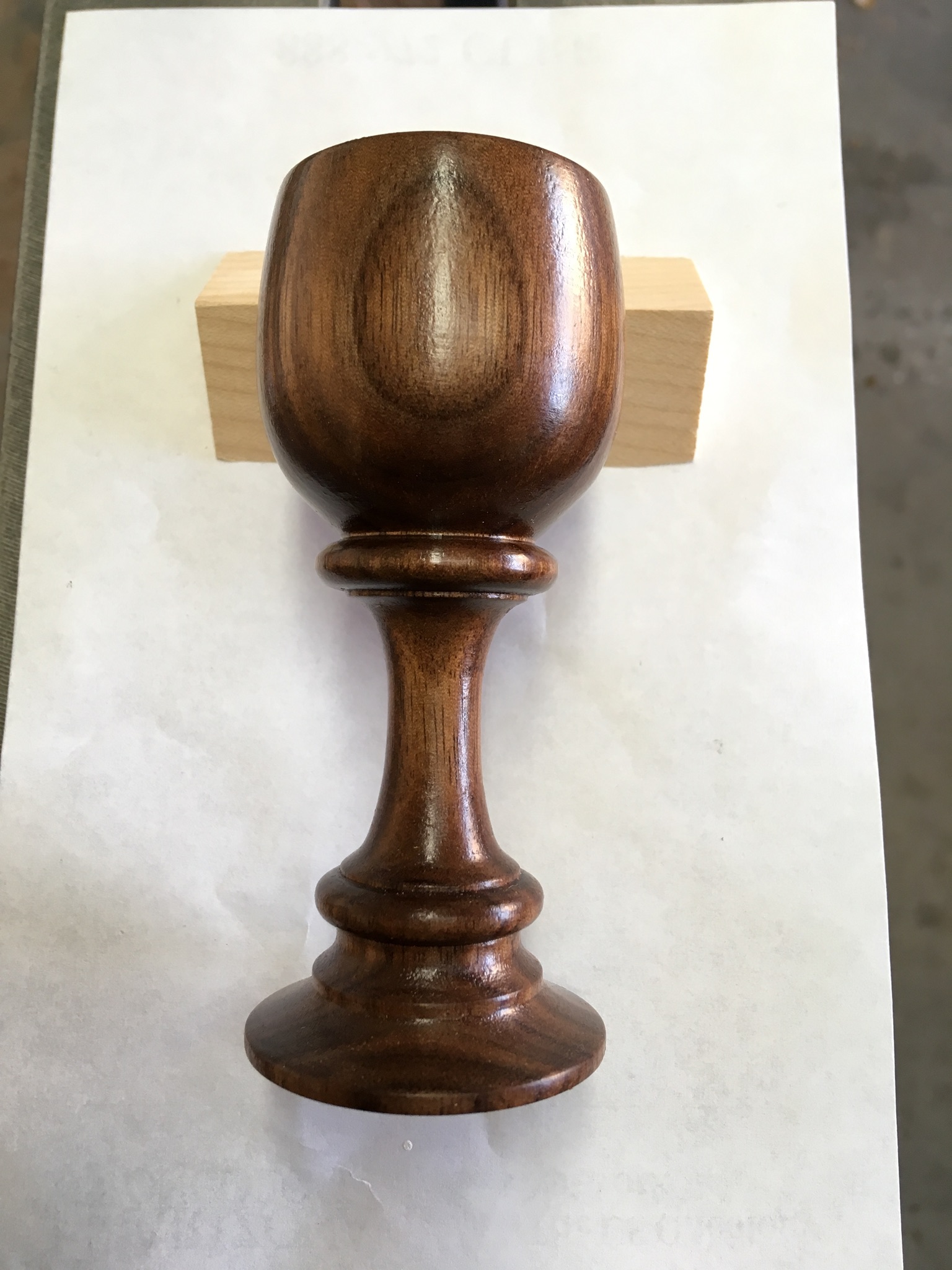

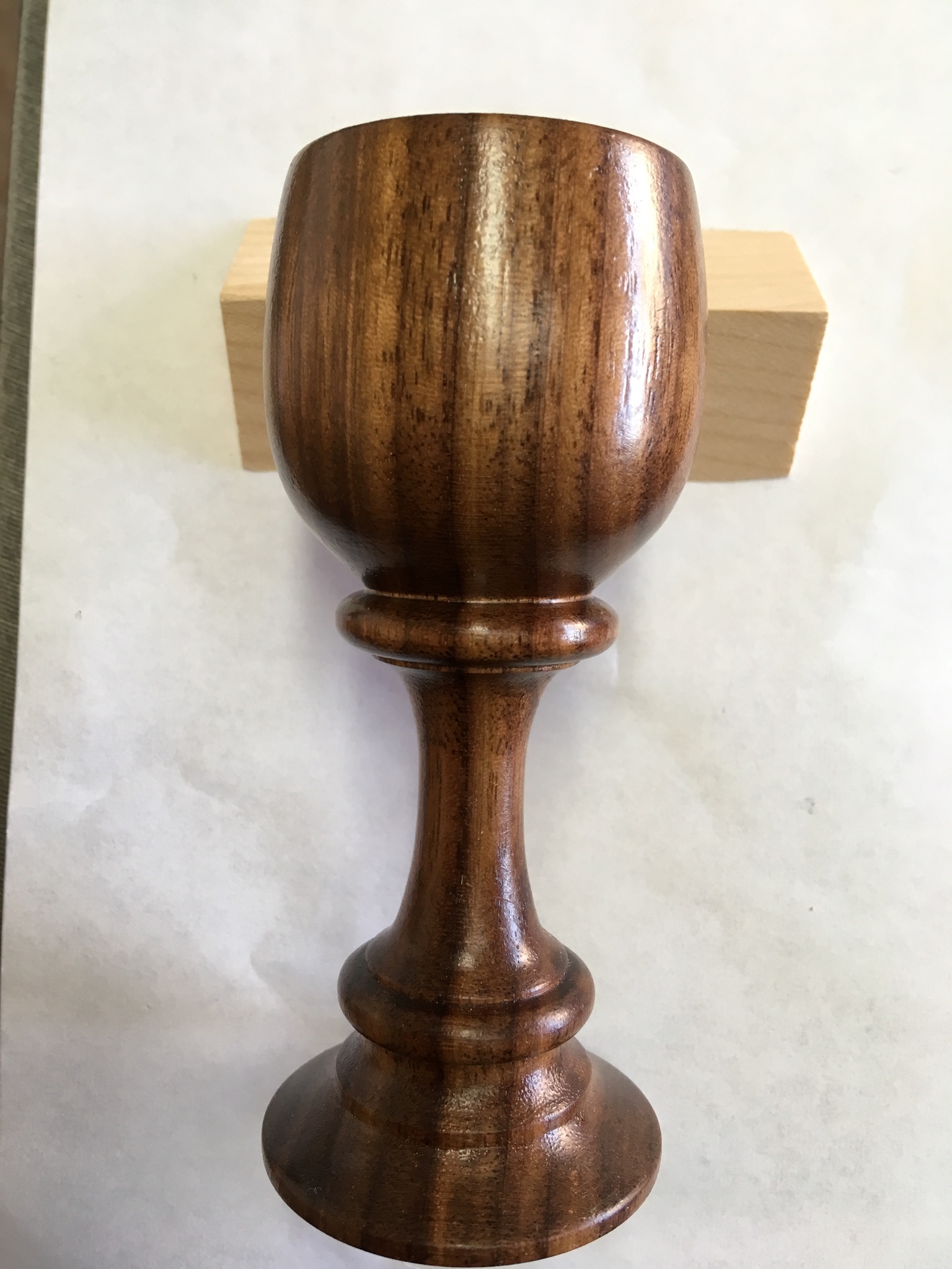

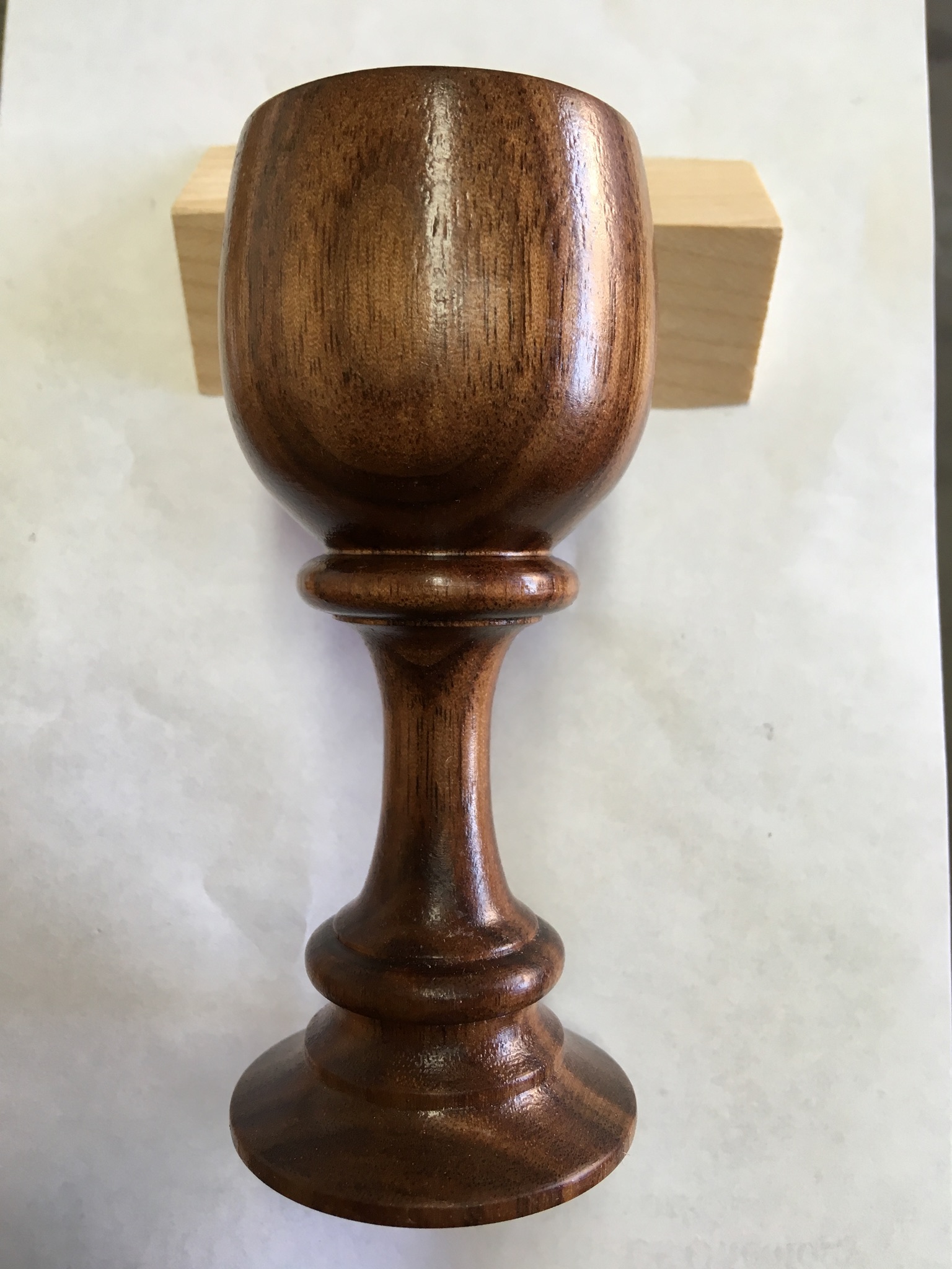

Far from perfect but I'm happy with it for being a first effort. Can anybody tell me what causes those light bands on the high point of the beads & cup? I'm thinking that a skew might given a better cut than a spindle gouge and prevented it.

Thanks for the replies. I don't think the pics accurately show what I'm talking about.
I have seen the same thing on some woods Jay, so will be interested in the answer. Some, mostly darker woods but not always, give a lighter colored band at high points in the turned wood ie raised rings or sharp transpositions. I'm thinking it could be something like micro-tearing of the wood but not sure.
Exactly what I was thinking, it's at the high point of the arc right where it changes directions from going up, across the grain, then down, and just the opposite at the low point of the cove. I'm thinking damage to the wood at the transition of the curve is the cause which is why I was thought a skew might prevent it.

I've turned a lot of walnut and what you are seeing in the "color bands" are the growth rings (early/latewood). This goblet looks to be cut with the end grain on top and bottom so the growth rings show up along the length not across. Sapwood (white color) on Walnut will only show up on edges or ends of a turned piece not thru-out. Nice look but nothing unusual.
