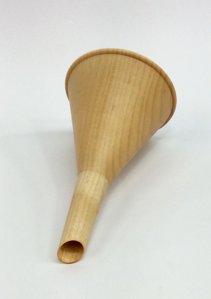

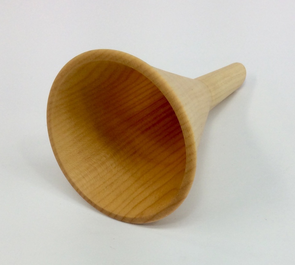

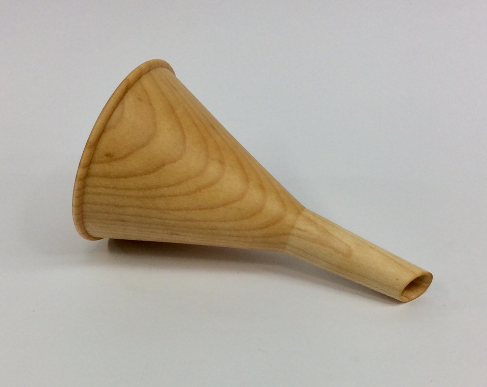

Yup, I turned a funnel.....for years at our club and on forums hearing of others turning a "funnel", I decided to give it a go...so here is my funnel.
This is turned from maple, is one piece and has a mineral oil finish.
2 5/8" diameter 4 5/8" tall

That is really awesome. Is it merely decorative or can you actually use it?
Steve, Thanks!....this is a functioning funnel. That is why I used Mineral Oil as a finish.
Originally, it was going to be part of an art piece but Wifey claimed it for the kitchen!

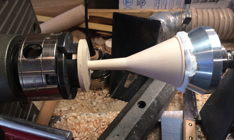

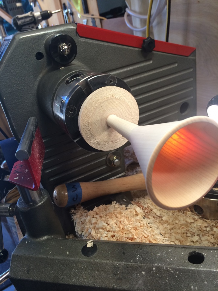

I only found one Youtube video....also,checked Google videos...only the one in which the guy is doing a funnel from a tree limb/ bark edge. Different from the video, I left mor wood on the outside/ neck area till after the inside was hollowed. Then I worked on the neck and finished the hole. I tapered the hole with sandpaper wrapped around a pen tube insertion tool.

Thanks Mike! ....Difficult? Nope. Just a little planning. The rest is turning and then sanding/finish

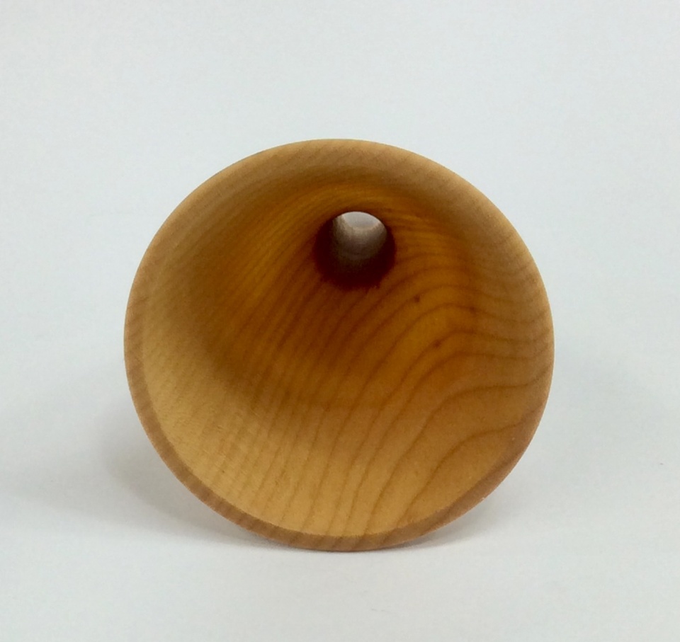

You can see from the pics that it got a little thin but at least the inside didn't meet the outside!:biggrin:
