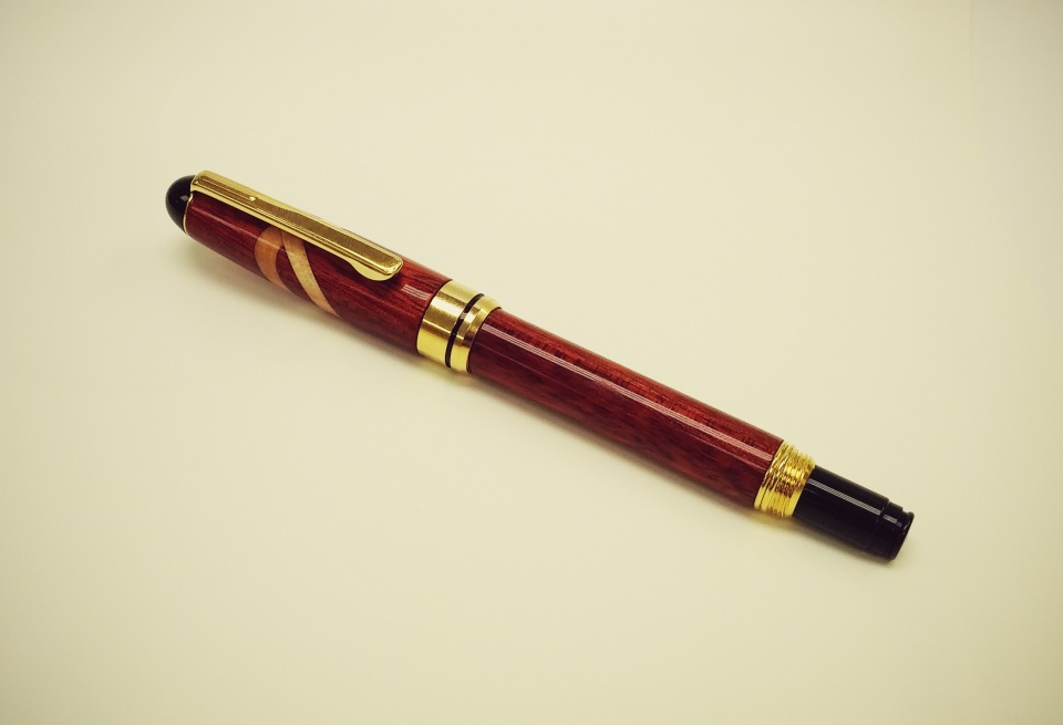

Also first try at a professional shoot.
Its part of a Pen and pencil set for my son's college graduation. Have to make the pencil tonight.
Hope I haven't made a faux pas by posting here first. I hate introductions. :smile:
Bloodwood with maple half celtic knot insert, woodcraft kit. During sanding it appears the bloodwood stained the maple but I kind of like it.

Congratulations on this pen! I think you did a splendid job on the knot as well as the pen and finish!
Please post a pic of the pencil too.
Also, Welcome from Virginia!
Great Pen "chartle"
Excellent, Half Celtic Knot Blank, Fit and Finish.
Look forward to seeing the Pencil.
Will make a Great Life Time Gift, for your Son.
Congratulations,
Brian.
You have turned a very nice pen, and will likely get grabbed by the addictive nature of this pursuit. I am not knowing what finish you are using, but if you use CA, there is a way to minimize the transference of color to lighter woods. It is very difficult to remove coloration from the maple without turning it away. Instead try to prevent the color from getting there. Those really good with the skew will not sand at all. I approach this challenge by sealing the maple with thin CA prior to any sanding, and reapply the CA quite frequently through the entire sanding process so that you are never exposing unsealed Maple to the red sanding dust (and dye). I expect you can use the same principle with whatever sealing finish you are using. Great work...keep it up!
Yes its a CA finish and I know about wetting it with CA before sanding or only using a skew.
I don't trust my skew work just yet and this was a gift for Saturday so didn't want to mess it up. So I sanded with 80 grit the last 1/32th or so to final shape. I was also rushing and it didn't even cross my mind.
Using DNA to clean it may have also helped to transfer the color.
I am going to use the CA trick on an inlay pen. My wife's voice teacher just got her PhD last week and I showed her the piano inlay kit at Rockler. So I'm forced :wink: to make her one, well really a pencil since that what they use day to day on their music.

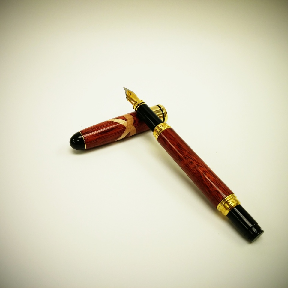

Didn't have time to finish my pencil, waiting for the epoxy to really setup for the inserts. So I finished the test pen I made to try out my half celtic knot by turning the bottom.

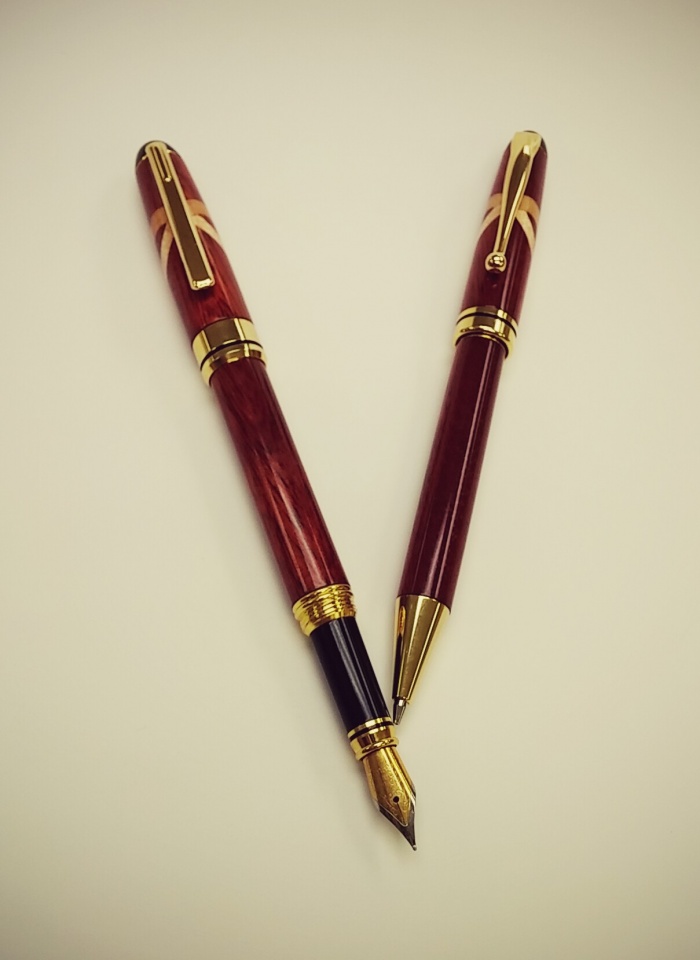

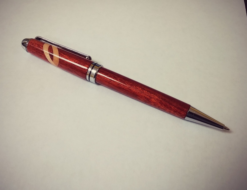

Ok here is the kit. Pencil didn't come out as nice as the pen.
I blew up (?) the first upper blank because I didn't have it fully supported as I drilled it. Had to make another.
Also the bloodwood hit some sort of soft spot on the maple and stained it more than I wanted it to. If I could get replacement 11/32nd tubes at Rockler I would get some. I didn't see any online but I'll check at my local store at lunch. I need a pen case and I can always use some of their $1.50 "scrap" bin blanks. :biggrin:
This weekend I'm going to make a light box so I can make better pics.
PS this is close as I could get in making a set. I know know about converting Parker kits but I had already bought these.
