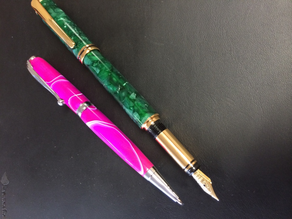

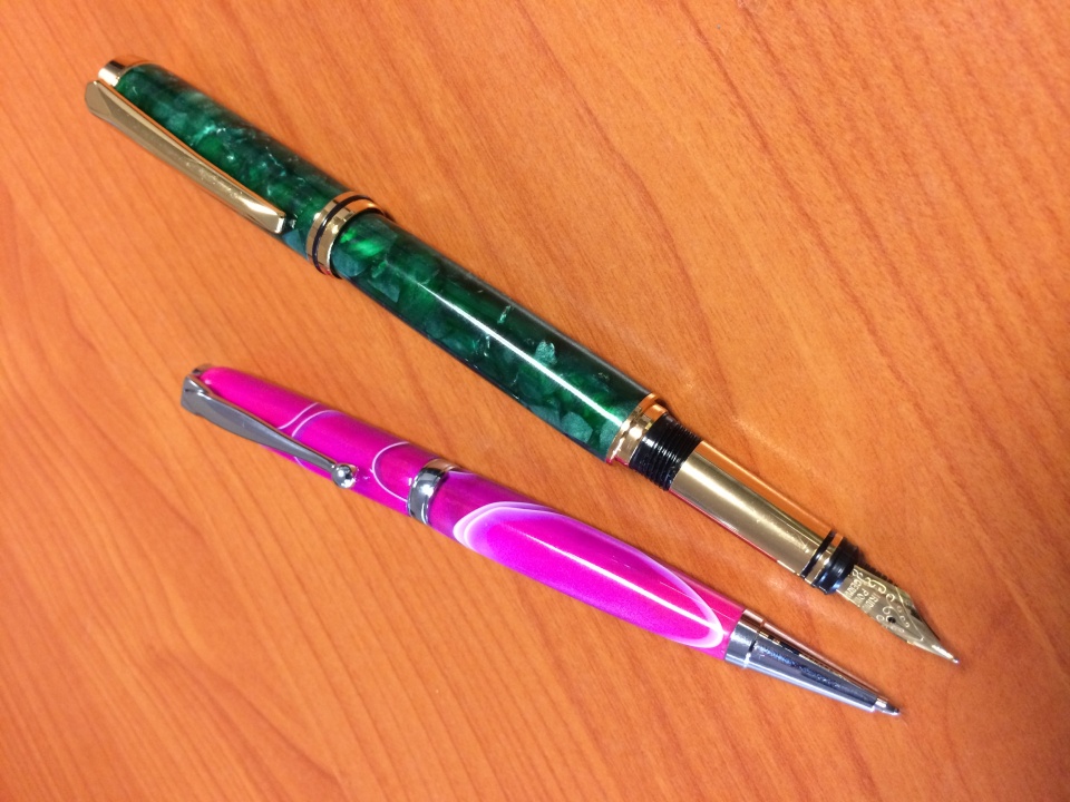

Good day folks - it's been a long time since I posted anything... Here's pics of an order for a client. He wanted a pink ladies' and a green gents' pen... Here's my pickings: Chrome Comfort with lavender acrylic reverse painted neon pink & Gold Jr Gentleman Fountain with Crushed green acrylic... I was nervous about the fountain pen - I have messed up previous nib-ends in the assembly process, but this one turned out good!
