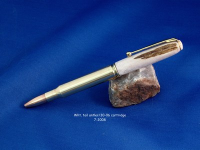

My first Cartridge.
See more from PaulDoug
PaulDoug
Mar 2, 2008
3,488
Benton City, WA.

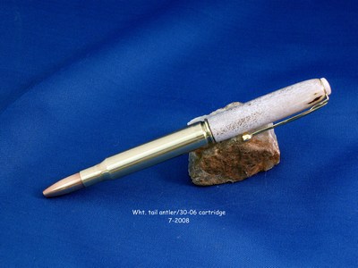

I just had to make one. Had some problems but got it done. The next one will be a lot easier. These cartridge pens are fun to show to people. They just go WOW!

Great job Paul! I too like the bark showing but like Steve said, it ain't so easy to get. I use a piece of clear plexiglas cut to the size of the top, about 1/2" X 2" with a line drawn down the center. Hold it up to the antler and mark the top and bottom, then turn the antler 90 degrees and mark again. Now "X" marks the spot. You can really see where you're gonna drill this way. It makes getting bark alot easier.
You wouldn't happen to have a picture of this? I think I know what you mean, not positive about the marking. Maybe if I made a piece of plexiglas I'd figure it out. Got to try it.

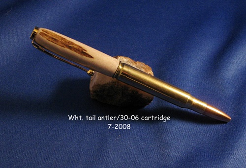

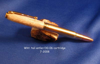

Just a quick update. I didn't like the flat brass finial on the pen so I made one out of antler to replace it. I like this better.
