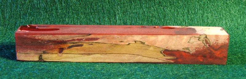

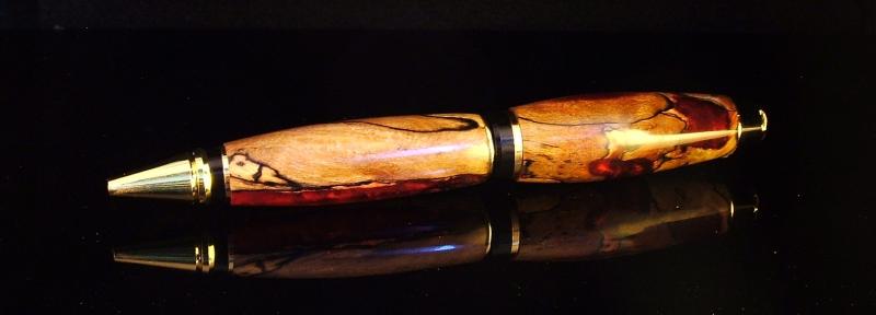

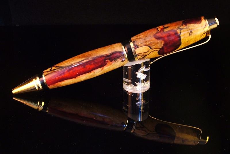

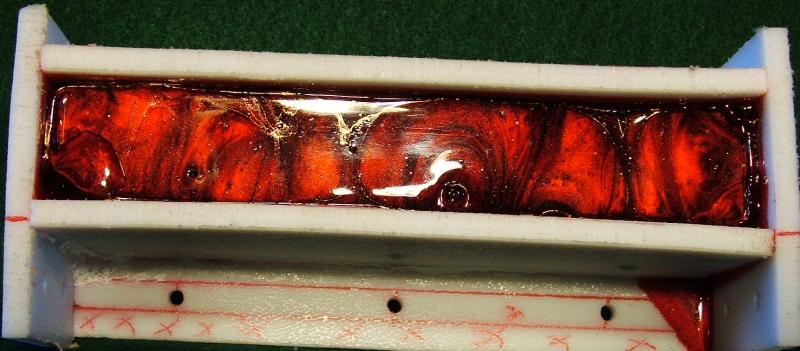

I would like to thank Curtis for his Tutorial on Alumilite, I must have read it ten times before ordering the Alumilite and another ten after I got it. I don't have a pressure pot "YET" (next payday) so I Red Necked it and improvised with PVC. It was a long 15 minutes hiding around the corner waiting for the bang!!:eek: (it held this time).:rolleyes: The wood is Spalted Cypress, the Alumilite is a 2oz mix, 40 drops of red dye and 1/4 tsp copper powder. Has a CA finish.
As Always Any Sugestions or Comments are very welcome.

Did you say 40 drops of red?? If so, you are using WAY more than you need! I use about 1 drop per ounce and get very rich colors.
Great looking cast, nonetheless!

I guess we both should have made things a little clearer...you did not say what dye you were using and I assumed you were using Alumilite dye!
If using Alumilite's dye, then 1 drop per ounce works well for me. If you were using something else, then I can not comment since I don't use anything but Alumilite dye!

You were right, I just pulled out the dye bottle (Alumilite) and it says UP TO 20 drops per oz. I missed the "up to" part. But it is great to know that I don't need that much, Thanks.

So it is Alumilite dye? Is it now coming in a bottle with a dropper of some sort? If so, that is great! I suggested that to Mike (the VP at Alumilite) a year or so ago and then just recently again when I was helping him with the Crystal Clear formulation. The old bottle was just a bottle that you open the cap on and the dye just blobs out! It is real hard to control how much dye comes out at a time so I transfer my dye to empty CA bottles so I can count drops.

It's the same bottle (1 oz size), but instead of taking the paper and foil seal off I just put a small hole in it and squeezed out drops. It is still very thick but controllable that way.

Now I am really confused.:confused: The last number of bottles that I got all said to use up to 5% by weight. There was nothing about drops on them. Now if the directions say up to 20 drops, do they tell you to just poke a hole in the foil for the drops or was that your idea?

The "Hole" was my idea, The bottle says "Use up to 20 drops of dye into1 oz of Alumilite's "A" side to completely color the resin. Use lesser amounts or in combination with other dyes to provide lighter or custom colors".

That is interesting. I wonder just how in the hell they expect you to use drops if they don't give you a method of getting the drops?
Also...just a suggestion...ignore thier directions about putting it in part A. If you do this, you can not tell when the resin is completely mixed. It is best to mix the 2 parts together first. When you first pour them together, they will be cloudy. When the swirls are completely gone and the resin is completely clear, then you have it mixed properly. Then add the dye. It will not mess up the ratio or cause any adverse effects. I do ALL of my casts this way and have done so for the last 50 gallons or so!
