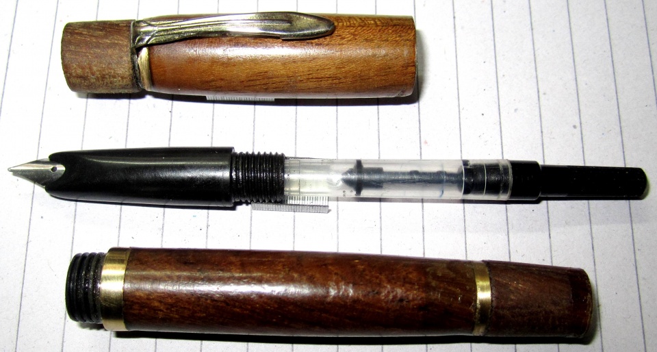

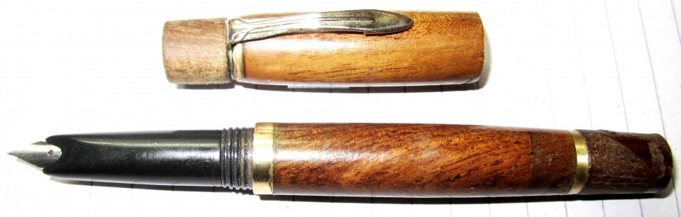

My first attempt at fully Kit-less pen
See more from sanyalsoumitra
Apr 27, 2013
261
Kolkata

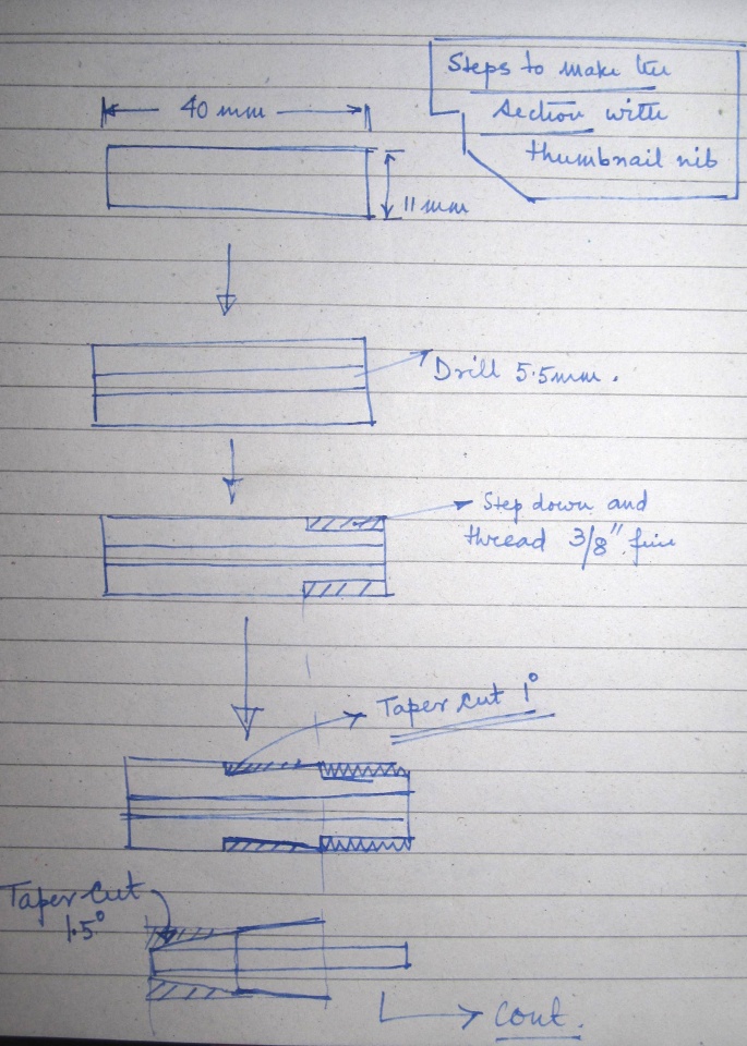

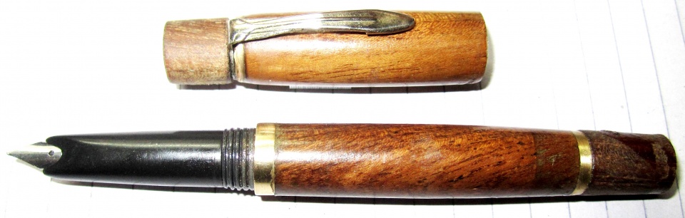

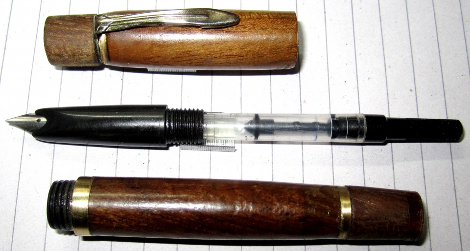

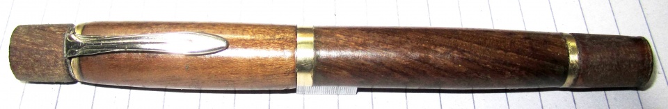

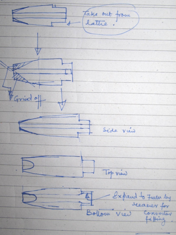

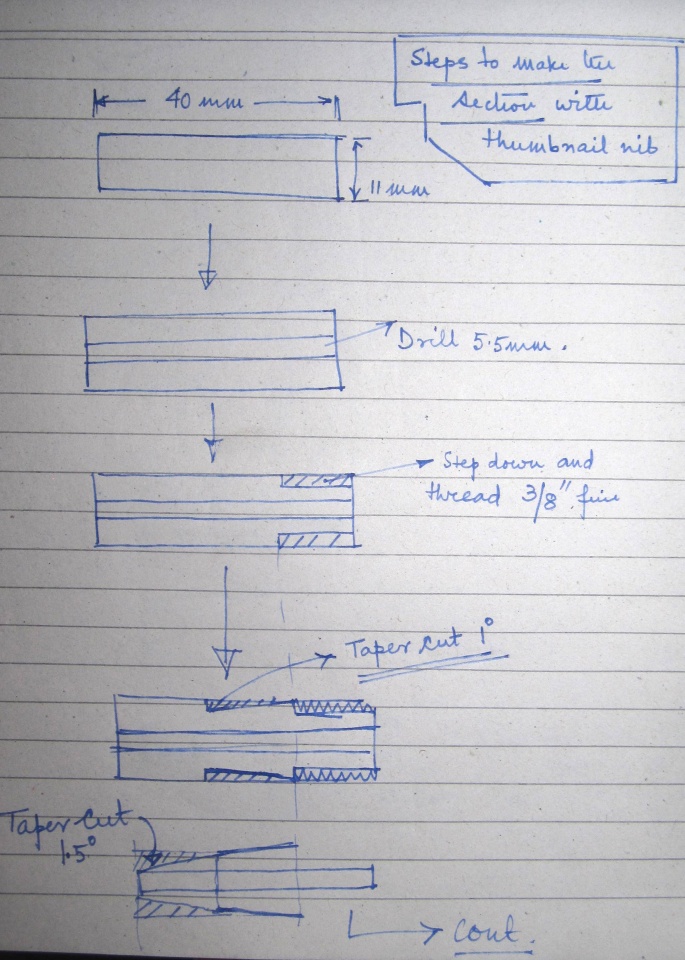

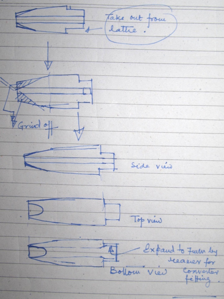

This is my first attempt at fully kit-less pen with thumbnail type nib section. The pen is not yet finished, end finials and final polish pending. The wood is local teak wood [ segun wood] with brass rings and ebonite section. Nib- camlin B nib. I am too thrilled that I could make it. Thanks for viewing, comments please.

Knowing how frustrating getting into kitless was for me, I would say you have sucess. I cant wait to see what you come up with next. Interesting design. Going with the hooded type nib on a 1st attempt - WOW.
