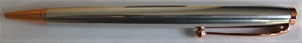

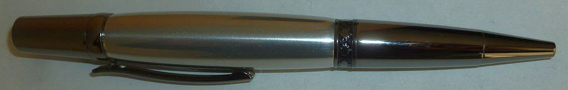

I came across an article which discussed using aluminum as a material for pen blanks. I thought that I would give it a try. The article suggested using epoxy to glue in the brass tube, which sounded sensible. However, I was fresh out of epoxy and used polyurethane instead. I allowed it to cure overnight and so far so good. Using a new material, especially something not like wood or acrylic, was an interesting learning experience. Firstly, extreme patience with drilling was very clear. Things get hot very quickly! Not sure if I need special drill bits for this? Trimming the ends slush with the tube also required patience as material is only removed slooooowly! Maybe I need to sharpen the trimmer. I use carbide tools for turning which I thought might be advantage with aluminum. Turning and finishing the aluminum was the biggest learning experience. Holding the tool at the right position so that it takes shavings and not just skip along the surface was critical. Typically with carbide you don't have to worry about that too much. I sanded to 600 to try and remove most of the tool marks and then wet sanded from 1500 to 12000, followed by some polishing compound. It produced a reasonable result but I think it can be better. Something for me to work on. Has anyone got suggestions on how to get a mirror finish with aluminum?

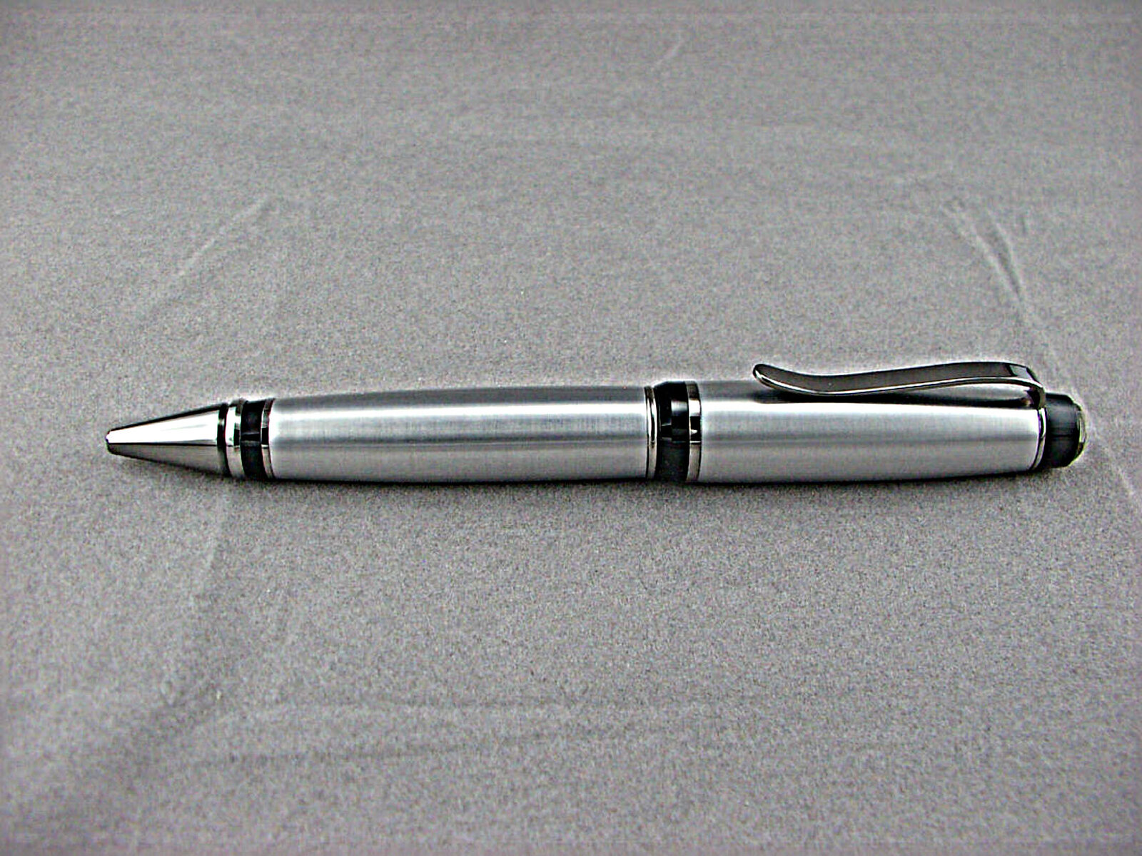

I have made a couple aluminum pens over the years and here is on. A cigar kit. I did not like the polished look so I just used a nonwoven pad to knock the shine back when all said and done. I think it hides the scratches a little better. I believe in using the tubes for it makes it easier to press in because the brass is softer and thinner. I epoxied the tubes in. One day I want to try a few different metals. On that long to do list.:)

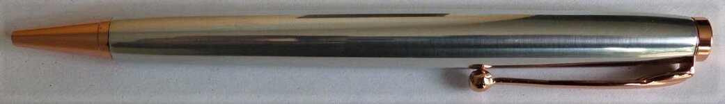

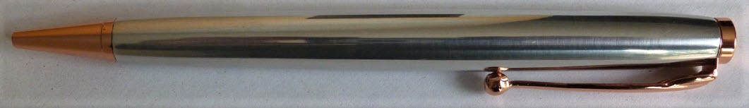

My next attempt is a single barrel slimline in aluminum. I tried copper plating and I quite like it. It gets the SWMBO approval :). For a quick finish after sanding to 600 I used 2 applications of Ultra Shine by way of an experiment. It came out not too bad but I think I need to experiment some more.
