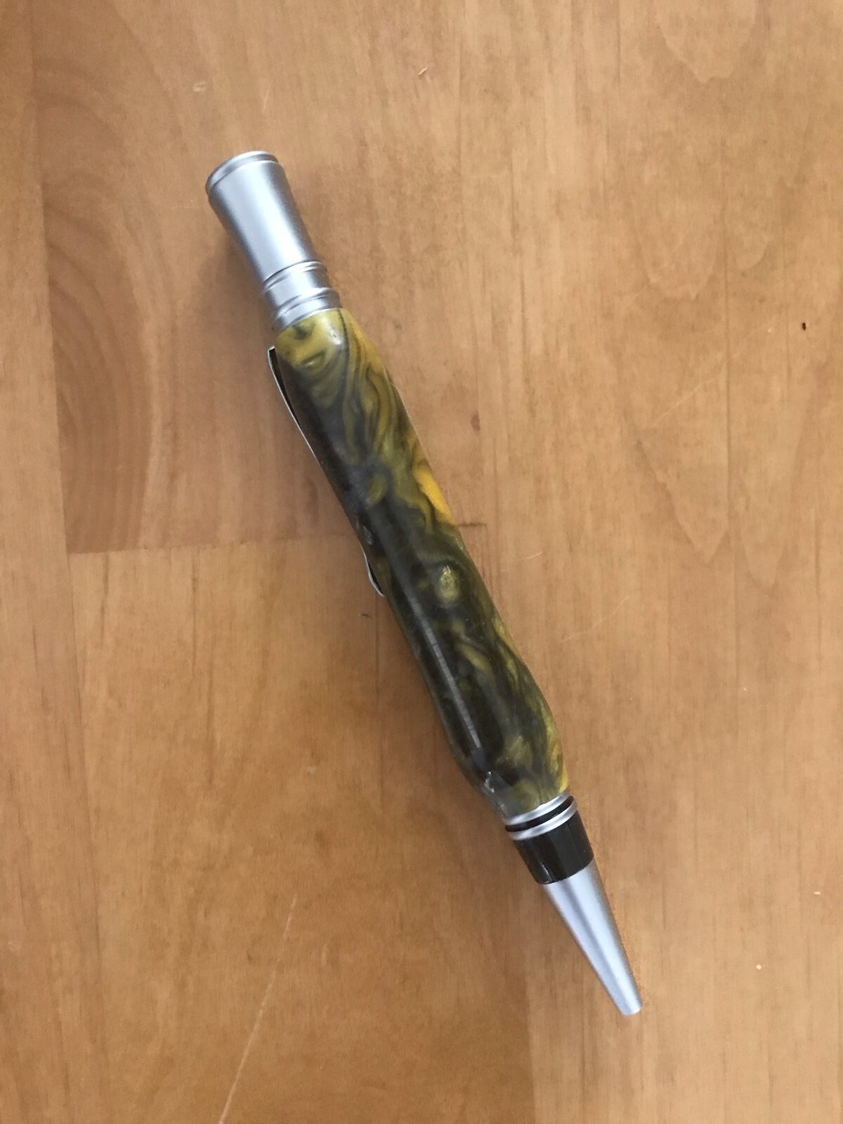

I took the plunge away from wood and tried acrylic. Broke my first blank but the second try came out pretty decent. Sanded down to 12,000 grit a f I can see my reflection in it!
Good for your first acrylic. I was so disappointed in my first one that I threw it away. Tip: After using sand paper, try going over it with micromesh. It will make it shine even more. Thanks for showing.

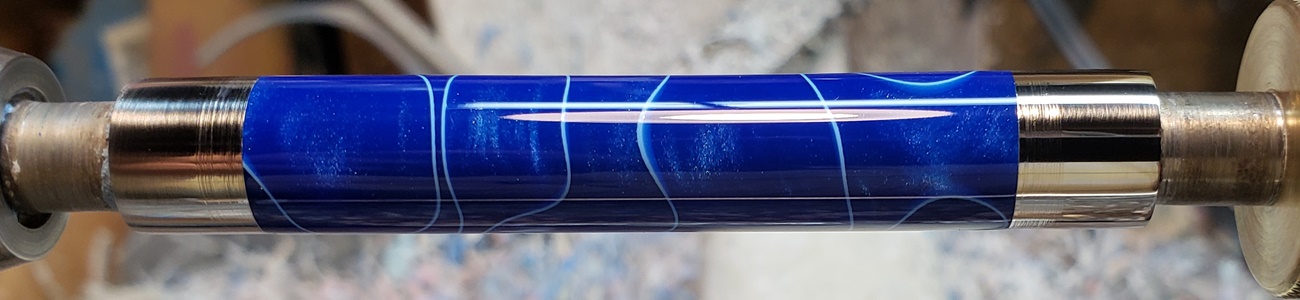

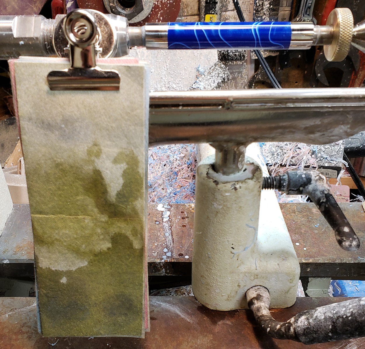

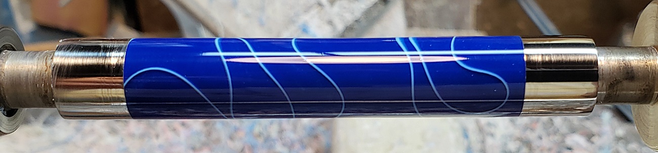

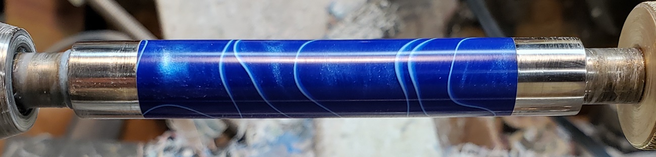

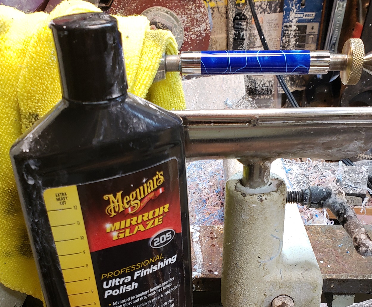

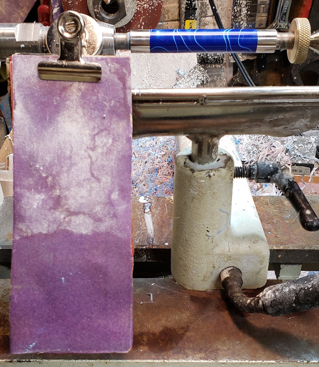

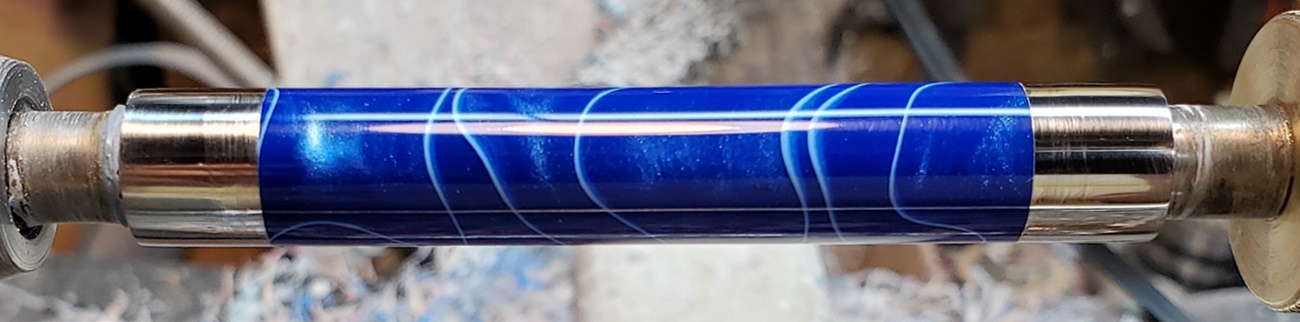

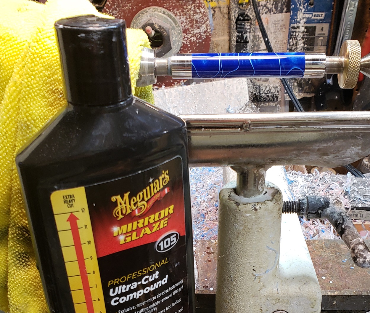

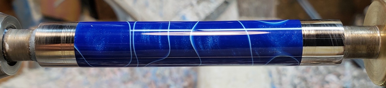

With all acrylics, I wet sand through 600 grit; then use all six grades of 3M Zona (aka Tri-M-Ite) polishing paper wet; then use Meguiar's 105 and 205 polishes with a microfiber cloth. I'm very happy with the finish I get.
