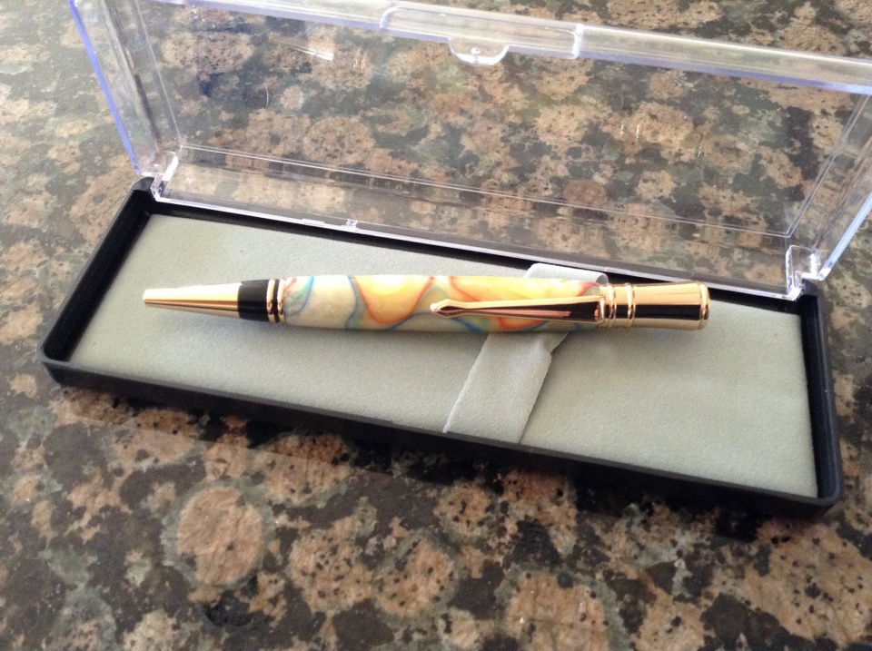

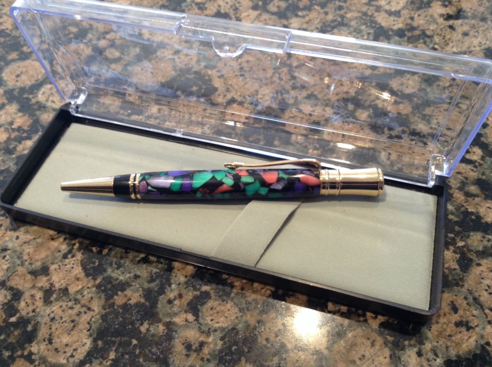

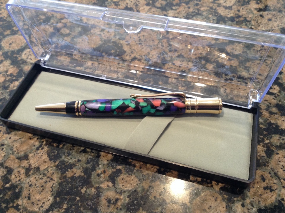

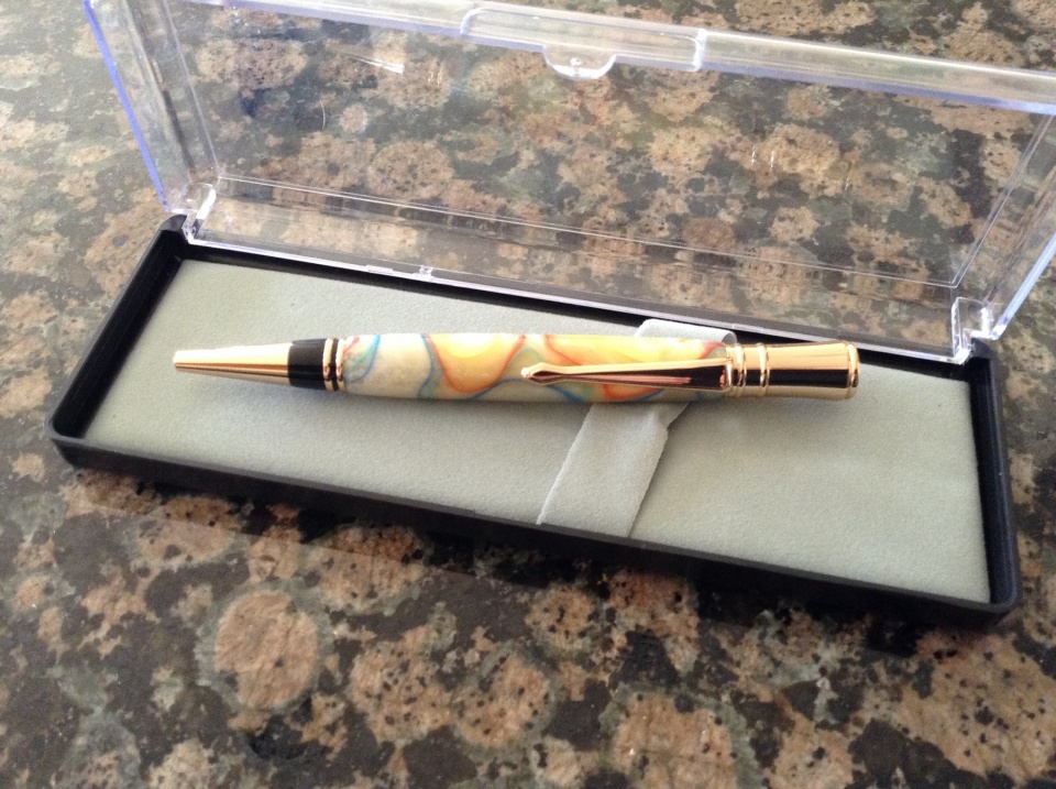

Here is my very first Acrylic Pen....It is the PSI Executive Pen Kit.

I like the colors of the blank in the second picture, and I think the barrel shape on both is excellent.
I made a pen with a blank similar to your first picture. I think the blank was called "candy coated" or something like that; my wife picked it out because she liked it and wanted a pen from it. I back-painted the blank white before gluing in the tube to avoid the brass tube affecting the appearance of the finished pen.
The brass color coming through the white (assuming it's white) in your pen coordinates with the gold plating, but if you use a different plating (e.g., chrome) and the same blank, consider back-painting the blank white. :smile:
Actually that blank has gold swirl in the white as that's not the blank. However, when I have done the slimlines with acrylic the brass does come through.
I have been thinking of getting various colors of model paint for the tubes as you have suggested. Are there any base colors that seem to work best regardless of blank....or is it kinda specific for each blank colors?
Personally, I like to use black, medium gray or silver, or as close to the main color of the blank as possible. I find that white tends to wash some colors out, or make them look like a pastel color.
Ah, my mistake in identifying the blank. I agree with what Bob said. The blank I referenced was white with pastels, so back painting white worked well in that instance.
