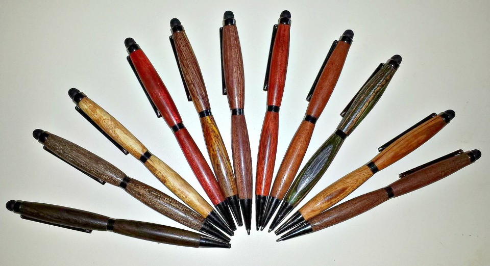

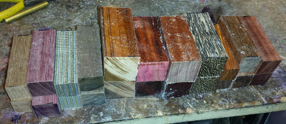

So I kept reading.. learn to use a skew.. learn to use a skew, so today was the day. I had a commitment to make 11 pens for gifts, oh and my wife is the customer. I decided to just use my skew no matter what. I have to say, it is awesome! I know my sanding time is cut at least by 75% and the smoothness is better and so is the finish. Looks like the skew is my new favorite tool!
The kits are all slimlines, as the prettier half wanted. Of course now I have to try and figure out what kind of woods they are. Most came from gifts or grab bag type of supplies. Any clues would be helpful! lol

They look good! I can't help with all the woods, they are not in the same order.
But I have to say...today I did some extra sharpening to my skews and I was impressed.
I think I need to sharpen a bit more, but I really want to learn to use the skew more myself. A little difficult going left handed though for me so far.
The pens are looking great. I too read skew, skew, skew. Perhaps time to give it a try. I have a mini skew but have never tried it. I'm looking at a 1/2" skew. I have other mini hss tools but do not use them as I have no means of sharpening them.
Well , the second wood is purpleheart , the 3rd is a laminate -Dymondwood or equivalent , the 5th might be zebrawood and the 8th looks like black palm . The 9th pen appears to match the 3rd blank , but matches to the others are not so obvious . Purpleheart turns as a brown until the exposed surface re-oxidizes . Black palm is very difficult to turn , and none of the pens seem to match it . Best I can do with any degree of certainty .
