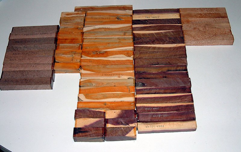

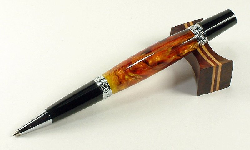

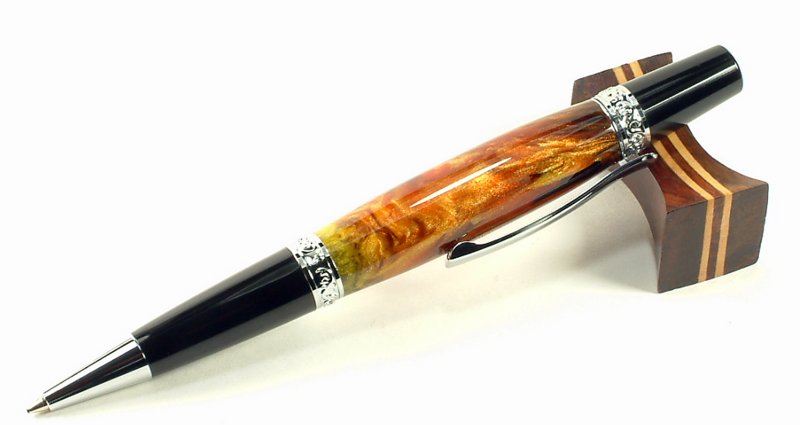

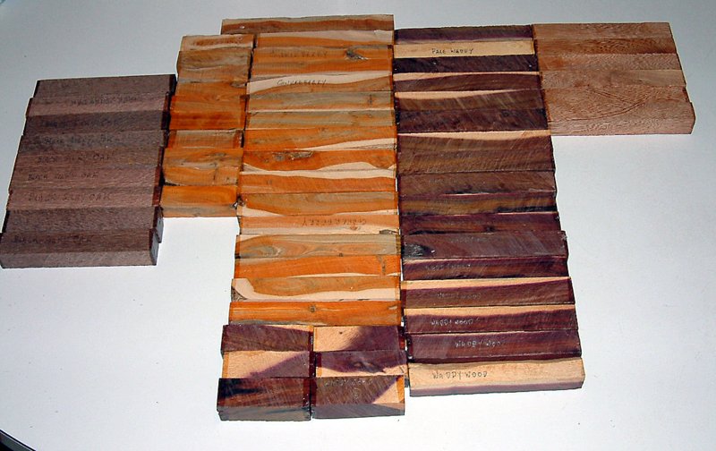

Morning here in Australia Pat.

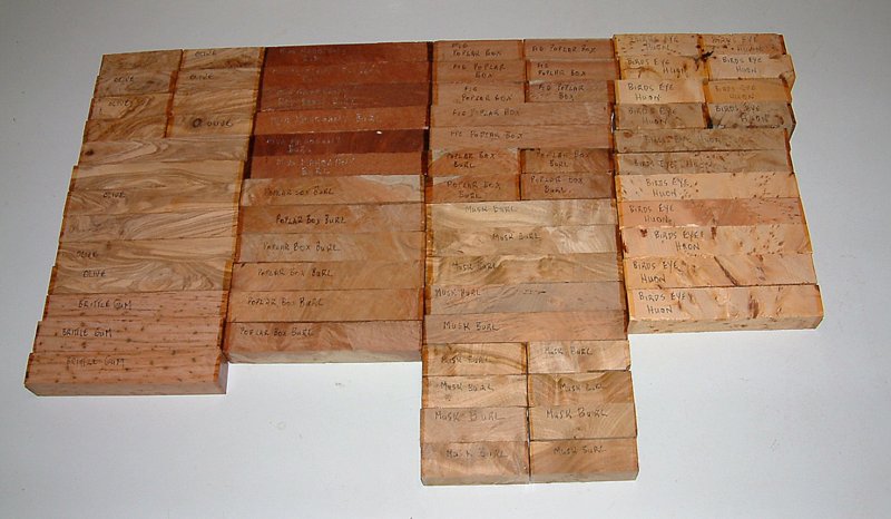

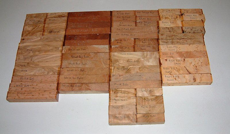

I use a Fuji Fine Pix S602Z please find enclosed four pics taken yesterday of two sets of pen blanks of Aussie timbers I just purchased that arrived yesterday and two pics of a pen I received from the USA made by John Walsh for me that also arrived yesterday. I regard my camera a few years old now as perfectly adequate you be the judge. If you send me a pm on this forum with your E Mail address I will send you some pics of my set up which takes me 5 to ten minutes including taking the pics, indeed the pics of the pen blanks are direct flash on the camera using our kitchen table. I use contrary to most an open box flurescent lights have shown this set up many times on this forum. Since you are new to the forum I am prepared to converse with you privately. Remembered sometimes I take a pic of an 40 yr old Kodak test pattern and yes this was taken at the same time yesterday. Now I dont go to huge lengths regarding the pen as the important part of the exercise and when you get to be 79 as I turned last week you tend to have a huge number of interests that need attending to.
Kind regards Peter.

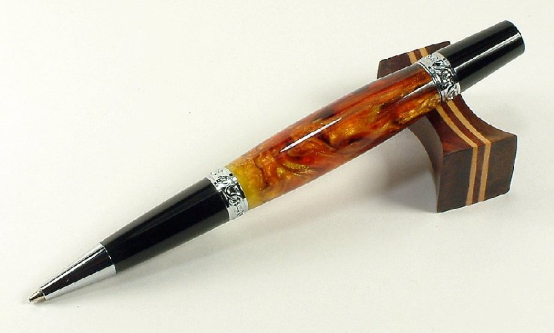

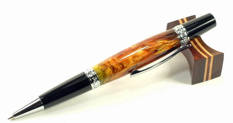

You can't get any simpler than how I take my pictures. The camera I use is a 5 mega pixel Lumix FX7 compact camera usually set on macro, but not always. I don't use any additional lights except what Mother Nature supplies. All my pictures are done on my patio table and only use the sun as the light source. The trick is to pick an overcast day so that the light is quite flat, that way you avoid the strong directional shadows. You are looking to capture a good tonal range, you can then give it a tweak in an image editing software if necessary.
All the pictures below are all shot in the above manner. None of them took me more than 10 minutes and that's for 10 to 15 shots off each pen.
Wow, those are super sharp pics you got there and I particularly like what you have done with one of my Banksia Hairy pods Resifills, come up stunning, that finish is superb.
