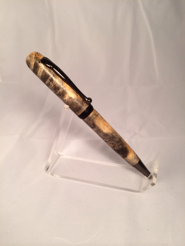

1. Buckeye burl closed end modified slimline

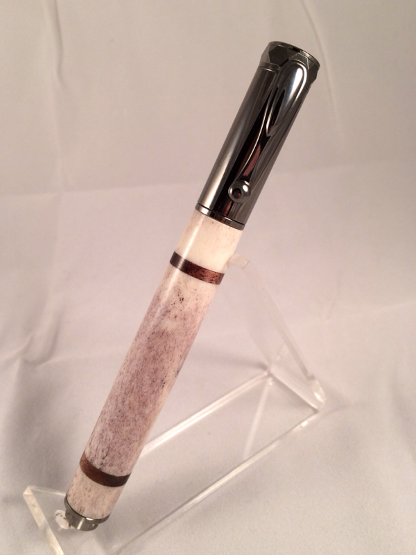

2. Zen with deer antler and walnut bands.

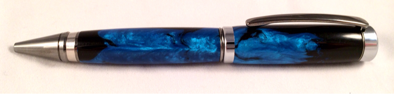

3. Modified cigar with atrax parts and jr gent clip. Brooks blank.

Very fine work all around. I'd like to know your process for securing the clip on the modified slimline. It looks like there is no seam there, so my best guess is that you trimmed off the ring part of the clip and secured the remaining tab in a slot on the upper barrel. How'd ya do that? How'd you machine that slot? It looks like that piece of wood has that clip growing right out of it.

Beautiful Buckeye Burl, with excellent closed end. Regretably your phototgraph, doesn't show the entire pen clearly.
Love the Segmented Antler, Terrific contrast with the Walnut, Superb fit and Finish.
Spectacular modified Cigar and Outstanding Brooks Blank.

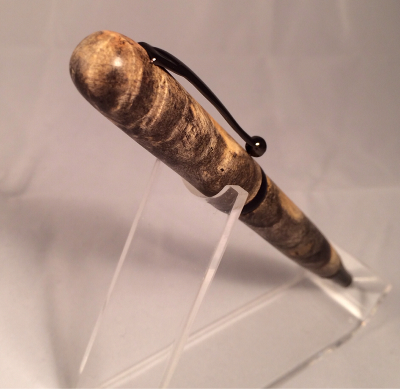

It was my first try. You basically nailed it. Drilled a tiny hole. Used a piece of coping saw blade to extend the hole. Cut down the clip ring. Used some ca in the slot to secure then more down the tube. Surprisingly strong hold.

I posted another pic. My photos are sonewhere south of mediocre bit have a real camera. I regret not putting a real ca finish on the slim rather than the satin polish of the stabilized buckeye.

Maybe it's just my eyes, but it looks like you aced it. I don't see anything that resembles a drilled hole or reaming with a coping saw blade! I'm going to have to try that when I get home.

The hole is not perfect. It is a little but too wide on the right side. Not anything bad, but my pics hide it.
I'd like to try the method is using a thin wood burner tip once I get one.
