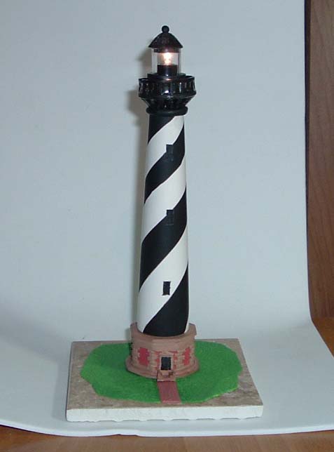

Someone at work got me interested in the Cape Hatteras lighthouse so after reading up on it I decide to try this.
There are brass tubes in the column center, a small plastic tube for the lens and a mini flashlight in the tube to make it light.
Looks even better in a dark room.
All the rest is polymer clay.
There are 2 others from that area of the coast that I may build.

Jim, it is 7" tall to the very top and about 6" to the light.
I proportioned it based on the measurements of the real one and it is about a 1/420th scale. The stripes were the most challenging part. 4 stripes, 2 white and 2 black and they wrap 1.5 times around. My measurements were a bit off and not all of the stripes are the correct width on one side...but it is close.
3 windows on the side above the door and 4 on the back staggered from the front ones. Also the reddish stone behind the oddly placed brick like stones stacked on the corners of a hex shaped base. Needless to say there is more going on here than meets the eye.
I'm not too happy with the way the railing turned out and I may rework that. The top part is the same basic shape as the next one I will build which is the Cape Lookout lighthouse.

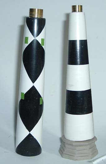

The one on the left is marked for windows and has many hours and one redo involved. I also discovered that there was no math that I am familiar with that could solve the layout. It was trial and error!
The one on the right was the easiest.
On that one I put the white stripes on and when cured and cool, put it on the lathe and trued up the joints. Easy!
Now it is a matter of many more hours finishing the details.

Jim, the issue is a lack of statistics on the actual lighthouse. I find the base diameter and top diameter, sometimes, and the height in reference to the high water tide!
The rest is a guess. Looking at the actual one you see that the diamonds get slightly smaller as they get higher. The diameter gets smaller as it rises too. What I did was tape a string from the base to the top at 1.5 turns, then drawing a line where the string lays. Then do that 4 times at 90 degrees each. Then transfer one of those sections to a piece of stiff paper and make a cutout. Make 2 of them and tape them in a criss-cross fashion to get the diamond effect. That got me real close. Then I cut out the white ones and stuck them on the base and heat cured them. Then a touch-up with a file to get the edges straight and lined up and some fill-ins were necessary. Once the white ones were set it was easy to mark and fill in the black.
Cure it all good and turn it even with a skew. Some more touch-ups and done.
