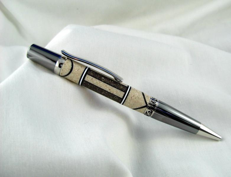

After seeing the beautiful job that Kaspar did on that "Redux" blank I was inspired to give it a shot. I went with Corian and some pickguard and black styrene for accents just because it was what I had laying around. This blank was by no means friendly to me. After all the time it took me to put it together it blew up on me when I was half way through turning it. I lost the two wedge sections at the one end of the blank into my dust collection system. I came up with the idea that if I turned the section from the pickguard to the end of thh blank down to the brass tube I would be able to glue a new section on. And it worked, until I got down to almost finished diameter. My skew caught and flipped out one of the wedges again. This time I didn't lose it and was able to re-glue it in place. Didn't take a chance on putting a tool to it again. I wet sanded it to size and then used plastic polish. Dressed it up with a black ti and platinum Sierra Elegeant Beauty. Thanks for the inspiration Kaspar! Jeff

Lets see if this works Jeff.....I had him e-mail the photo to me and I uploaded it . Sure is sweet looking....

Thanks for the help Roy. Posting this pic was almost as much trouble as the blank caused me!!Jeff

I think I have to agree that the white layer is a bit bright for all those corian tones. But, still it is the best looking segmented corian pen I ever saw. It's not easy chopping up little pieces of corian to begin with. Very nice!
Nice job. It is all to easy to try and get intricate and loose the balance of the design. you did a great job on this one.
