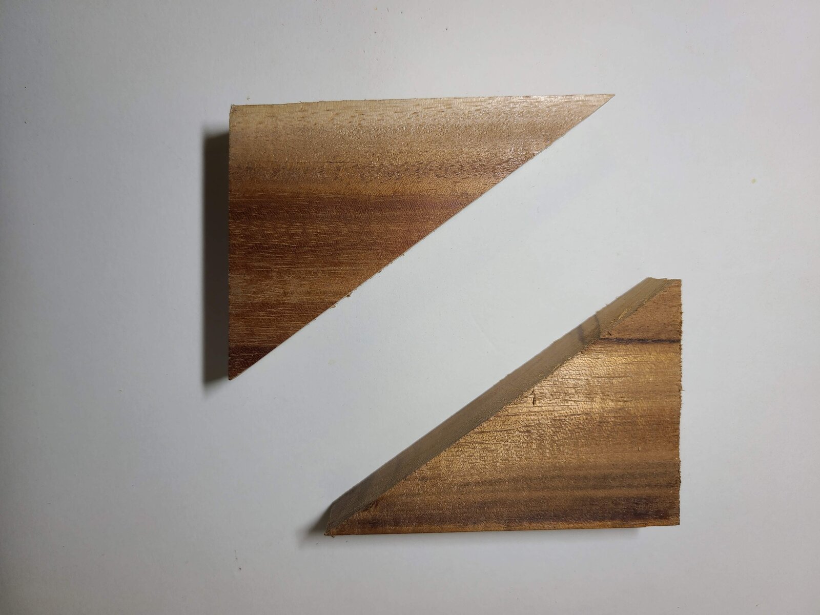

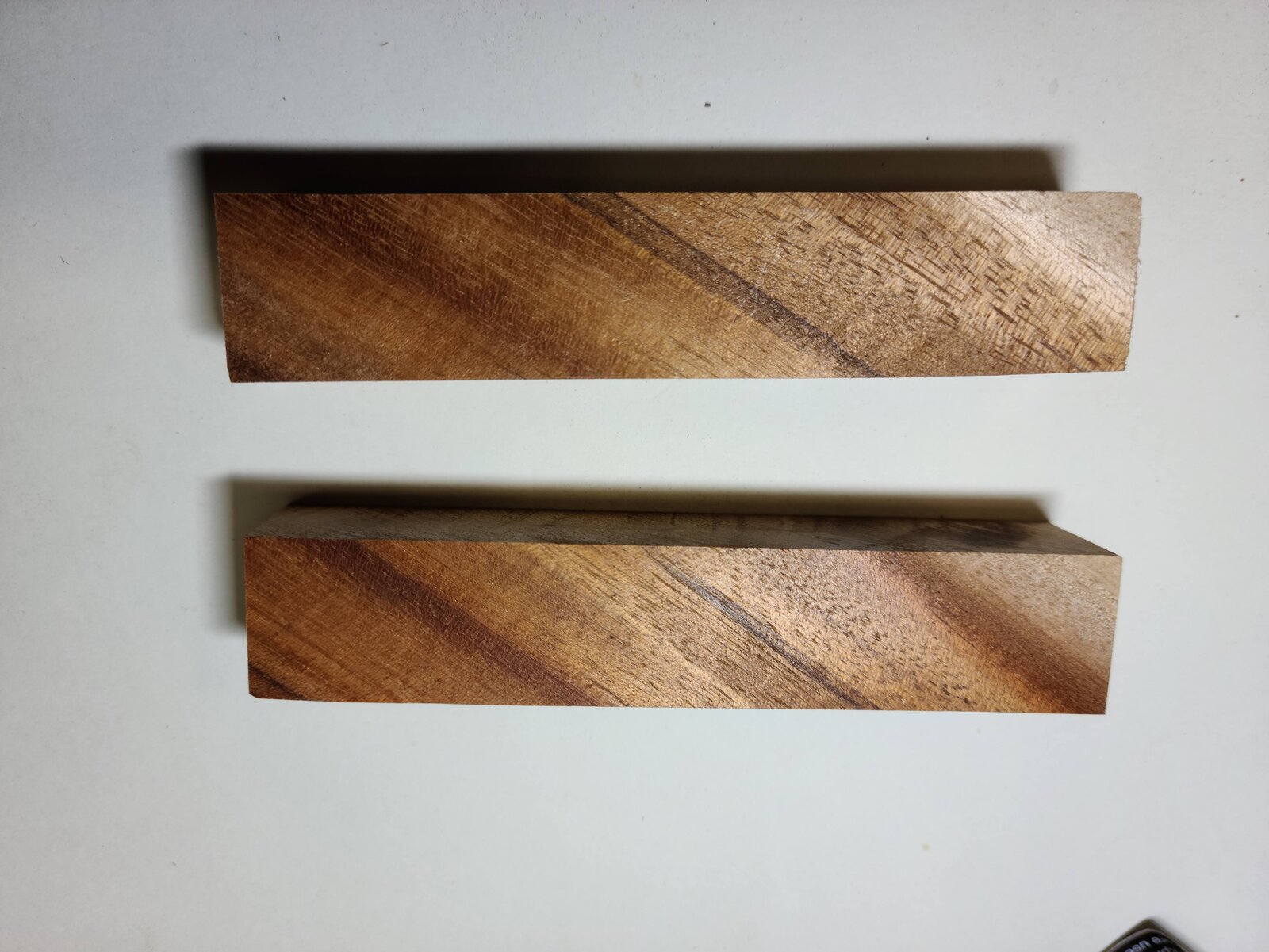

I wish I could say that I puzzled for hours/days searching for the ideal pattern for this pen but alas I did not. I wasn't even looking to create this blank, It came from a lucky confluence of events. I had purchased a board of Goncalo Alves that had a very nice color difference across it's width. I decided that I would create some bias cut blanks that would show off the color shift. These are a couple of the blanks and what is left of the board.

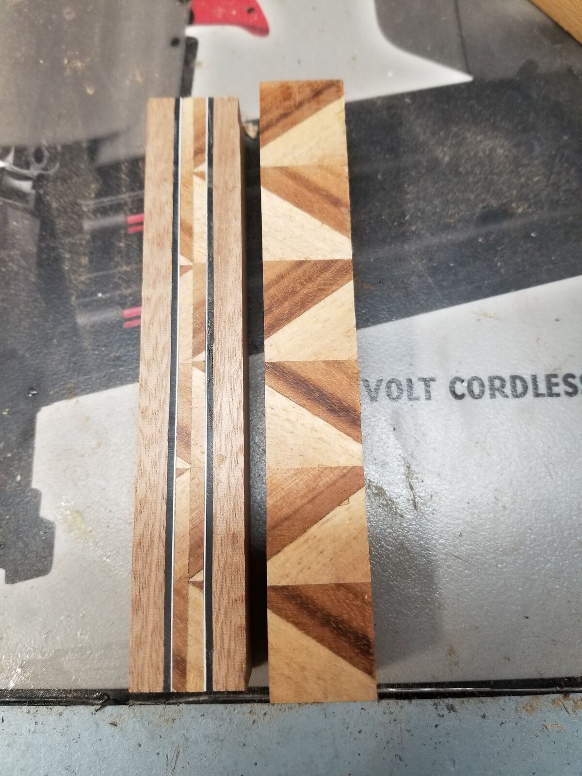

After I squared up the blanks I had a bunch of these angled pieces left, not one to waste anything especially because I enjoy segmenting, I decided to glue them up to make an angled blank. I then trimmed the blank to size by cutting the points off each side, then it hit me! I turned the points on each other, glued them together and had this great art deco type pattern.

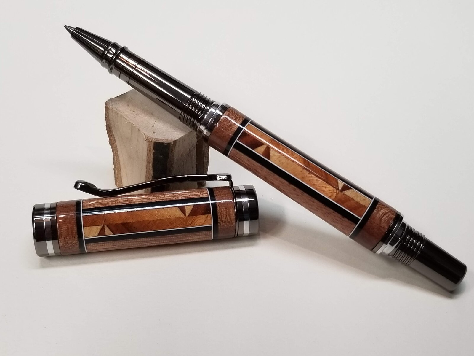

I framed the points with black/white plasticoid and completed it with Sepele to continue the art deco feel. Turned and CA finished on a chrome and gunmetal Kojent kit from Woodcraft. This pen has become my everyday carry, It was a lot of fun to make.

OK, so you did put a lot of thought into making this pen.....once you got started. It's an interesting combination of materials that resulted in a great looking pen and is a tribute to your abilities and experience. Glad you made it and entered the contest.
It was my top vote. I like what you did. I liked the details in the angled pieces that may have been overlooked. They were subtle but segmented none the less. Nice work.
Beaut pen .... one of my choices !

I really like this pen, I was wondering how you made the small triangle inlays. Very creative. Thank you for sharing.
