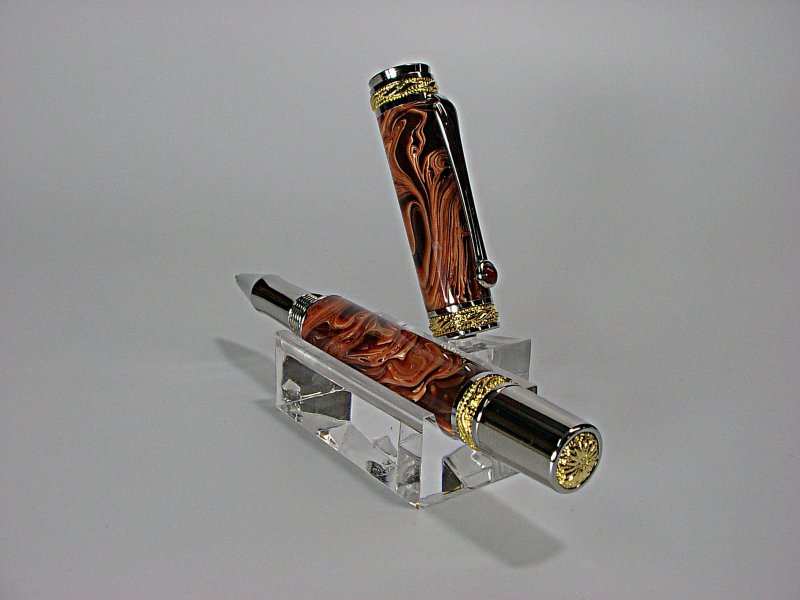

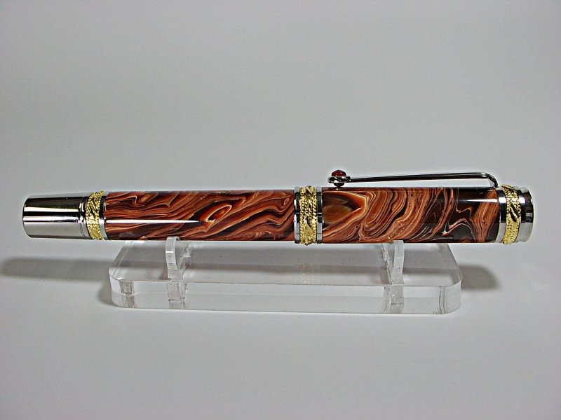

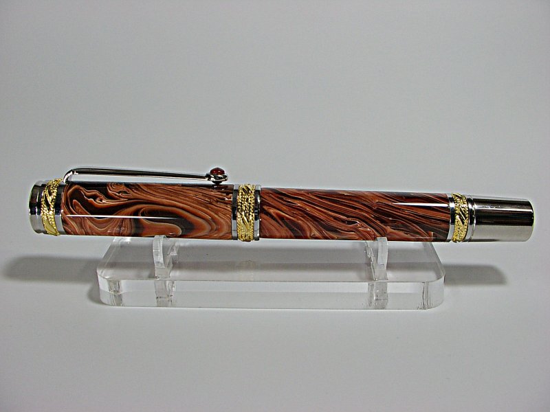

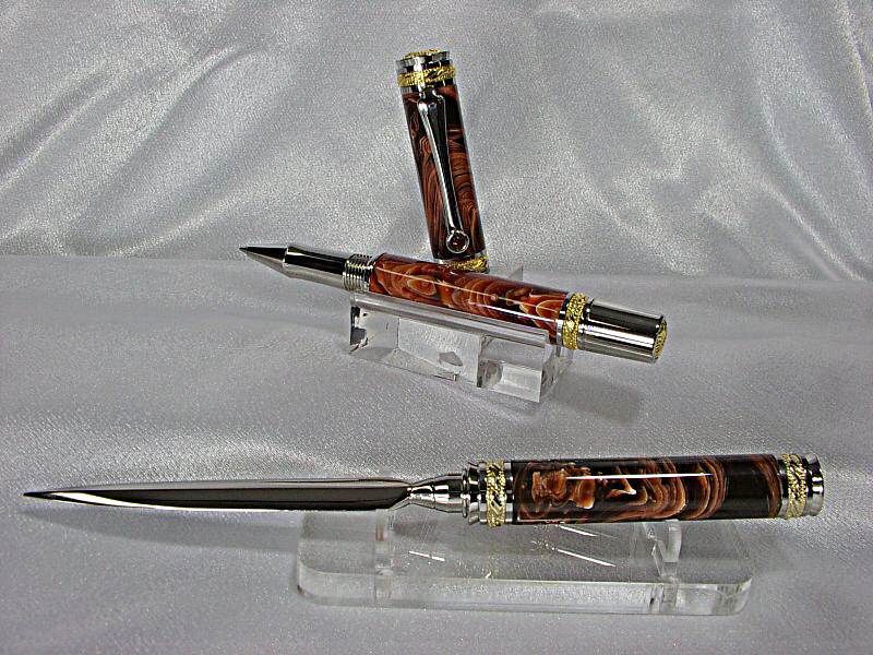

This was my entry into the new Pretty Resin contest. Unfortunately is was disqualified. I misinterpreted the rules wrong. Things happen as they say. :biggrin::biggrin:

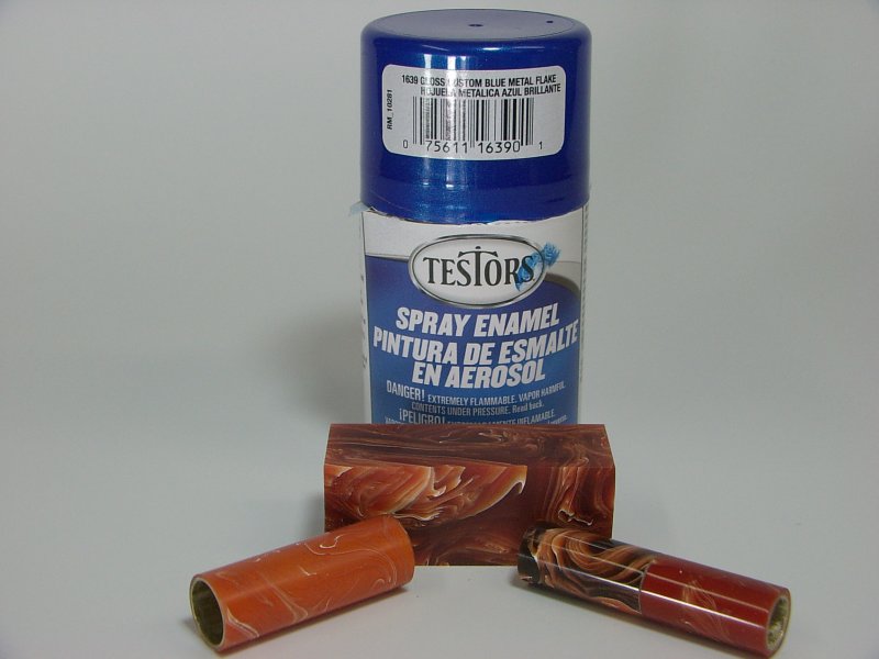

One of the reasons I did want to share this pen was because of the little experimenting I did when selecting a color to back paint the blank. It may help someone in the future. Also the little different touch with the turning of a replacement piece for the clear crystal.
The kit used was a full sized Majestic rollerball Rhodium and Gold. I matched it up with what I believe is some of the nicest material ever made called Mexican Agate. It's light and dark amber bands along with the white streaks running through it make it a stunning blank, I think. The material is somewhat translucent so I reversed painted it with a metallic med blue spray paint. after it was spun it was MM and polished to a high shine. To add a bit of elegance I replaced the clear crystal in the clip with a turned replacement of the same material. I then went on to make a matching letter opener to go with it.

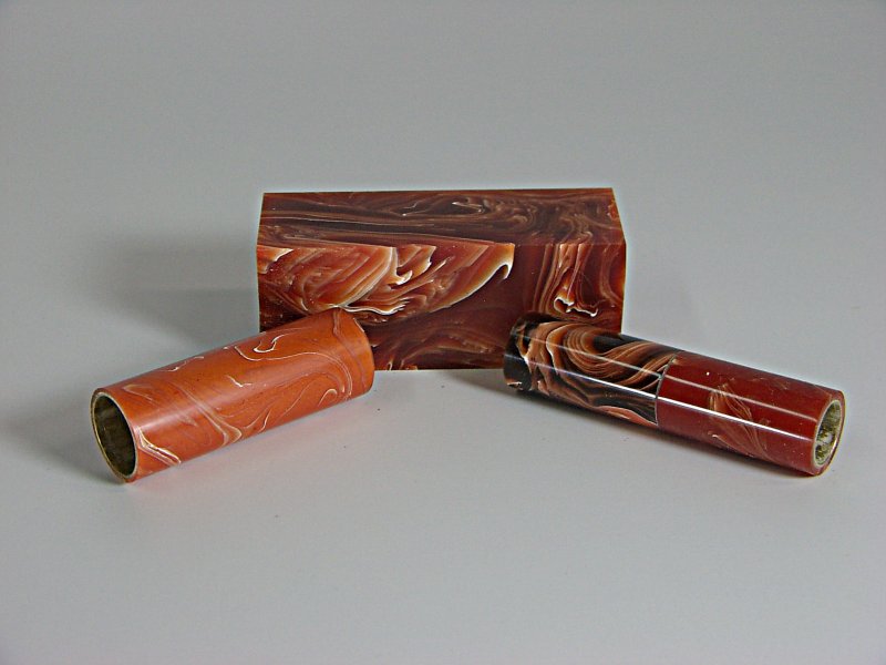

I have included a quick photo of the experimenting I did selecting the color to back paint it. In the photo the blank to the left was back painted a white and to me that washed out all color in the blank. Then on the blank to the right, the lower section was painted with a combination of red and brown paint. More of a muddy brown color. I did not like that look either so on the top right part of the blank is the blue metallic I went with. I should have mentioned I did try red alone but forgot to include the photo and I did not like that look either. Washed out the darker highlights. Hope this may help someone in the future. :smile::smile:

I had no idea that the color for backpainting could have such a big difference on the way the finished pen looks! Those different examples look like completely different blanks.

Yes many translucent pen blanks can be totally affected by the color used for painting inside the blank. There are many examples of this posted throughout the forums. If you need more info on this, I believe Ed from Exotics has a short video explaining the differences and also show a good way to help in choosing.

As I said the main reason I posted this here was because it may help others see that there is a difference in the color you back paint some blanks. When you actually look at this blank you figure there is no way that it was that translucent but here is the proof. :smile::smile:

You could save yourself some time and material if you do what I do to decide what to back paint with. Polish the end of a blank (buffer really helps with this) and then slice off a sliver on the table saw. Now take it and lay it on any painted surface or spray can top until you find one you like the most. Coloured paper works too.
What a study in backpainted color. I don't believe i'd have considered anything in the blue family--and it really paid off for you.
Pete--that's a great idea, i know i've read it before but seeing John's outcome it will be easier to remember i hope!!

JT. If you would indulge me one more question, when you say you sprayed it with medium blue metallic paint. Do you use model paint? Rustoleum?

Here you go.

Pete I do something like that at times. But with this material it changes so rapidly with the different streaks running through it. I had the cutoffs so I just made up the pieces. Got a better look and did not want to mess it up being I was putting on an expensive kit.
