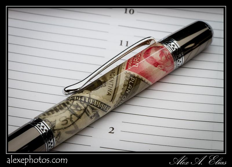

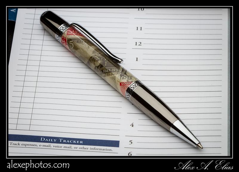

I've seen a few pens with stamps and I wanted to make some for a long while. I bumped into my collection of stamps when I was a kid and made 4 tubes.
I could not wait for the Alumilite order so I did this one with CA. I'll wait for the other 3. I used a lot of CA :)
Thanks for looking .

That looks really nice! I like the way you placed them all.
I made a Zen pen this past weekend the same way...took about 200 coats of ca..so I was wondering if anyone knows of a place that I can send in future decorated tubes to have cast in clear that I can turn down easily?
Thanks for any leads,
Steve

Looks good. Well done. :good:
Why don't you guys just turn down a boring blank to just below nominal size, then fix the stamps and then you just need to put a few CA coats on?
