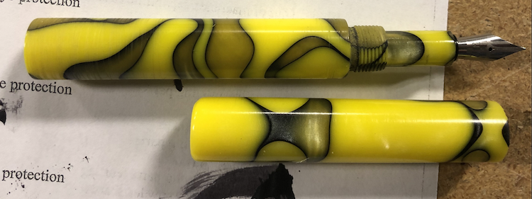

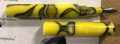

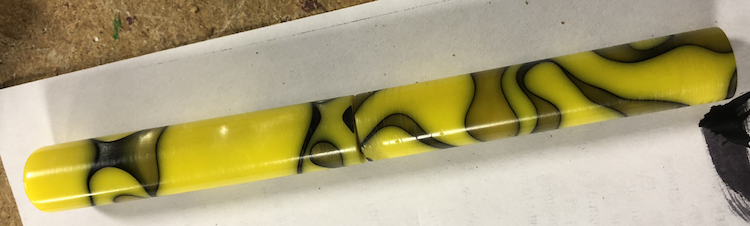

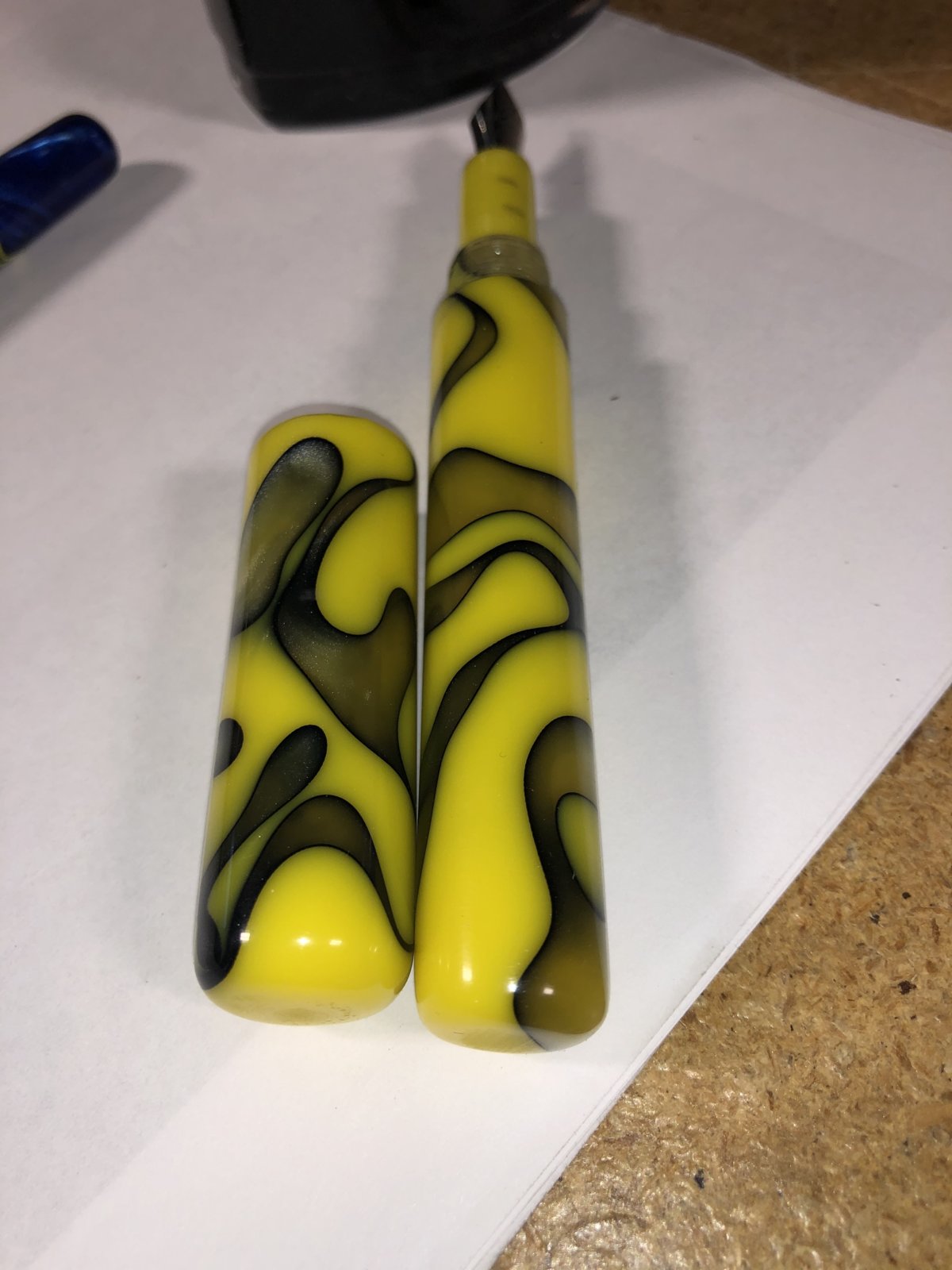

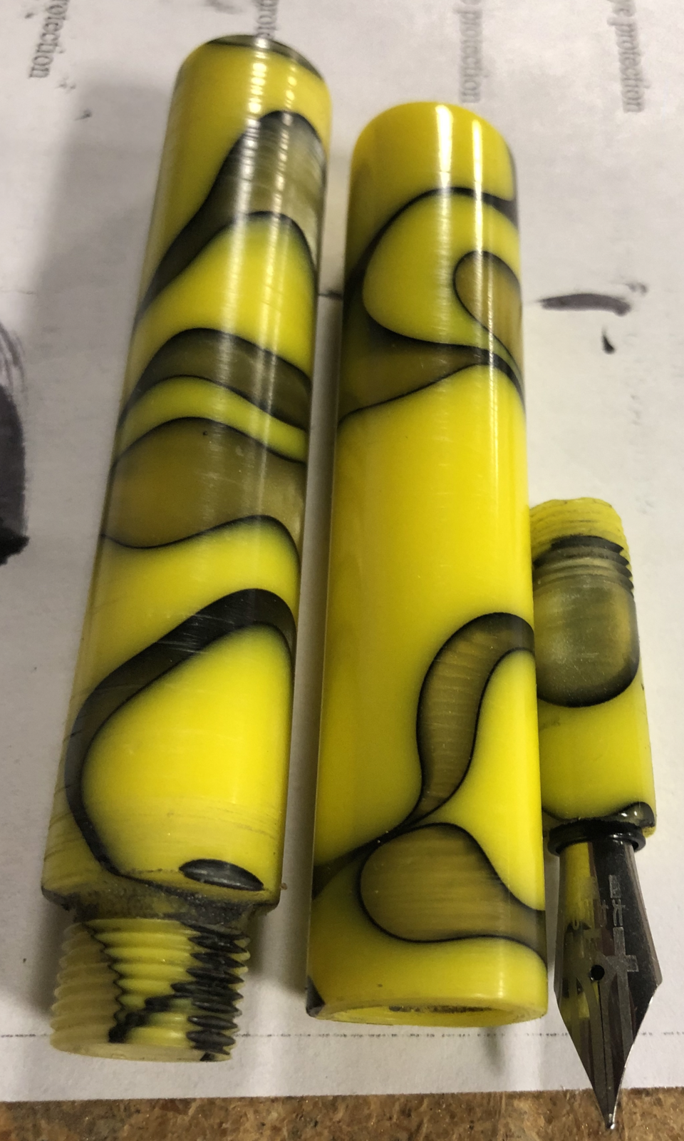

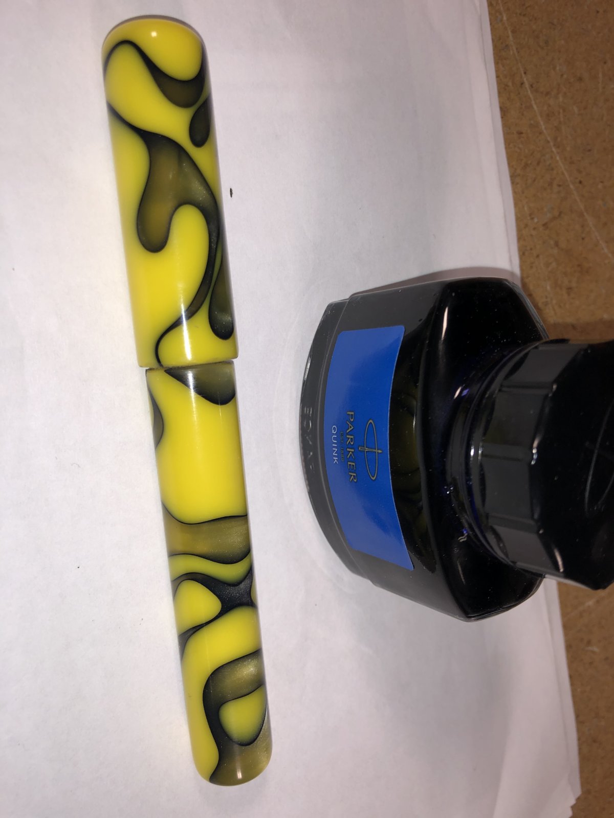

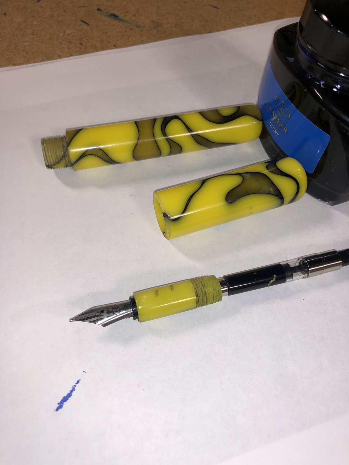

Finishing my 1st kitless pen today. Actually, my 1st pen kitless or otherwise. :-)
I ordered a buffing wheel and will remove the remaining scratches and buff it to a nice shine on Monday.
I used a Bock Fountain Pen Nib- M #5.
I know I need ALOT of work on the details. I should have made the cap about 1/2" shorter.

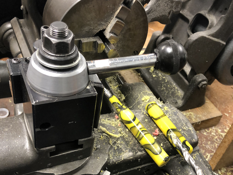

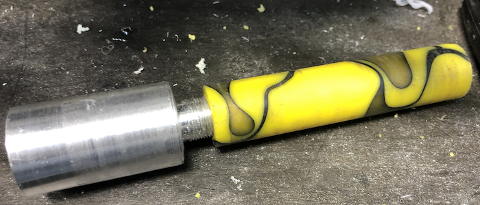

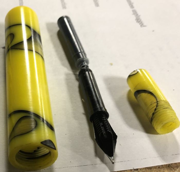

I made my own mandrels as well as thread caps to reinforce the outer threads while tapping the inner threads on the pen section.

I like it. It's orders of magnitude better than my first kitless.
A gentle suggestion, in case it helps: you might aim to make your section thicker, to match the width of the threaded portion. Also, depending on what die you used, you may wish to reduce the number of turns needed to screw on the cap. Just my 2 cents.
Great 1st try! I suspect you're going to need something slightly more aggressive than a buffing wheel to get those tool marks out (I speak from experience). Anyway, impressive start :)

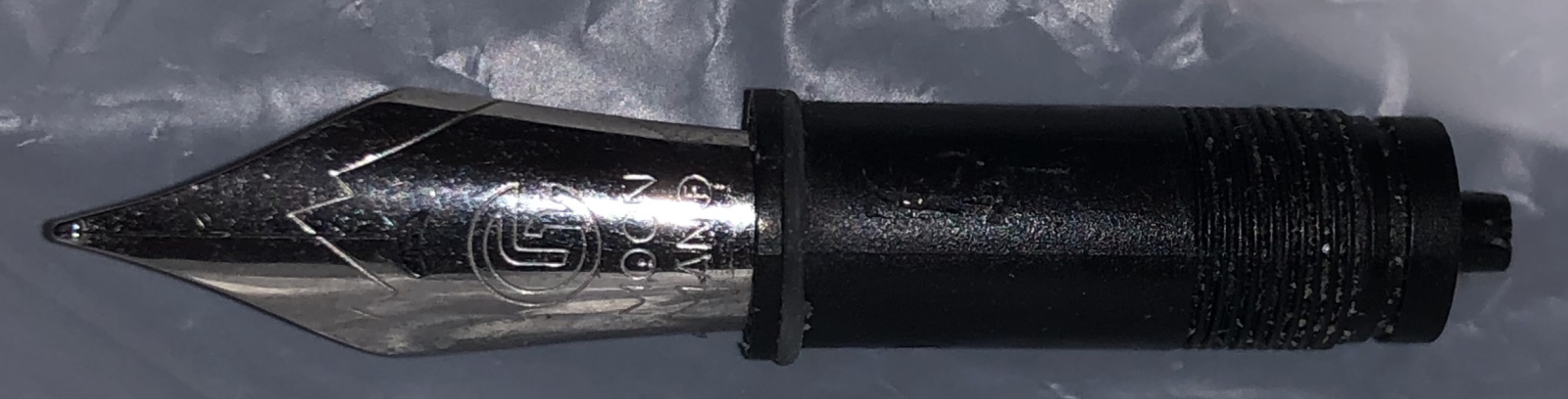

My next step is to figure out what taps I need for Chinese nibs. I got a bunch of these from Aliexpress for $2 a piece.
Hoping I can figure out what tap works with them. While I like the Bock nibs, the pricing is a little high for a hobbist. :)
Greetings,
Good luck going down the kitless rabbit hole. It's a lot of fun.
I like your South Bend lathe.
Figuring out thread sizes is easy with a mic and sets of metric and inch thread gages.
I find for some of the #5 nibs that a 1/4 -50 works perfectly. I found mine on eBay.
