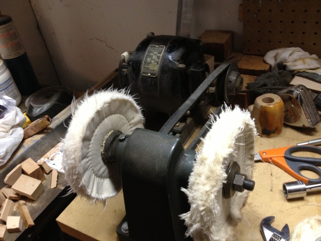

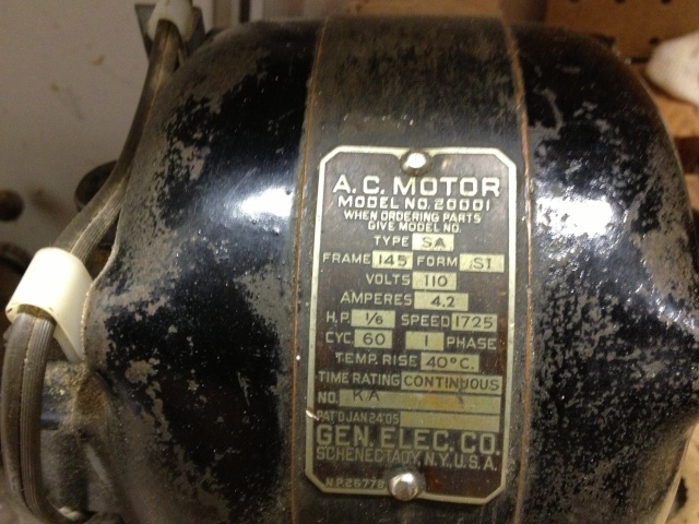

One thing I'm glad I have is my father's old bench grinder. I took the stones off and put on buffing wheels. Its a 1760 rpm motor on it so its perfect for buffing the pipes. That thing was around my whole life. I'm 51 years old now just to give you an idea. It still runs perfectly.
