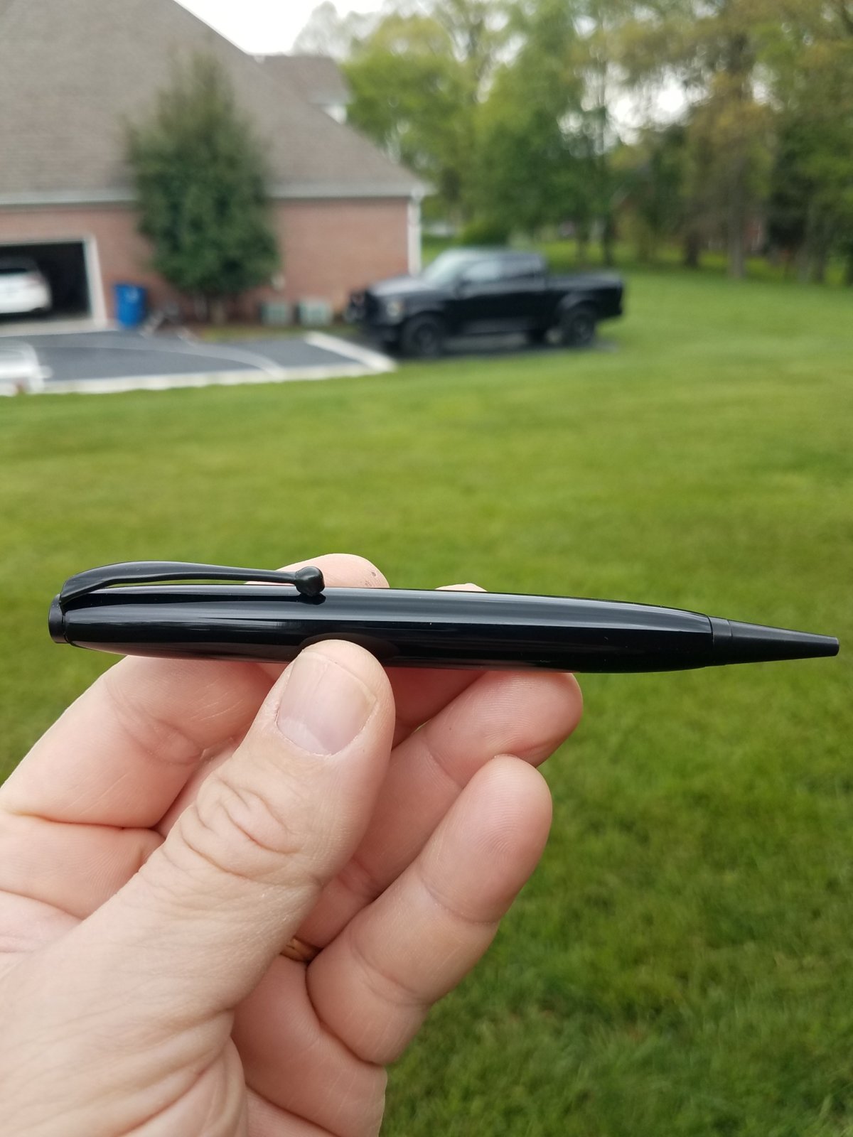

Funny where inspiration can come from. I was mowing my lawn and noticed my neighbor's son had a "Murdered Out" (Blacked out Truck). I'm not a big fan of this style on a vehicle, but thought it might look good on a pen. It's a "modified" (no center band) black enamel PSI Comfort and a solid black acrylic blank. Obviously, not a whole lot of design consideration in this one! 😄

I'm curious as to how you eliminated the center band, since the twist mechanism is put into the lower tube.
Jim:
The lower tube is not glued into the blank. The tip and twist mechanism are pressed into the lower tube as normal. To operate, hold the tip and twist the pen. When replacing refills, pull out on the tip and the tip, tube, and refill come out. This can be done with Slimlines also. This was my first attempt doing this.

I did a Stratus pen like that for my next door neighbors. .
He drives a totally black truck. . His wife drives a totally black SUV, and she wears nothing but black, so now she has a pen to match !!
I used an AA Solid Black blank.
Look in the library for an article on one piece slimlines. I have two there (one on the pen itself and another on improvements) and there are probably others. I rarely use the center bands on slimlines. There are so many designs one can make without them. Ican send the one piece article to you if you want.
