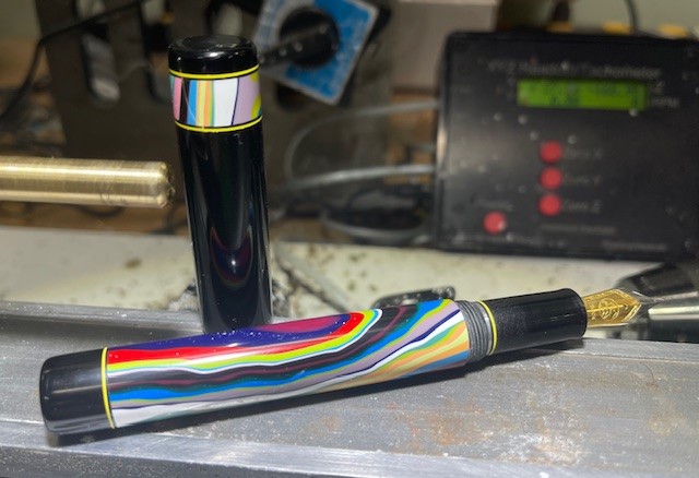

I have a hypothetical pen, it has a hybrid body (wood and urethane), ebonite section and finials. The cap is ebonite and urethane/wood accent. There are also metal accent bands. Layout is like the sample photo just with wood/urethane hybrid instead of the boatite, assume metal where the thin yellow bands are.
How would you suggest finishing it with all the different materials??
Nice looking pen Frank. I interested in all the feedback you get.

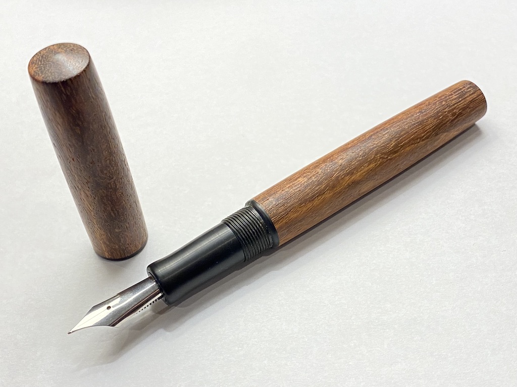

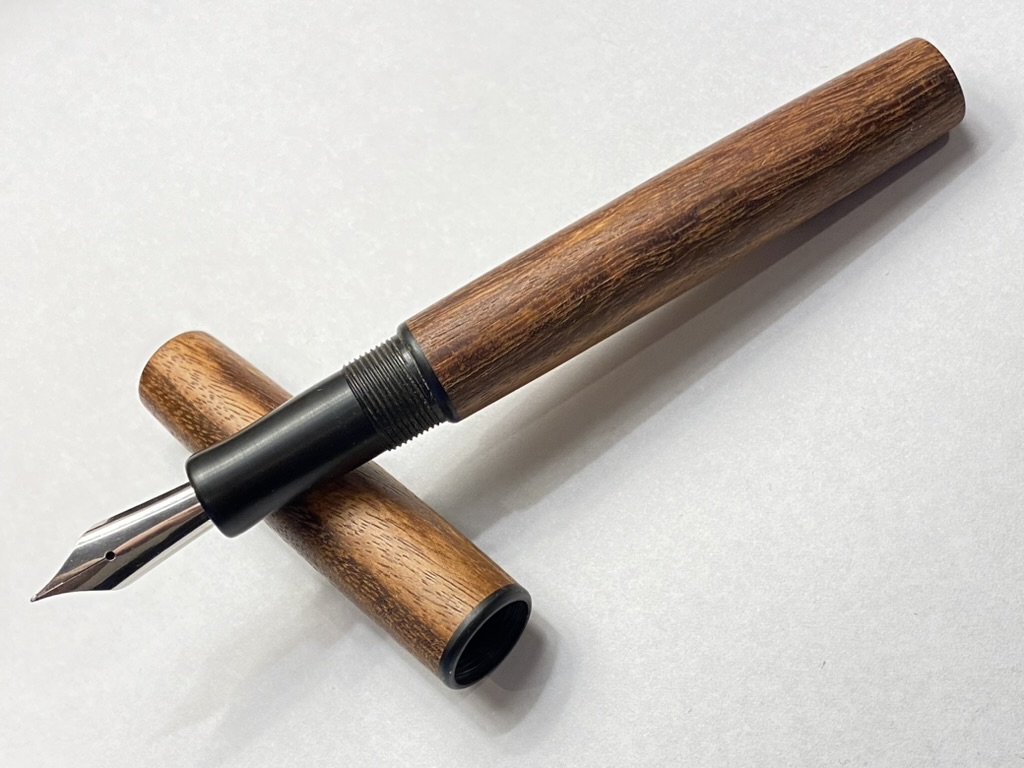

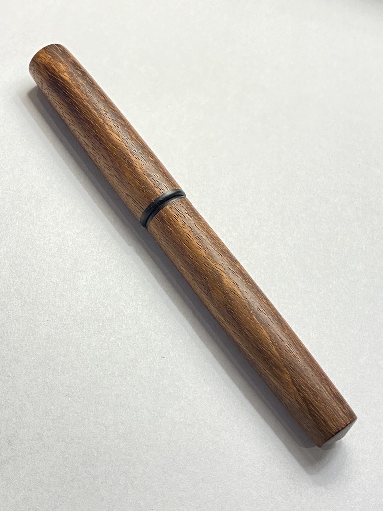

I made a pen where the barrel and cap were wood, lined with black ebonite including small accent rings at the mating ends and an ebonite section. In my case, the wood was Goncalo Alves (Tigerwood) and is quite hard so I sanded everything to 800 and left the wood natural and the ebonite matte. I really like how it turned out and I have used it quite a bit. Over the past year, the wood has darkened a little. Below are a couple pictures from right after I completed it.
This worked for me, but I think the species of wood will dictate if it is advisable to leave it natural without finish.
I think this would work for wood and hybrids, if you like matte finish, which I do, even on alumilite/acrylics. I don't know about the metal accent bands, I think that brass would tarnish and aluminum would oxidize over time.
