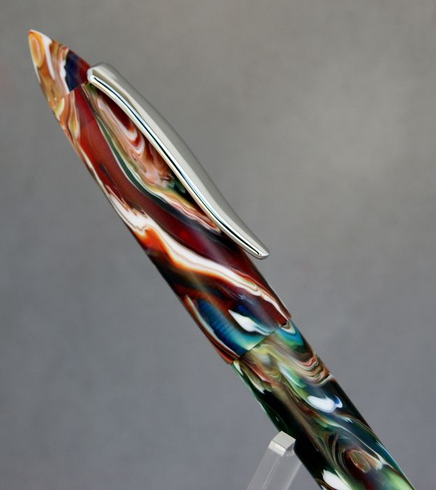

Here are some call blanks I just finished.
I mix the colors with part A before putting A and B together. I made a tricolor blank set in PVC back in March, it worked out because it was cooler in my shop giving me more set time. Turntex advises that it is OK to induce cooling during hot months. BTW my tricolors were, purple, pink, and the white Alumilite... so really it was just 2 colors and a third stir and pour.
Nice bunch of casts mate, well done...!
Interestingly, out of the "few" Resifills (my name for wood and PR resin casts) I made over the years, the mix on your blank far to the right, is very identical to one I done a couple of weeks ago with some Truffle wood, and done without thinking how it could come up, I just think of 2 colours and mix but, the "camouflage" look was something that I never did before, I was a little surprised when I sprayed the blanks with varnish for colour enhancement, all the colours together, turn out the camouflage look I'm talking about, and now listed on my eBay store (have a look)...!
One of the joys of casting the way I do, I target for NOT to make the same mix twice, that's what I like most about it, you get more "surprises" that way...!
