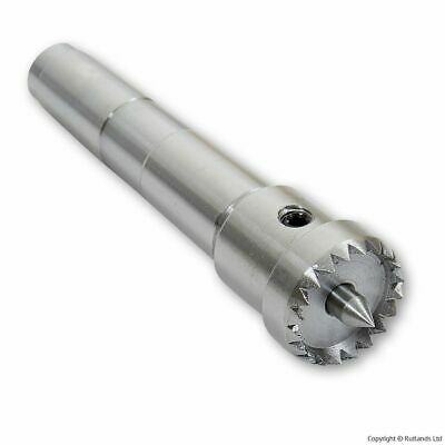

I've started turning Niles bottle stoppers and run into a small problem. My current drive center leave's cut on the edges of the stopper blank as I'm using a PSI bottle stopper mandrel and the drive center is used for table leg making. I'm going to buy a Niles mandrel tonight but that doesn't fix the problem with the drive center. Does anyone know who might sell a drive center that has a much smaller footprint on the base of the blank? I've looked at PSI and all they have is for a MT#2. My big lathe, probably 40+year old, is a MT#1. Any help is greatly appreciated. I will also mention at this time Ruth has been a big help in getting this all started and her site is great. Heck, she even gives you the tags for the bottle stoppers for the ones you buy. I'll continue to purchase her stoppers, great lady!

Can you get STEB centres over there ? the do them in Mt 1 and 2 over here. Robert sorb6 patented the idea but they're now also marketed as crown centres as out of patent. I see on ebay international you can get them.

Thanks for the information Ian. That would work as Ruth's stoppers are wider thank 1/2 and inch (SAE). I'll see what I can find here in the states and if that doesn't work, then I'll follow this. Thanks again for your help.
